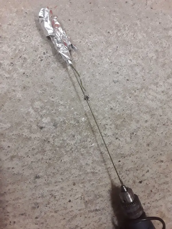

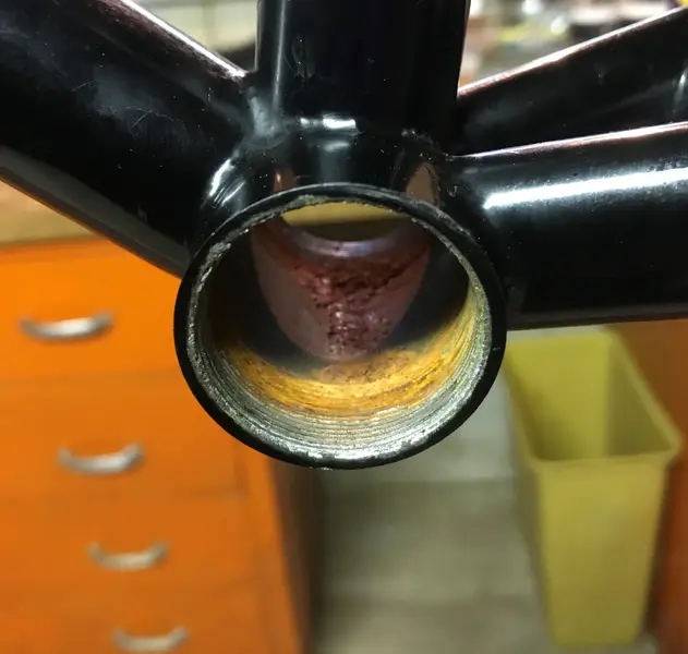

Totally serious about the tinfoiling. Here you go.
Take a steel coat hanger and straighten in out. Put a tight bend in one end to help hold in in the drill chuck and a looser bend at the other to take a folded bit of tin foil.
Put the tinfoil in half way across and roll it round the hanger tight enough to go in frame.
Once in, set the drill to spinning and move up and down.
If the foil gets too compacted or smooths itself, reverse the direction.
Da da ....clean tubes. Especially good for crusty seatpost and bottom brackets.

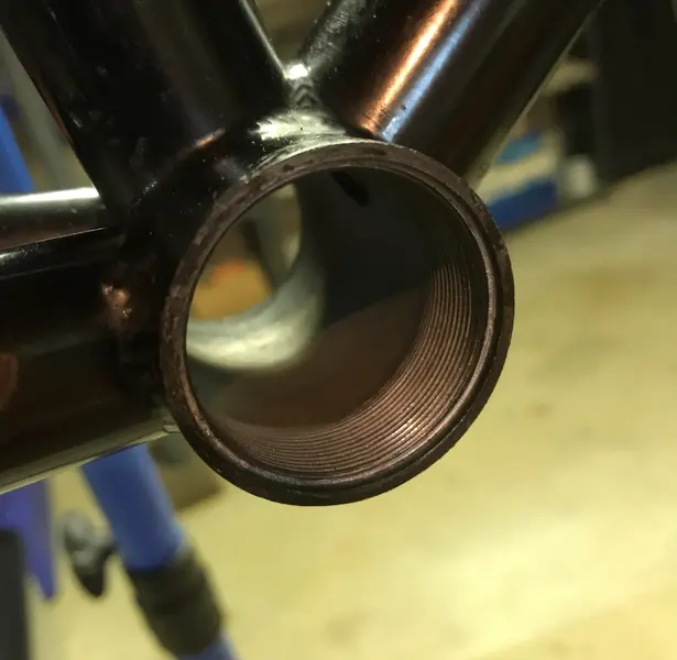

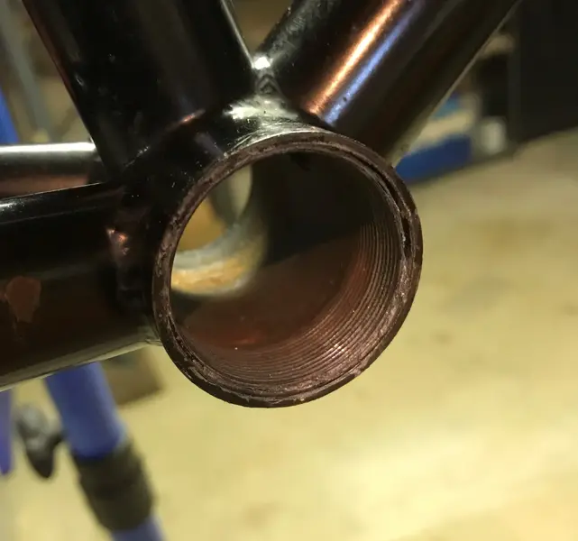

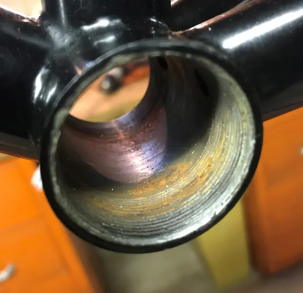

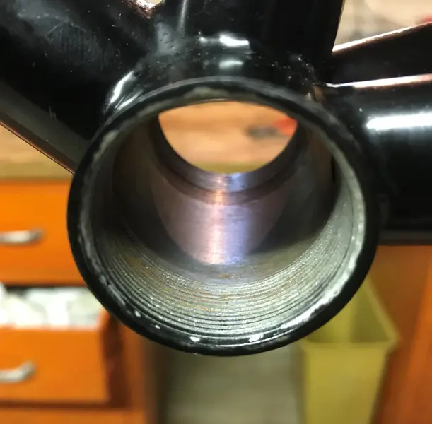

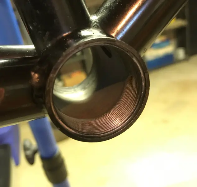

Huge success. Recommended! Thanks! This is after four passes (new foil each time). Granted, this BB wasn't that bad to begin with. Still, impressive. (Tried to order these in correct sequence. The last one is what the foil looked like when it came out of my seat tube.)
