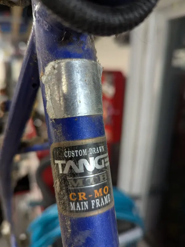

Once home, I started giving the Mongoose a closer look and noticed a faint, silver sticker. With the right lighting, it read “Bugaboo Bicycles”. This old bike was likely sitting in the same bike shop as the one I had 30 years ago. And, this newly picked bike is an 18” frame which is perfect size for me now. With that, I was thrilled and started carefully tearing it down.
Faint bike shop sticker:

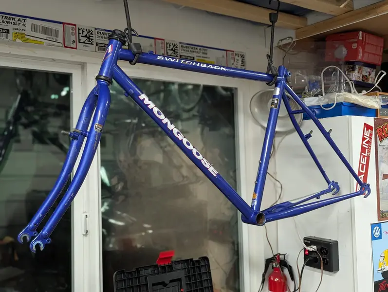

More improvements!
The frameset is cleaned up and nearly ready for parts. It has some definite wear and patina; however, free of any dents or serious issues.

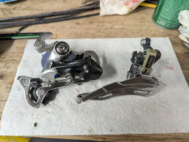

Worked this afternoon on completing the rebuild of the Switchback. Everything has been dismantled, cleaned, regreased and reinstalled. Overall, I was able to reuse most of the original parts and am very happy with that.
The 2nd bike I picked up with the Mongoose became a donor. From that, I salvaged the crankset (identical to the original but in much better shape), pedals (bearings were smooth and serviceable) and the cartridge bottom bracket (the original cone & cup was rusted a bit and I have the tools for the new one).
Picking through spare parts in the garage, I had the tires, tubes, saddle, 3 of the 4 cables and misc. small parts like cable ends.
The only things purchased for the rebuild were a brake cable, chain, grips, brake shoes, & truing the wheelset. In all, the rebuild cost $85. Money well spent to experience my childhood bicycle with more appreciation!!!
