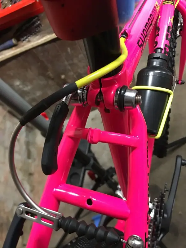

New retro-style bottle, little bit of heat shrink protection for the gear cables & to help prevent frame slapping marks.
Some heat shrink over the V-brake noodles, not just cosmetic, but to help with water ingress.

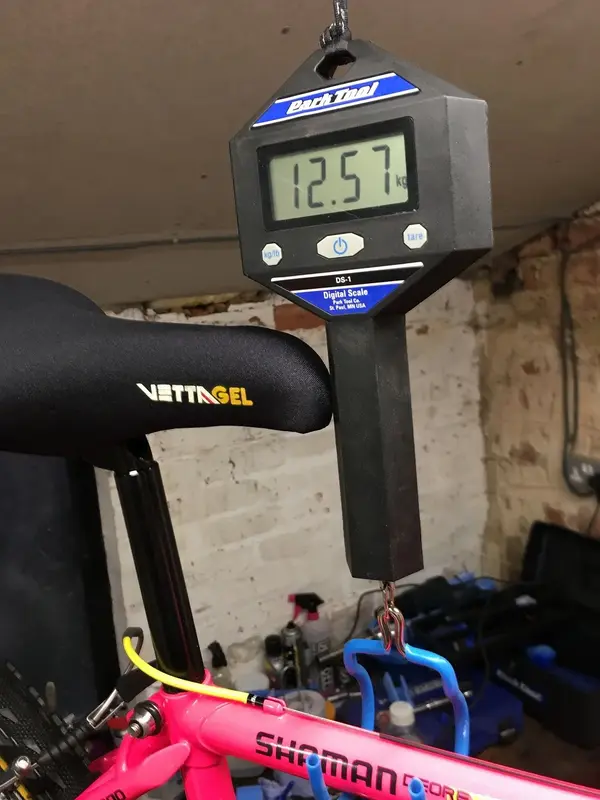

And final weigh-in at 12.57Kg or just over 27 & ¼ lb (I think) Heavy by modern standards of course but still over 5lb lighter than the original 32 & ½ lb

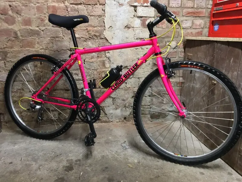

Spec sheet.......
1991 Claud Butler Shaman Deore LX
Frame: Reynolds 501 Magnum (oversize) tubing, vertical dropouts
Fork: Cromoly Unicrown, R600 oversize column
Headset: Shimano Deore LX HP M-564 1-1/8”
Stem: ZOOM original, 120mm reach, 1 1/8” Steel, Black
Handlebar: ZOOM Lenker flat bar 25.4 x 570mm, Aluminium, Black
Grips: SRAM/Gripshift
Brakes: Shimano Deore LX M-570 V-brake
Brake Pads: Jagwire 70mm Yellow linear V-brake JBS007
Brake Cables: Jagwire stainless steel
Brake Levers: Shimano LX M-570 V-brake
Shifters: SRAM/Gripshift SRT600-3x7
Front Derailleur: Shimano Deore LX FD-M550
Rear Derailleur: Shimano Deore LX RD-M550
Derailleur Cables: Jagwire CEX stainless steel
Cassette:Shimano 7-speed Hyperglide CS-HG70, 11-13-15-18-21-24-28
Chain: SRAM PC-830 Power Chain
Cranks: Shimano Deore LX FC-M550
Chainrings: Shimano SG. C-46 C-38 C-26
Bottom Bracket: Shimano Deore LX UN55 68-122mm Square Taper
Pedals: Shimano Deore LX PD-M550 Feb‘93
Hub Skewers: Shimano Deore LX Quick Release
Rims: Wolber AT18 alloy
Hubs: Shimano Deore LX M-550
Nipples: Sapim Brass-Chrome plated
Spokes: Sapim Stainless Steel
Tyres: Panaracer MACH SS 1:95
Saddle: Vetta Turbo GEL
Seatpost: Kalloy 26.8 x 350mm micro-adjust Black Alluminium
Seatpost Binder: Kalloy quick release
Weight: 12.57KG / 27 ¼ lbs
Final photo of the evening;
