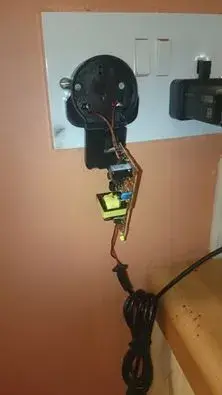

yeh yeh I should know better, but just a little warning. my charger just blew up :shock: a loud bang from the kitchen the circuit board is burnt out, the cover ended up in dogs bowl 3 meters away and its only the 2nd time I've charged them.

going to have the sparky at work have a look, I think the lights themselves are ok but not the charger. anyone know if there is a uk supplier for chargers?

Sort of lol, been stung myself with a solarstorm from a UK seller, until i got a message before it'd been sent, UK stock hk seller! Battery wasn't charging looked closer, they'd sent a 4.2v charger, anyway they're going to send a 8.4v but got to wait a month for it to come, but candbseen stock them, so going to buy one of them.

I'll just say I've had similar experience with brand stuff at work with these generic style of chargers. They're all the same no matter what they come with.
The charger tops rip off, they stop working properly, etc...
Unfortunately its not just cheap Chinese eBay light. It is everything now.

Voltage needed will depend on the battery setup, which will be based on the led configuration in the unit.

Knowing what I do about li-ion and li-po (taught to me by an electrical design engineer and test guy who builds li-ion and li-po chargers for the MOD) the batteries only go bang because of charger failure.
Chargers must pulse at a certain voltage for a certain period of time and then stop. During the pulse due to battery chemistry a crystal structure start to grow from the negative side of the battery towards the positive and if continuous charging happens it eventually joins the two halves in an internal short causing thermal runaway and explosion/fire. When the charging pulse stops the crystal dissolves back into the battery chemistry so charging can start again.
I had thought about investing in a high quality charger for my batteries, but for now I will charge them in an RC lipo charge bag.
