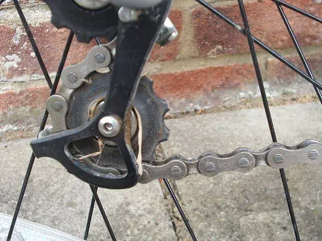

Here's my chain after yesterday's dry and dusty 30 mile off-road jaunt.The Prolink chain lube has stoped the build up of dust on the chain. The strange thing with Prolink is that the chain looks like there's no lube on it. However, to the touch it feels slippy and oily. It's like it has a dry non-stick coating.
There will be some dust and grit inbetween the links but the following will sort this out:
*dusting the chain by spinning it past a soft toothbrush
*reaplication of Prolink followed by spinning to flush dust and grit out
*wipe Prolink/dust mixture off with a rag
*final applicatuon of prolink (you will need to let this dry before using the bike or dust will stick to the wet lube)
