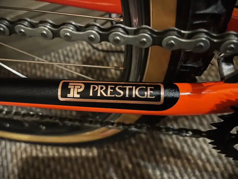

I can see some details and room for improvement already, and I think only time will allow for them..., but looking at this thread I think 6 years is long enough for now. thumbnail_IMG_5760.webp

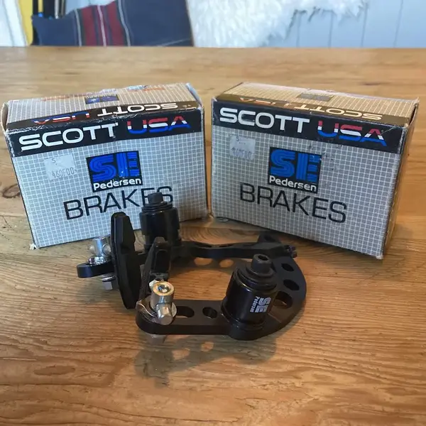

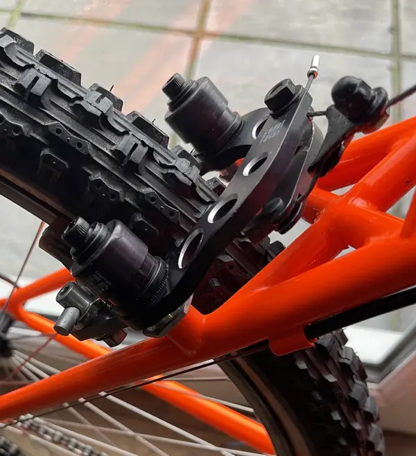

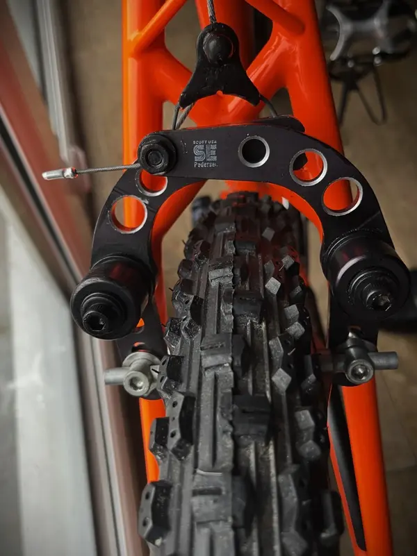

Love that rear brake Carl. I have a couple to fit on a build. Are they easy enough to set-up?
Hey Adrian, I wish I had known, this was toast really, I couldn't find another anywhere, so fettled this one as best as I could, but I think out of the box they are easy enough, i really like Self Energizing brakes, with a four finger lever, 2mm cable and Winwood Pads and an the X-Brace on this, they are deadly.
Those Winwood pads aren't easy to find now, are they? I got lucky with the brakes a few years ago
Probably a good job I didn't know you had them, I would have tried to deal.
God they look lovely.
The Winwood pads are great as long as any anodized surface has been bedded in, until then they can be a little scary, thankfully the rims used for this had been used previously, but scoring the brake pad surface will help.
I think the SE brake was a good choice for this build, Suntour had the Roller cam, but there wasn't enough clearance to fit anyway.
The Scott Penderson brake seemed like a good choice, it was black and fitted and i think the following year Suntour did the the Deal to License the design to use in there groupset, and it was available here at the time.
