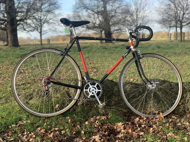

I have been riding my Dad's old Carlton Lightweight until very recently when it started to make some pretty nasty mechanical clicks / pops and was chain slipping heavily, it took it into a trusted bike shop for a deep service and they phoned back with news that it was pretty much knackered - a slightly bent frame and needed new bottom bracket, rear derailleur, cassette etc etc.
I collected and looked it over and can't see the bend in frame but realised heavy rear wheel wobble and slight crankset wobble. I've been weighing up whether to let it go or not. As I love this thing with all my heart I wanted to find out whether restoring myself could be an option, I have zero experience in restoring bikes but fairly confident I have the ability.... famous last words.... I want to give it everything I've got to bring it back to life!
If anybody has insight as to specialised tools I'd need / knowledge of these wonderful old bikes / best place for parts / part sizes etc etc I'd be eternally grateful. I realise if the frame is bent it probably won't be worth embarking on the project but I'm really struggling to see!

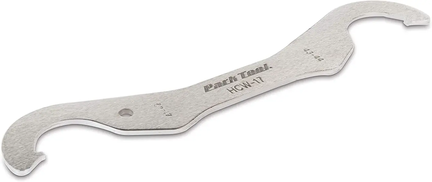

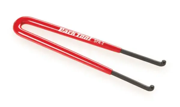

Your bottom bracket is an old cottered type with loose balls (sometimes held in a small cage). To adjust the bottom bracket you'll need a lockring tool (sometimes called a C spanner or hook wrench) to loosen the lock ring on the non drive side. The inner part of the cup usually has a set of pin holes to put a pin spanner in or sometimes a pair of slots that you can use a broad screwdriver to tighten the inner part. Tighten it in and tighten the lockring and it'll take out all the play. It takes a bit of practice to get it just right. You can dismantle it completely and replace the balls and grease. You can buy new balls for it but I forget which size they are usually. Normal white grease is fine. Look up how to get cotter pins in and out; you'll need a hammer, a small spanner and a short length of stout pipe.

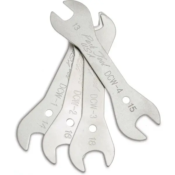

The bearings in the wheels are the same - loose balls and cones. You'll need a cone spanner which is a very thin spanner, but you'll need to measure what size it is. Again, it just adjusts up until the play goes. As with the bottom bracket, you can take it apart and replace the balls and grease. Balls are smaller and you can also get them in most places. The wheel might also be out of true. You can adjust that by tightening spokes. You'll need a spoke wrench for that but it takes a lot of practice to get it right so it might be worth finding someone who can already do it.

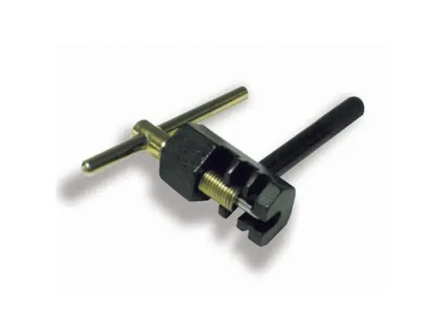

Chain jumping is usually a worn chain, worn cassette, knackered ratchet in the freewheel or a combination of all. Just replace the cassette and chain. Yours is almost certainly a screw-on freewheel type cassette. Have a close look at what one it is because it takes a particular removal tool to get it off. Replace it like for like, you should be able to find another one. If not, you can just get another brand as they're all the same thread, just bear in mind the other brand will need another removal tool later. Ask me how I know that, I think I have about six removal tools! You'll need a chain breaking tool to do the chain

Re tool sizes, your cones are probably 14mm (9/16" but 14mm fits) but stick a caliper on them if you can and don't forget you'll need a spanner for the nut on the end. Lockring tools are all the same size. Spoke wrenches are often a triangle shape with 3 sizes on the same tool but as I said you might not want to tackle spoke adjustments until you're a bit more experienced. You can get all these tools in Halfords and they'll be more than happy to let you take your bike in and try them out if you buy them there.

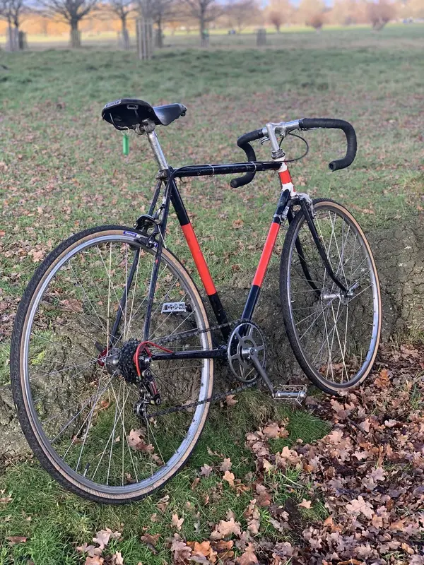

You should have asked the bike shop to be more specific about what part of the frame was 'bent'. If you can't actually see a bend, chances are they were using the word 'bent' loosely, and what they meant was 'misaligned'.
A frame can become misaligned in many different ways: The forks can become twisted, or misaligned frontwards, backwards or sideways in relation to the steering column.
The main triangle can become twisted- the head tube out of alignment with the seat tube.
The rear triangle can be misaligned to one side in relation to the main triangle.
Your photo suggests to me that the drive side handlebar drop is bent inwards. An impact that has done that might be expected to have twisted the main triangle of the frame too.
At any rate, both to make a proper inspection of the frame and to get realigned anything that is out of alignment, you really need to strip the frame of all its components. To do that, the only bits that should need the specialised tools listed by Jonny69 are the headset and the bottom bracket. I haven't dealt with cotter pins since 1975, but it's pretty much a spanner 'n' hammer job with bearing-friendly support. You'd need to split the chain too.
