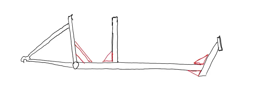

if you are going to keep it and not just replace the main spar then I'd go with gussets as shown below in red for starters. this will help with the bending and snapping in half. you really need something at the headtube, but it's to short to add anything.
these should be wrap around and boxed in not just flat plate.
the join, I'd fabricate or find a section that slips inside of the box section (you will have to grind out the internal seam). Weld it one side. I'd do a decent, thick flange instead of the bits of angle iron too.
I'd personally go buy a new chunk of 3" box and start again, but if you don't want to go down that route, fair enough. you do need to cut out the BB and the head tube welds and redo them properly. I'd want to do the "downtube" to main spar weld too (not to mention the steering column).
see why I think you need to nearly start again? :)
