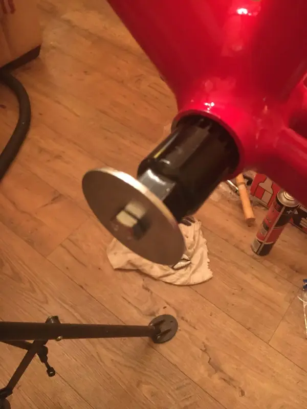

Well this old chestnut strikes me again. I recall 24 years ago having an alloy Orange EVO 2 frame will a similar issue, it took me holding the frame down and a fit strong Italian steed of a man (my mate) to break the BB free with a five foot scaffolding pole on the end of the tool (both sides). I don't want to use heat to waste the paint, however thermal dynamics state it only takes 30c to expand alloy, therefore if I bathed the frame in really hot "just boiled water" it may be enough, or ideally I could do with am impact gun. I have tried levering both sides with a 2.5 foot pole, there is no budging.

Are you sure you are turning the BB the correct directions?

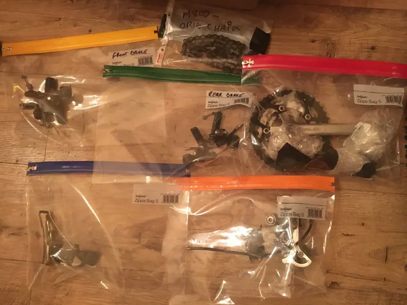

All components are off and zipped bagged apart from this BB. Am contemplating my next move over a beer.

Ok for people trying this at home, I tried the bucket of water (boiling) and dipping in the Bottom Bracket area and let it sit for ages, then try to remove it, all I did was scold me fingers. 😝 - I did not think that would work, I basically don't have enough leverage. Am keeping the M8 bolt holding the tool on to stop it slipping, I need an extra person like the Orange EVO 2 removal.

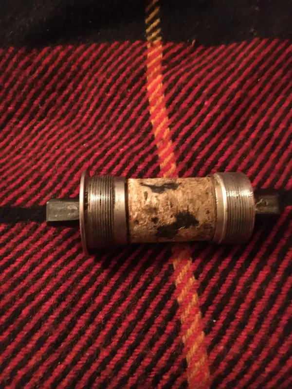

Well after a little swearing and cursing, its out. Its looks so dry, as if it was fitted dry back in 1993/1994. The bearings are fine in the cartridge, but I wanted it serviced and out for a new cartridge. This time it will get greased, threads are all good in the BB.
