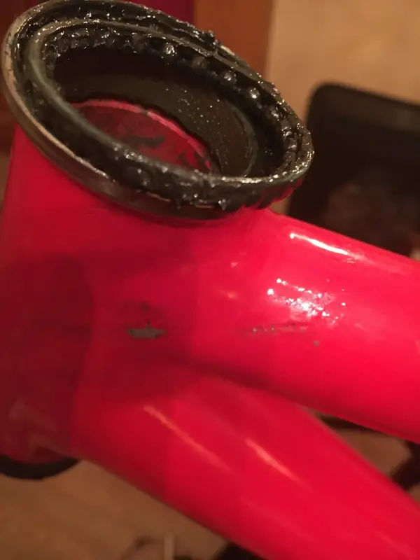

A trip to Halfords! £39.00 later for a few bits of flakey paint, I must be off my head. Then plus £10.00 for the small coded touch up bottle.
Frame and Forks needs a good clean first however, no rush maybe next week one evening. (So does my living room with all this going on)

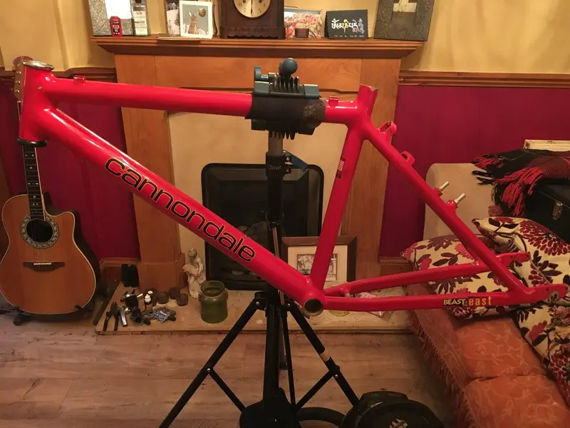

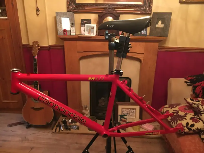

I think it’s not good practice to clamp from these thin walled aluminum tubes. I prefer clamping from seatpost, or seat tube with a dummy post inside. Just my 50 eurocents.
Very good point @Vesatoro - the clamp has always been barley tight with an old sock in between, almost just resting on the clamp. When I removed the Bottom Bracket Cartridge the frame was upside down in a jig with all the force going into the frames triangle and not removed on the stand in that position. Anyway, point taken I have fired the old seat post back in and will work on that via the clamp rather the top tube. Thanks for the heads up, am too late down the road now to crush my own top tube by accident.

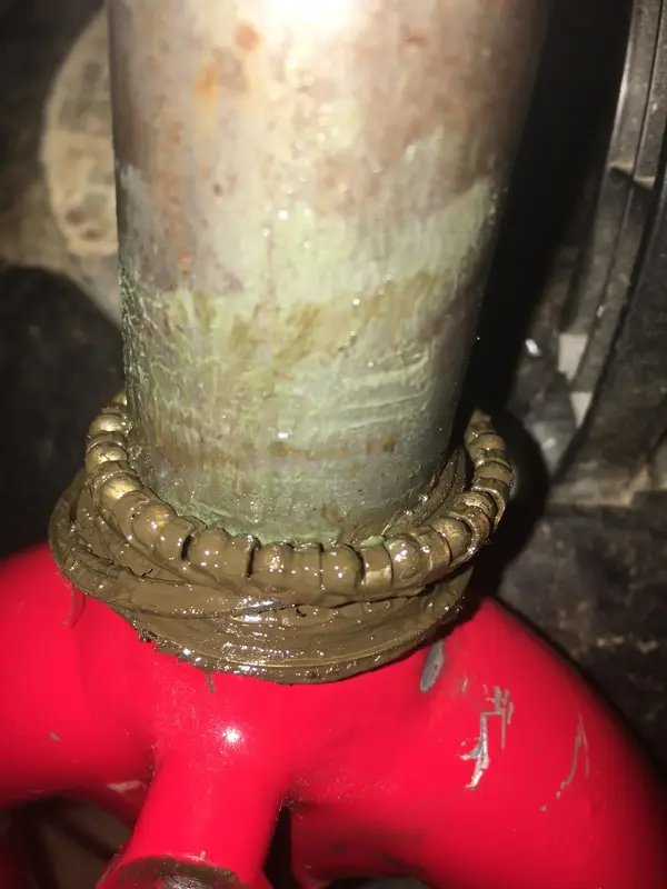

Nope, not for sure. But I guess they might be 5/32 if there are 24 of them (by googling) https://www.ebay.co.uk/itm/204467710559 .

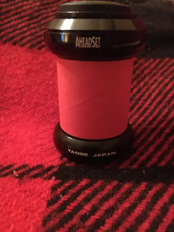

@Vesatoro I have ordered a Tange Japan "Cane Creek" 1 1/4" AheadSet as a back up, it was a reasonable price and 1 1/4" are so hard to find. However I want to keep the Dia-Compe EVO set and see how that goes, so my plan is to keep the current races, clean it all and order 5/32 loose Ceramic Si3N4 Highest Quality Ball Bearings at Grade 5 and just replace the bearings and see how that goes. I thought about ditching the races and just using loose bearings however some headsets do not like the races missing apparently. (I will order enough loose ceramic bearings to fit in the races or to fill the cups without the races - then take it from there)

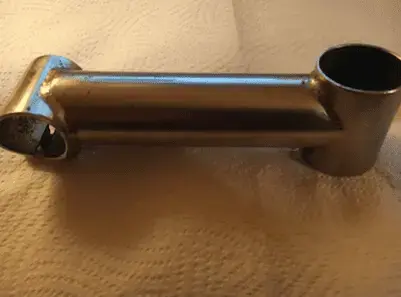

I have taken the 1 1/4" Nickel Plated stem to my partners this week while am staying over, the suggestion was they could polish it while watching some Netflix - its coming on well. "Keep Going" 🤪

The new Tange 1 1/4" AheadSet arrived last week, I am tempted to fit this however keep the original Dia-Compe "just in case" - The Tange one just looks new and fresh. (I fitted a new 1" Chris King Black Sotto Voce to my Cannondale Saeco when I did that build in 2019/2020, 1 1/4" new King headsets are no-where, or I would be tempted)
