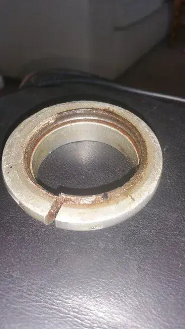

Ive got the frame stripped - wondering about polishing it and laquering - but, more immediate issues...
the headset cups - ones foobard it sems...and im struggling on a replacement...cant see anything on qwerty cycles... i think these are fatty ones?
ive attached a piccy - does anyone know what/where i can get one of these?
thanks again for helping get this back on the road!!
