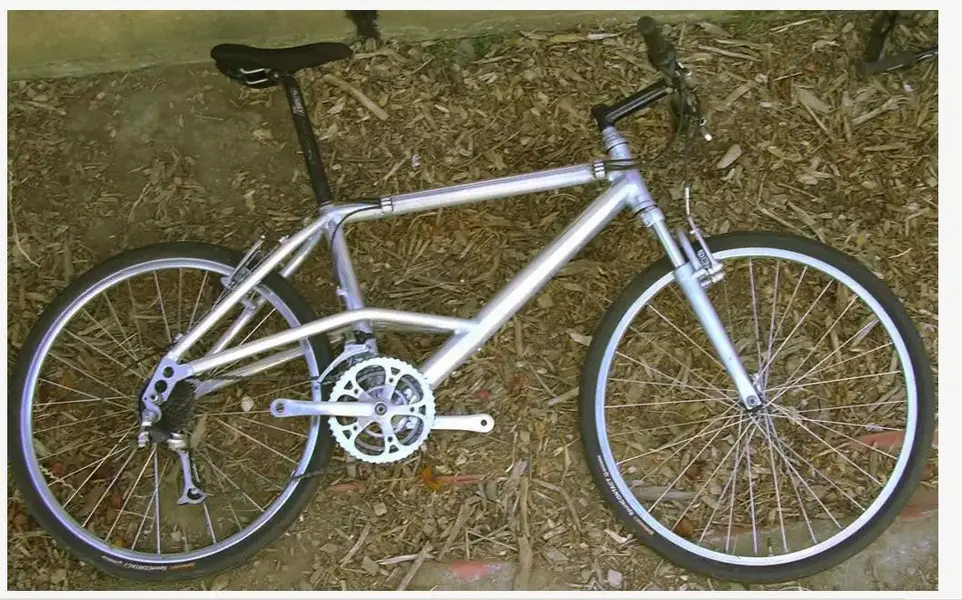

I have been using my old Funk as a road bike for years-works great and I get strange looks and comments from roadies.

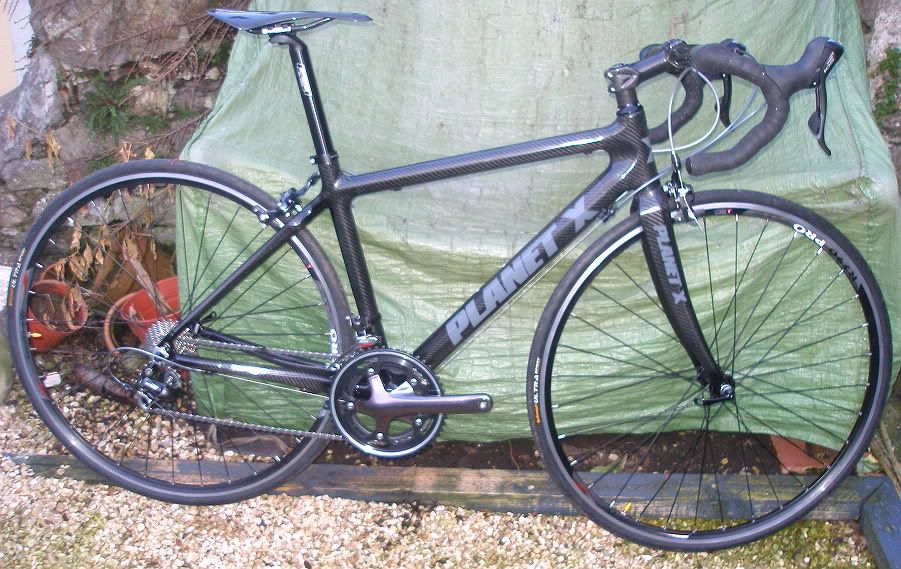

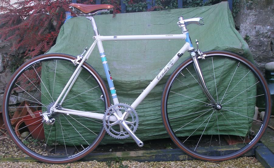

I'm the same height and a little T-Rex in proportions so I do have to ride a 'small' in most manufacturers frames but I can get a good position. There are plenty of frames out there with shorter top tubes than 54cm traditional and compact.
Planet X bikes fit me really well and seem to have a high front end which helps, Condor frames come in a 52cm square frame which also fits me well and I've always loved DeRosa frames, their a little more racy with a lower front end but really compact with short top tubes :wink:
The DeRosa is set up as I rode it, the Planet X had only just been built up so the seatpost is probably too high but the contact points are much shorter than I could get with 99% of MTB frames.
Their all sold now but the DeRosa in particular was very short in the top tube, I think it was about 51cm.
