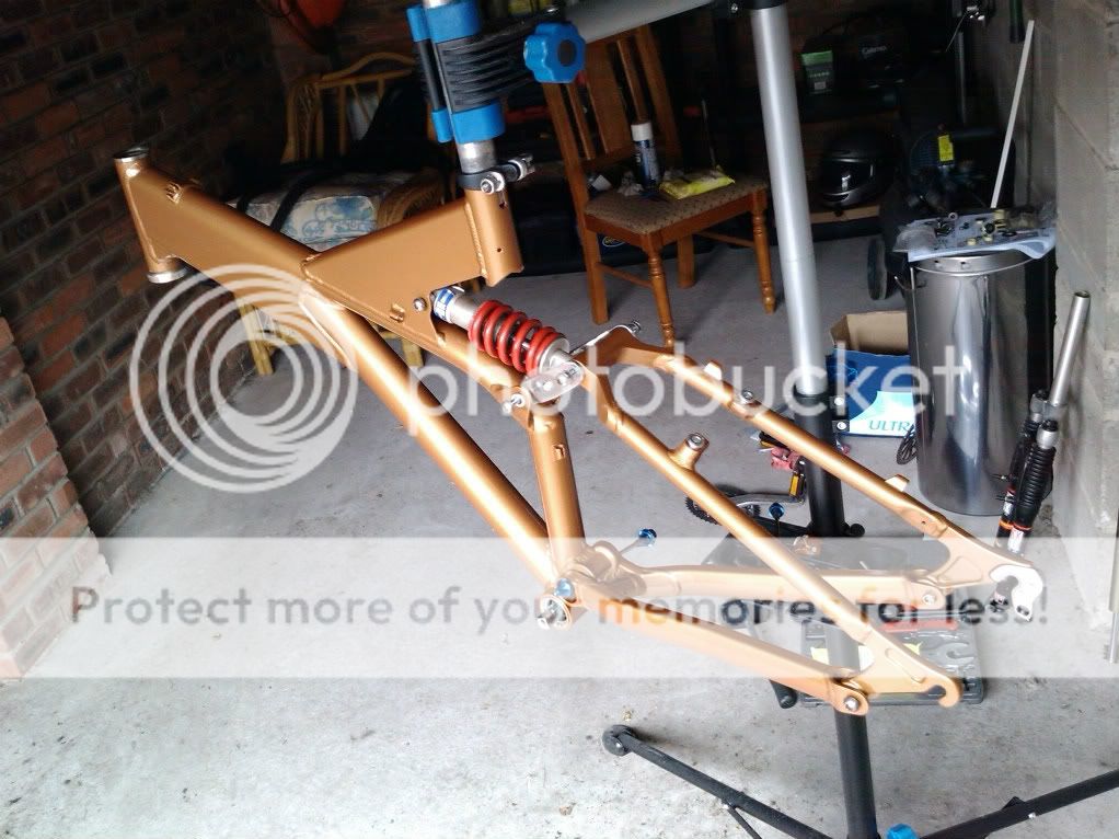

The 98 versions with the beefy chain stays (no hole through them) have a big washer on the drive side to align them, but they also have top hat washers fitted as well to prevent any metal on metal (none drive side) and metal on spacer (drive side) contact.
If you can source some 98 chain stays then your BETD kit will mount straight up with no issues, you will have the bonus of getting a stronger chain stay on the bike (i dont recall anybody ever cracking the early ones? the later ones with a hole always crack)
I know my bike also has the stock GC seat stays (but does have the disc mount hole), that's what it came with, i suspect somebody removed the rear triangle and bolted on a GC version (probably as the stock one cracked)
Here is a picture of my old 98 GC just after i resprayed it, it shows off the early (IMO stronger) chain stays
I keep meaning to build this bike back up to sell it, but i never get around to it :/
