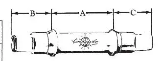

Out of interest, do you know where exactly campagnolo take the measurement for the bearing seats? On the tech drawings it appears to be the tip of the shoulder (part of the axle with greatest diameter), but measuring and comparing to the tech docs, it appears to be the actual point where the bearings touch (about half way up the curve of the bearing surface)
It's on the outer edge on each side i.e. nearest to the ball bearings and crank arms.. as per diagram `A' distance:
Incidentally, the technical docs suggest that C-Record axles changed from the first iteration 109mm (1985 Catalogue 18bis) to 111mm 1988 C-Record Catalogue.
