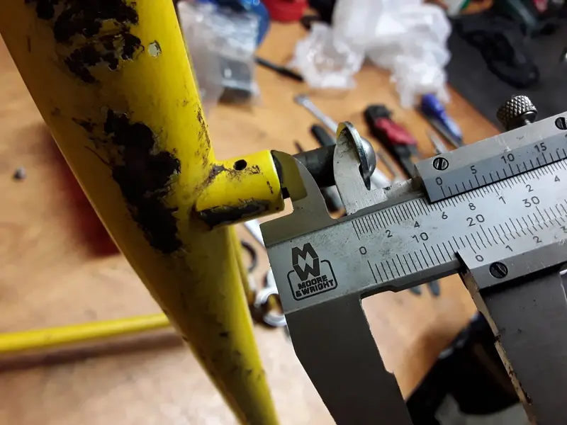

As for your stud sizes, dont know if its been answered, but i had a chance to measure a few today.
Standard cantilever boss....8.0mm x 16.2mm
U Brake boss 8.9mm x 16.8mm

Thanks for measuring, let's hope standard BMX will fit.

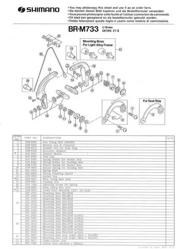

I found the parts list and it's part 83C 9807 and 83C 9808 (I assume I want the light alloy version for this frame).
Tried to measure the inside of the U-brake and it's more like 0.75mm height.
Having utterly no clue what I'm talking about annoys the sh*t out of me because I've never seen U Brakes let alone took one apart.

All shimano u brakes have the same stud size.....thats basically the brake im using....just without the booster......but its the same fit.
I'm a complete idiot.

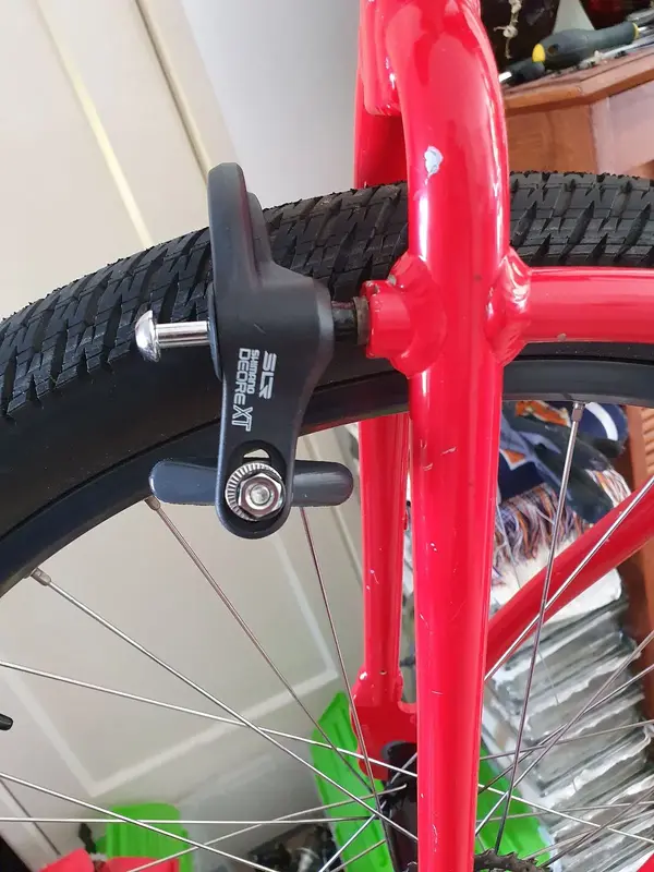

This one is for an under mount.
This is how it's "correct" on the right side on my frame, it should be left turned around on the bottom chainstay.
Because I did the lettering the correct readable side up it would not in more then 7mm, NOW it's eactly 17mm in but it's on the wrong side on the wrong end.
This shit is doing my head in 🤣, in reality I'm not really laughing.
Edit; Nevermind, I think it's supposed to be upside down.. but why.. it doesn't make sense.
Then again the Japanese do write from top to bottom don't they. I'm tired, I need a beer.

Yes. They are all made for undermount. So the lettering will be the wrong way round on a seat stay.
And yes...they will be on opposite sides to underneath.
