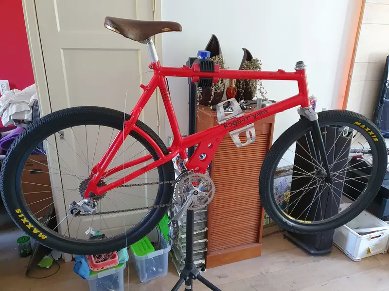

Building the bike nobody wanted. 1991 RidgeRunner.
Never too old to learn, now to find these bosses.

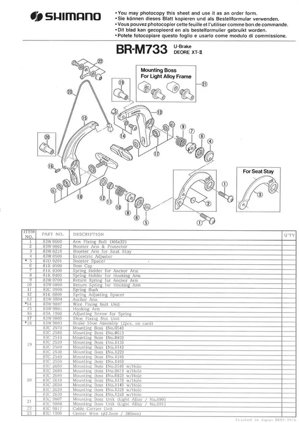

Those are canti bosses unfortunately.
Inserts in the frame are M9, this is what the originals look like (let me find a picture)
Fairly sure this is the exact one.
It's #21 in the rectangle, #83C 9807 and #83C 9808
I'm close but now I need someone that has/makes them.
Surely they would be interchangeable with other frames (second hand) as they are 17mm tall.

Ok, I get it now. That makes for an interesting challenge.
It looks like that place I linked to will custom-make screw in bosses. Or there are M9>M6 thread reducers available, if you can get U brake bosses in M6??
(But M9... why?! Same for M7 bolts in some stems... I just don't get it.)
Just go to any engineering shop, it won't be cheap, but i doubt they will charge you the earth. Or find a retired engineer with a hobby lathe in the shed.....they are normally desperate for projects to keep them out of the house...😂.

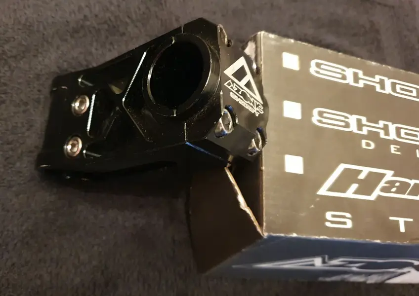

Postman came with a sorta NOS Shorty.
On the box it says50 but it's a 75mm.

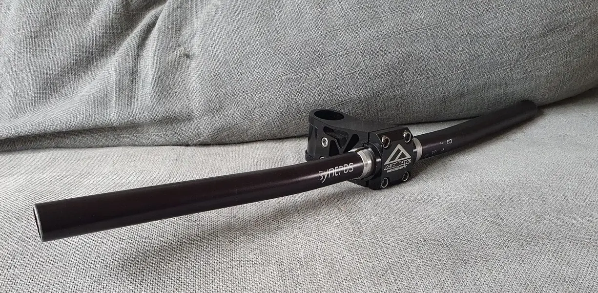

Handlebars are not the ones I'm gonna use.

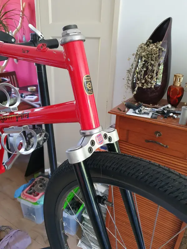

Got the steerer tube made, it's basically a 300mm RTS with the tapered bit machined off and the old retaining ring machined back in.
They didn't machine in a groove for the keyed lockring but I can work with that, it's not needed when tightened correctly.
Borrowed a tool from my LBS to saw off the excess thread, now I need to figure out just how much.
Should I just use a ring regardless just so the wrenches have easier access?

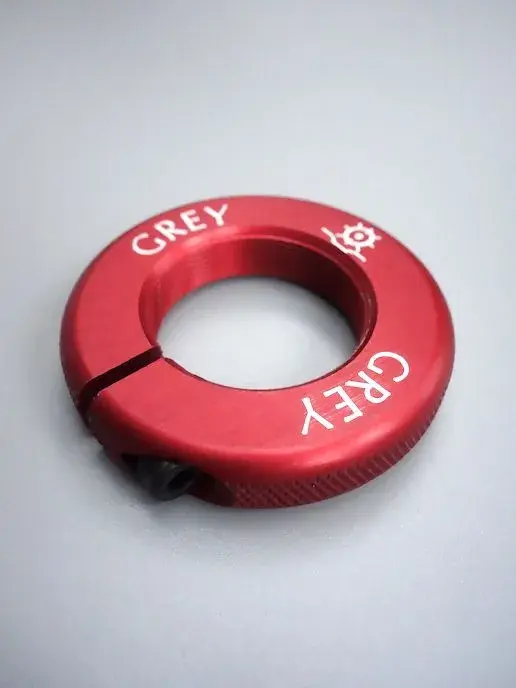

Why not add a headlock / threadlock to it to keep it tight and save cutting the steerer?
Think Roly at bicyclist.cc had some
I'm not sure what that is mate, but I'll have a google.
Is it this?
