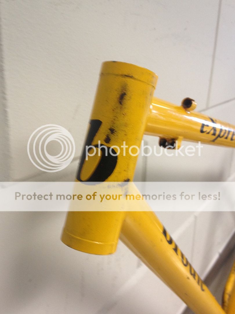

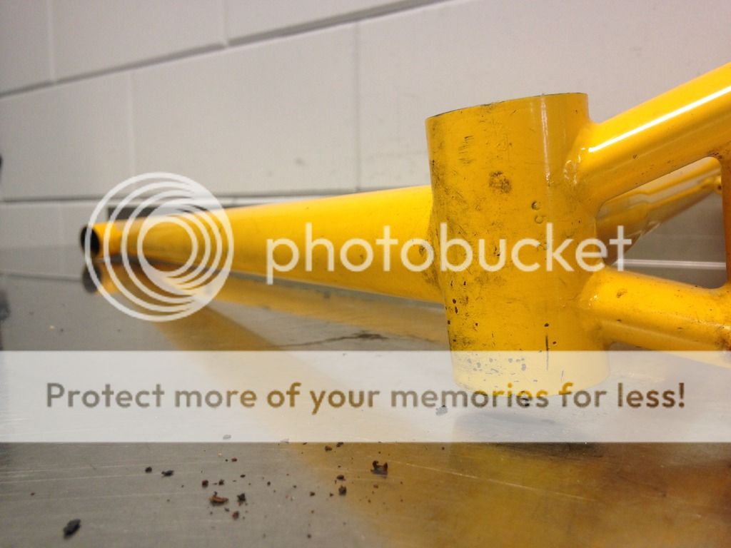

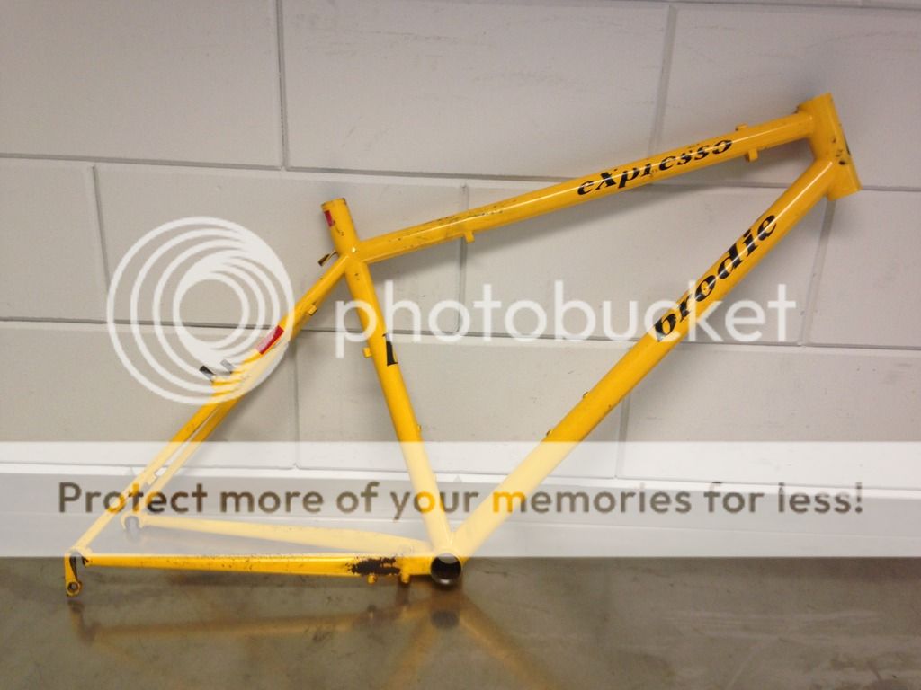

Ha Ha, I'm back! Though I never really went missing, but I wasn't updating this and underground scoring parts and moving homes. I somehow lost my workshop while moving, and I still have a lot of work to do in the new home. But when it's finished I'll have a workshop again. Now back to the Brodie :D
Suddenly all the parts are coming together nicely: Silver seatpost correct size and brand, nicer crankset (for this build at least, I love the M900's) and my unicorn. Thanks to colleague and fellow retrobiker Scherge78 I have found the missing link for the build on the German forum. I was struggling with brake lever choices, secretly wishing for very hard to find.... Paralevers :facepalm: I know they are weird
They are funky, very 90's, solve a problem that does not exist and I love em. Besides, I was looking for forged levers to match the M910's I want to use. Very happy, as this was the missing link. Now I only need some small parts and a lott of elbow grease to finish it, and of course money to get the paint sorted.
I have build the front wheel this afternoon and only need some more black aliminum niples for the rear. It will still be slow, but at least I'll be able to move and post some updates every now and then.
