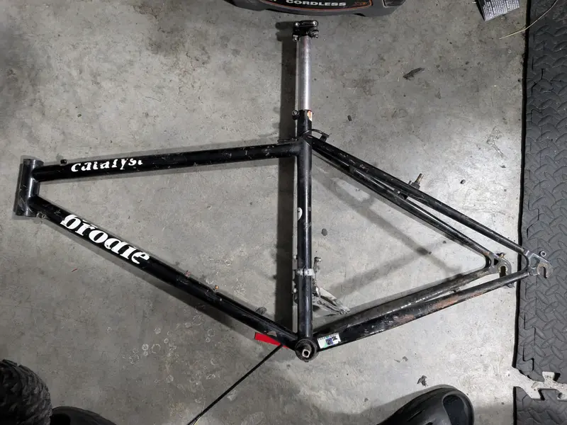

I have a 93'/94' i think. Catalyst serial #2854 that I am going to get re painted.
Where did you get your decals?
Got them grom Gill at retrodecals so if you are based in UK that's your best option I would say.
He should have in file the Catalyst ones too as he has an extensive archive of decals.
BTW, yours looks so cool! What color are you going to paint it in?
