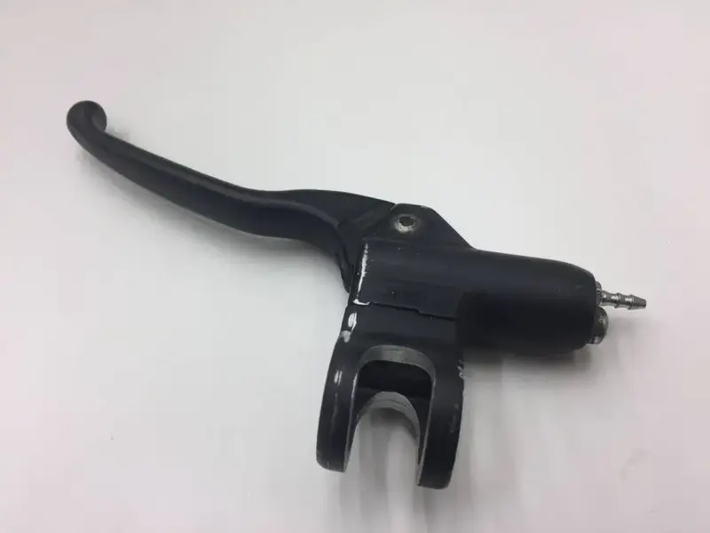

Here's a few more (small ) updates.

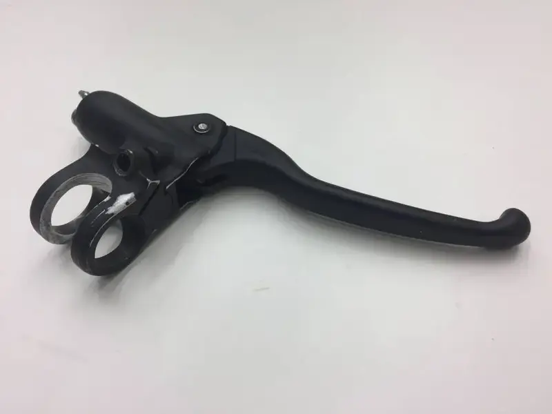

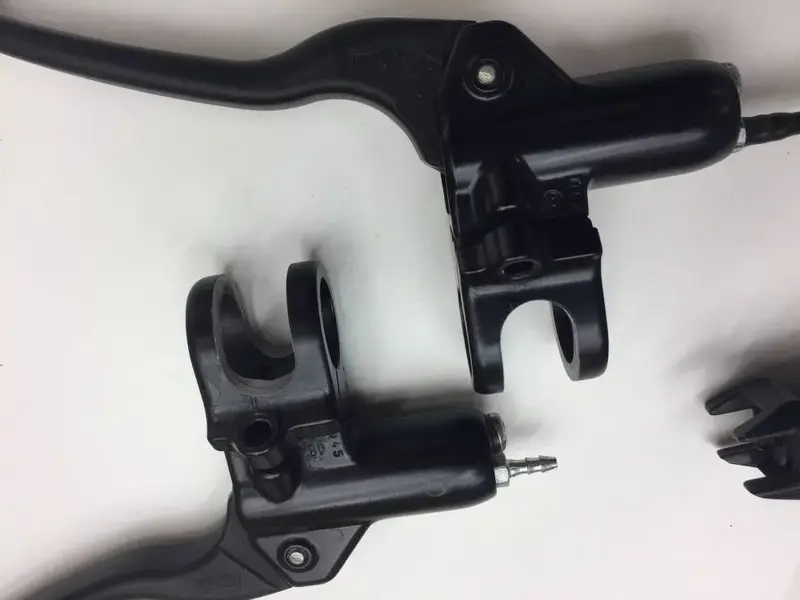

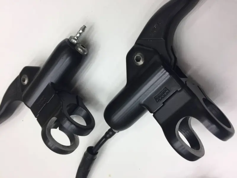

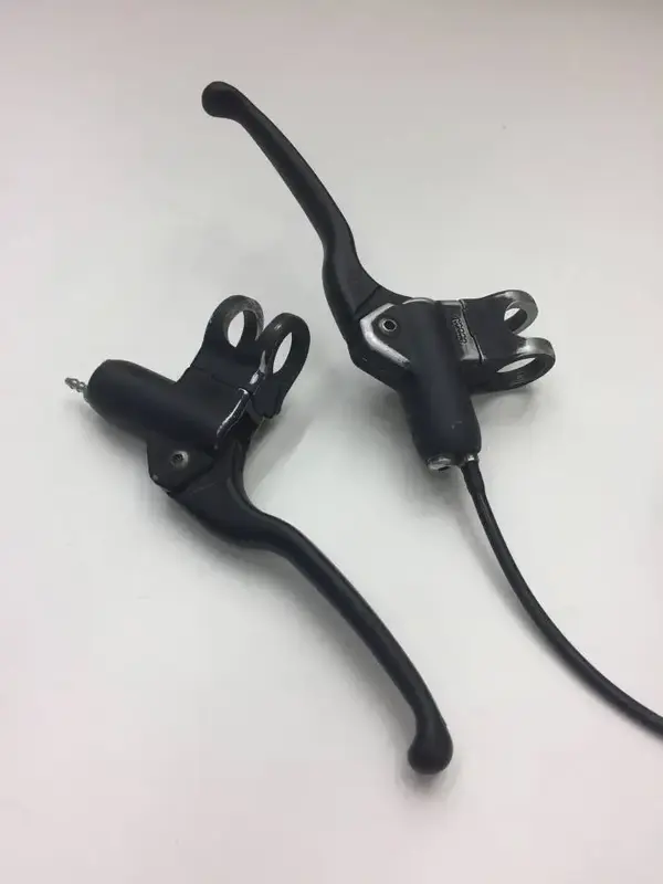

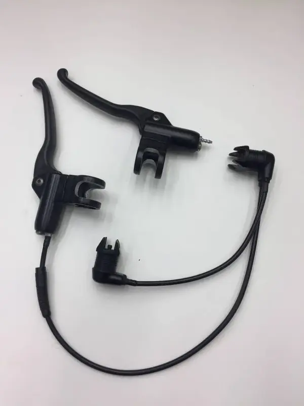

1. Maguras were lightly sanded to remove the worst of the wear marks.
Are these just known as Magura Hydrostops or do they have a model number? - The one part I've mislaid is the hose for the rear brake. I need to order a new hose but unsure of new/old compatibility.
Also… are the machined out sections of the handle bar clamp on these Magura levers unique to the RC100? - they look like a bit of extra machining has been done rather than factory standard.
Cheers.

Levers painted up in Satin black.
Bottom pic is the chain guide. Been making a few copies of this one in Aluminium. Once done, this will be added to the anodising batch.
The other aluminium piece is the block that holds the fork crown to the steerer. Will make a tidier one of these, again for the anodising batch.

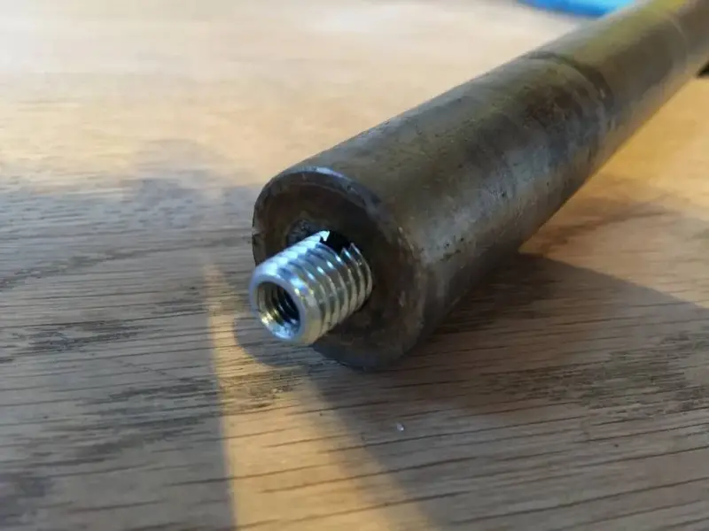

The top pic is the insert in the end of the stem/ steerer. The threaded insert kept pulling itself out when tightened to hold the fork crown on. A couple of attempts with a metal to metal loctite didn't work.
The bottom pic is the threaded insert i replaced it with. Forks now held in place properly!
