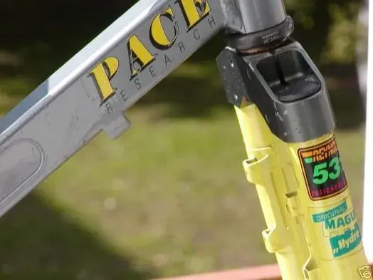

Thanks for all the positive comments so far! - thanks for the scans too Dossa. Haven't got these but then you are an MBUK guru round these parts!!
It's early days still at the moment VJM, but all of the thick powdercoat is now off!! ( at last!! ) and the fork legs, stem and Bullseye's will go into paint. Colour chosen - Metallic yellow Glazurit MY005.55
Silver as yet undecided as the fork crown is not back from the anodiser yet. Looking to get this in the RC100S spec colour rather than the normal black - then match the silver to suit.
Graphic proof has been sent to www.digiwrapltd.co.uk after recommendation from a friend...
Scored the all important yellow toes straps too - result. :D
Expect slow progress in the coming weeks.
Cheers

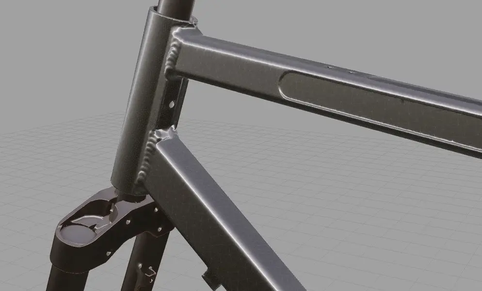

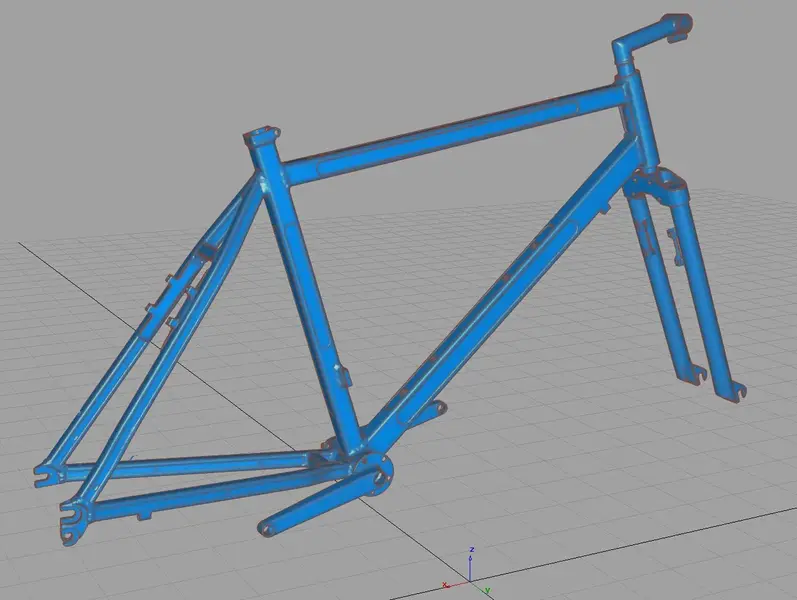

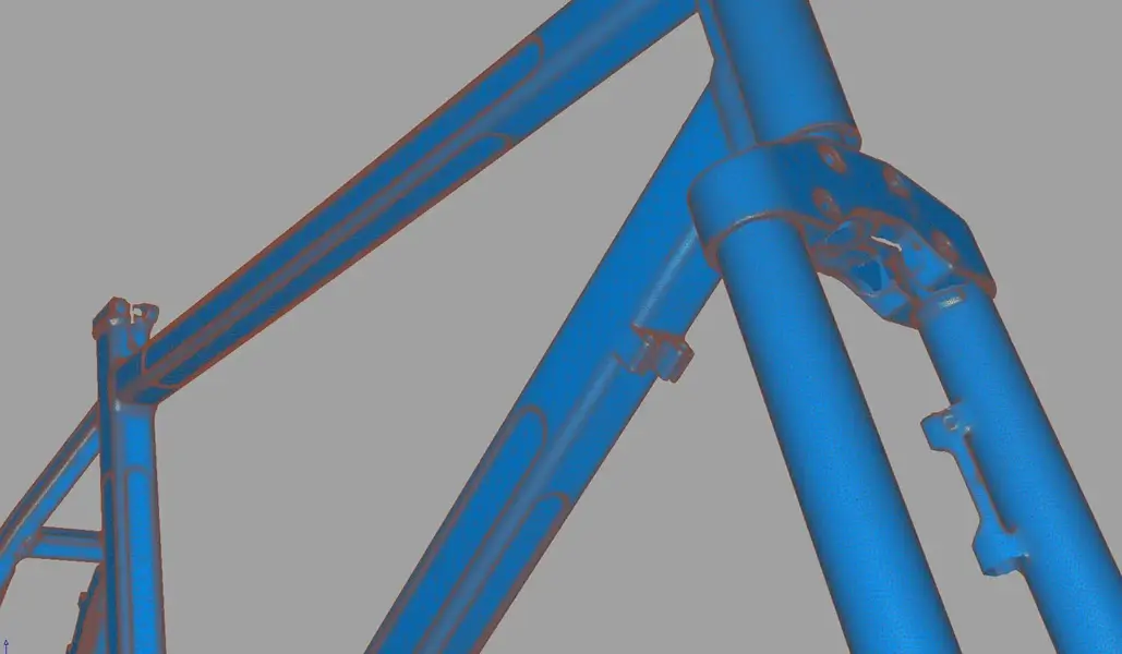

2012 started with my RC100 frame/forks/stem and bulleyes in a stripped state awaiting etch priming and painting. Other priorities took over and the project went very much on the back burner.
One of the things I had done though, was to record the frameset and parts using a process called photogrammetry scanning. These files were captured as separate parts - and only just got around to aligning the parts in their correct positions.
Although this is more of a "let's see what we can do with the equipment" project, it has proved useful for building the datasets for the line guides.
More to follow on this in the next installment.
background and details of process here :- http://www.retrobike.co.uk/forum/viewto ... 3&start=15
Search for www.gom.com for more details on the scanning process.

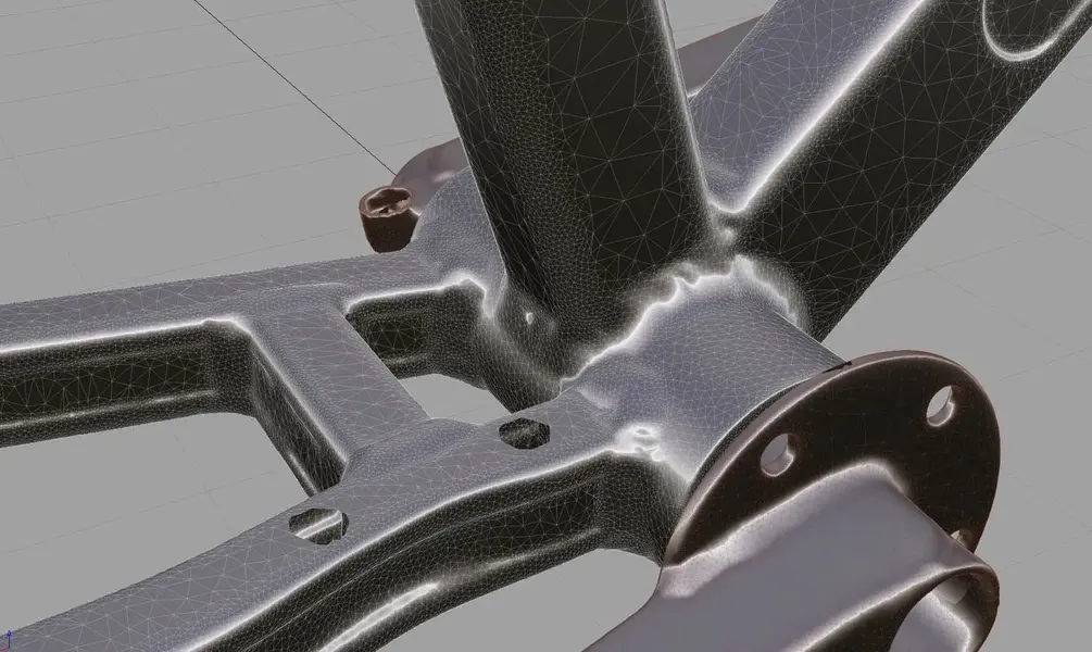

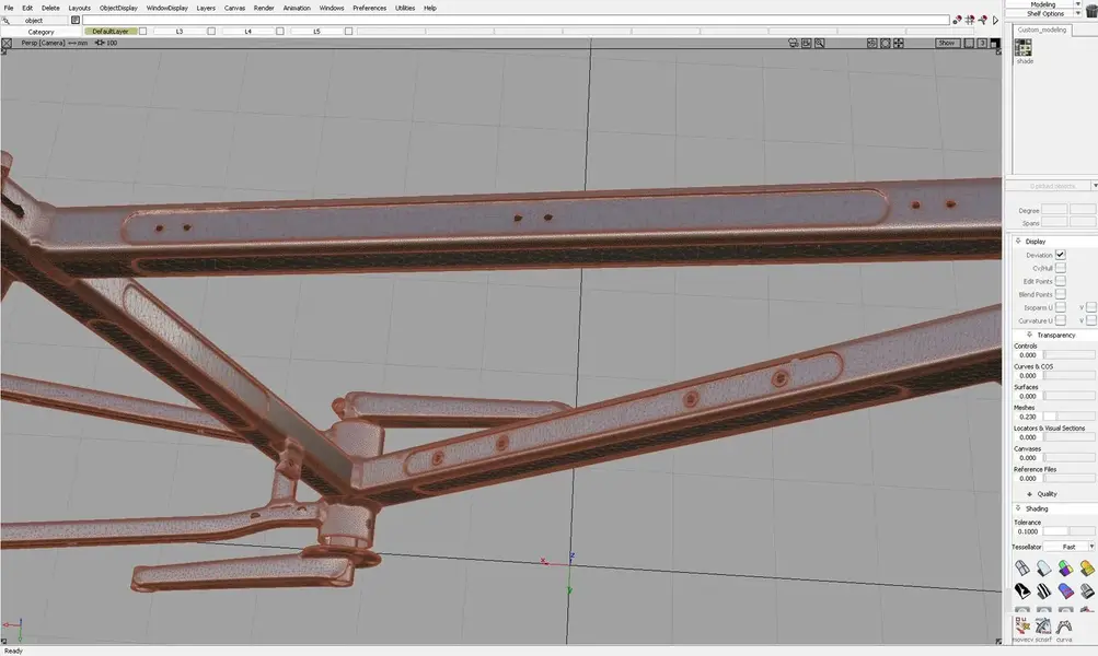

Interesting to see this technique in use in another application, we use it for measuring the distortion of large flanged mating surfaces on pump casings etc
I am interested in how the CAD package picks up the detail on the welds and other items such as brake bosses etc? (we just use a algorithm on the co-ordinate data to say if its in or out of tolerance so no fancy pics involved!)

@nevadasmith - In a car design application, we use scans of this sort to build math models by recording the surface of full size clay models. We can also use this data to animate or render images - hence the fancy pics!
This data is also suited to engineering or checking applications - the scan is accurate to approximately 0.05mm of the original Tri-top set up file.
It picks up details such as welds and brake bosses fairly well, but there are limitations. I couldn't scan the inside of the chainstay brace for example. The polygons are also 'regularized' to improve filesize for use in modelling/rendering packages. Basically, flatter surfaces will have fewer polygons - detailed areas and radii will have more.
