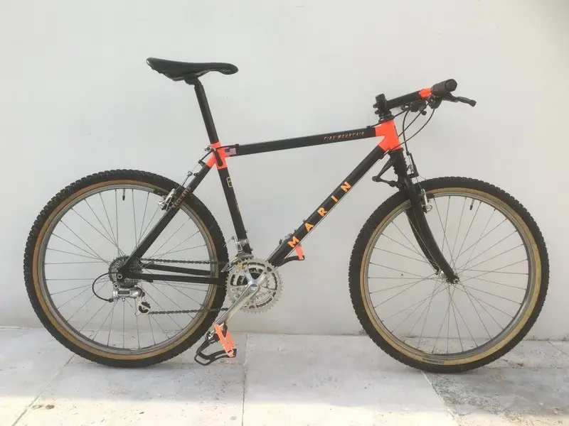

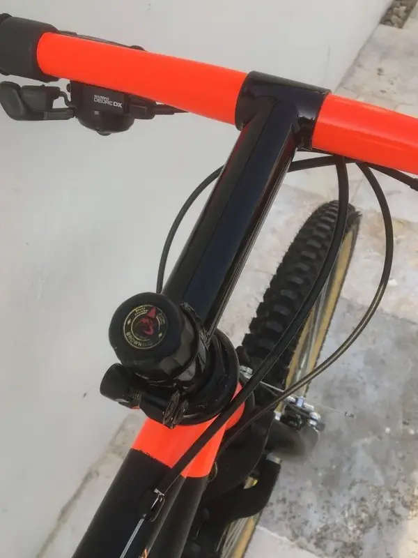

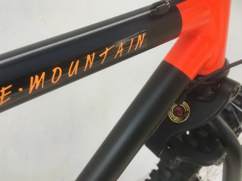

Here's some pics of my update.
Managed to source the browning top cap and lower brace badges.....it wasn't easy. ;)
Cheers.
boy"O"boy

Lovely bicycle! You got it pretty much bang on as it was pretty much the paint scheme and decal design from the 91 catalogue.
I also have a Browning Pine Mountain 1992 which I purchased after lusting after the 91.
Forks still work even after being hung in the garage with the frame for the last twenty odd years.
All this lockdown business over the last few months got the juices flowing again and your thread made the pondering over getting it back up and running a little easier.
Great work!
