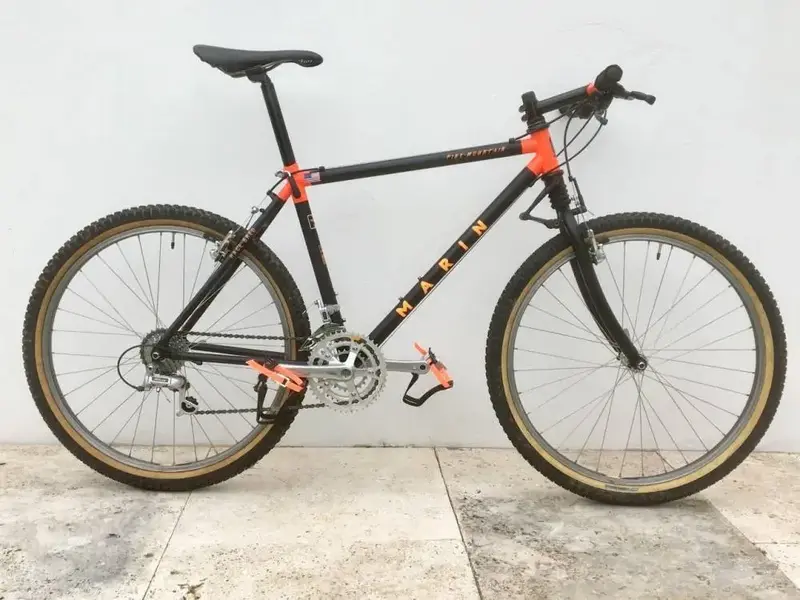

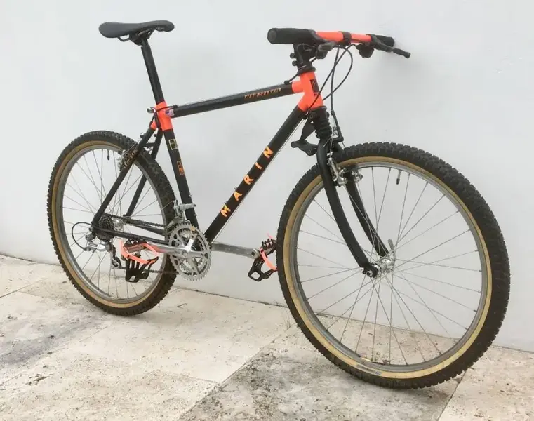

Considering the original intention was to break this to build the Cannondale - I'm very pleased with the outcome. Ironically, It's the Cannondale that will now get broken down as try as I might, the frame is just too small. I'm hoping for a result on the Saracen Kili and move all the parts over to that from the Dale.
When I can, I'll try and get a ride report for the Pine Mountain. A quick spin up and down the drive shows that the forks are working - definitely in the 'lock out' position although there's not a lot of difference between the 2 'movement' settings.
The only update I can add are a few pics showing the Orange toe straps - they finally turned up 3 weeks late!
Other than that.... it's complete! ;)
Here's a spec list for those who are interested.
Frame: Marin Pine Mountain - Browning fork specific geometry.
Tange Prestige ~ Frame number M 91 06 0050
Repainted Matt black and Neon Orange. Reproduction decals
Fork: Browning Suspension fork. 2 x suspension settings / 1x lockout.
Based on what appears to be a modified Tange Super big Fork.
Headset: Shimano M732 XT 1 1/4"
Stem: Original Marin 1 1/4" 'Aheadset' style. repainted gloss black
Handlebar: 580mm Alloy. Repainted 'Neon' orange to match frame
Grips: Ritchey Foam True grips
Barends: Not this time.
Brakes: Shimano BR- M650 Deore DX
Brake Pads: Non original - Mat change this depending on how it rides.
Cantilever cable hangers: Shimano.
Shifters: Shimano ST - M075 Deore Dx
Front Derailleur: Shimano FD-M605 Deore DX 31.8mm bottom pull
Rear Derailleur: Shimano RD-M650 Deore DX Short Cage
Cassette: Shimano CS-HG70 7 speed.
Chain: KMC 7 speed with 'power link'
Chainset: Shimano FC-MT60-A Deore DX
Crank Bolts: Shimano
Bottom Bracket: Shimano UN-51 118mm
Pedals: Shimano PD-M735
Toe clips: Black Mt Zefal
Toe straps: Neon Orange Mt. Zefal
Hub Skewers: Deore DX
Rims: Araya RM17 32H
Hubs: Shimano HB / FH-M650 Deore DX 32H
Nipples: Alloy
Spokes: DT Swiss
Tyres: Amber wall Tioga Wonder Dawgs 1.95
Tubes: Presta
Saddle: 1992 Flite Titanium
Seatpost: Marin Branded 'Kalloy' 29.4mm
Seatpost Binder: Marin branded rubber handle Quick release lever
Cheers.

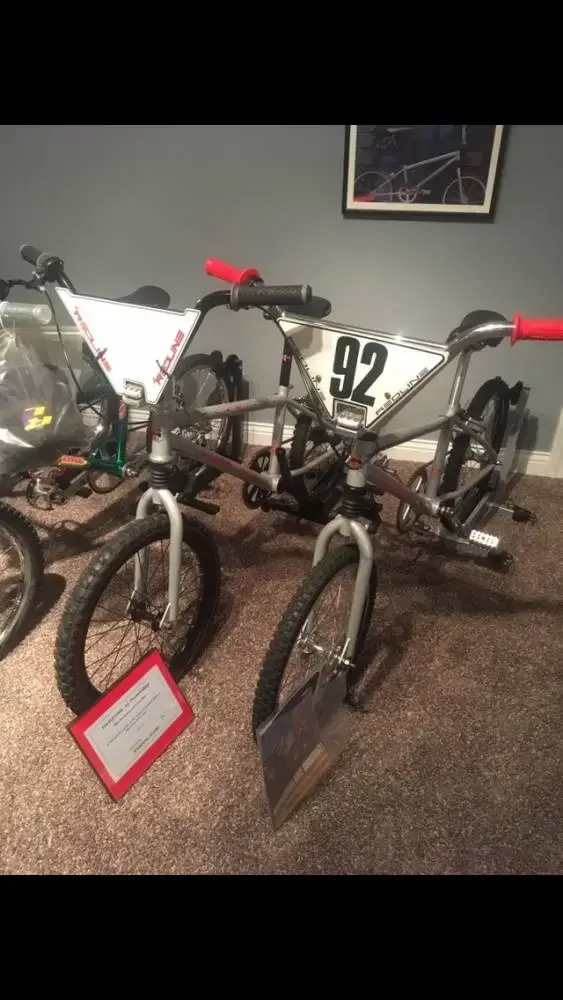

Thanks bkp :cool: - here you go!
Back on page 5 - my research bought up some tasty images of the Redline BMX that used the Browning suspension fork.
Turns out that those pics are bkp's and he kindly sent me these images. What a collection! :cool: :cool:
If any one has a Browning Fork for sale, or even a complete bike that has the Browning fork - such as a Marin or Fusion 0260 - bkp would definitely appreciate a PM!
Cheers.
boy"O"boy
