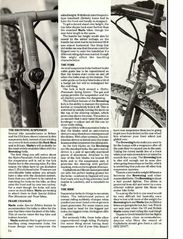

That's a great looking bike! Just read through the build thread.... What a great project. Any more history about which frame builder built it? - The Marin Prototype in the scan below mentions it's a (British) built one.
Think I saw the Pine mountain version BITD in get Pedallin' Colchester. I think it was the only one they were able to get in and it sold pretty fast. Never saw the Team Version until google.
The 1992 brochure only shows a small picture of the fork set up and not the complete bike.
Does anyone have any more brochure information?
Here's some scan's I've taken from MBUK Jan 1991 of the prototype. I've still got to go through my old MBUK's / MBi's to see if there's anything else out there.

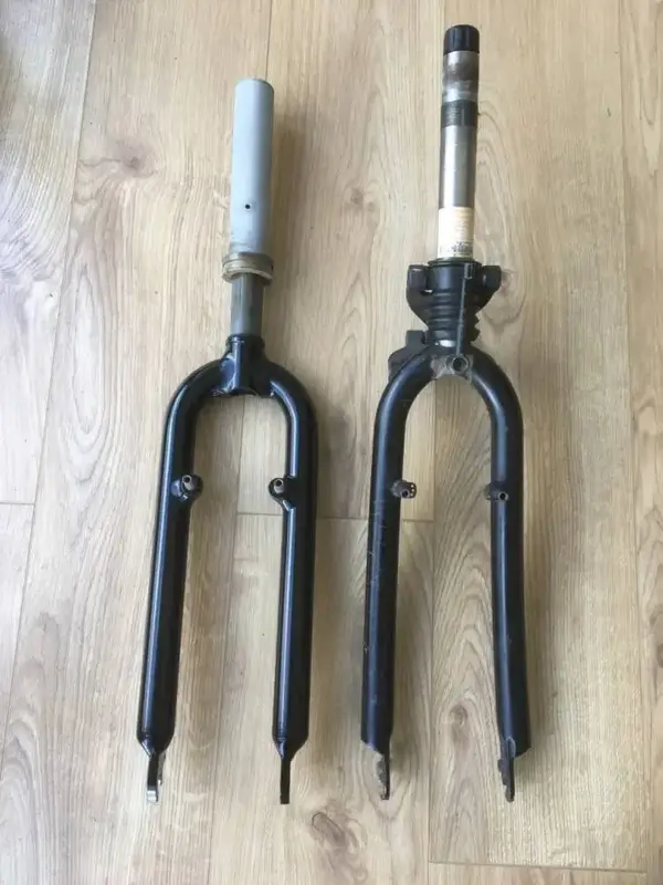

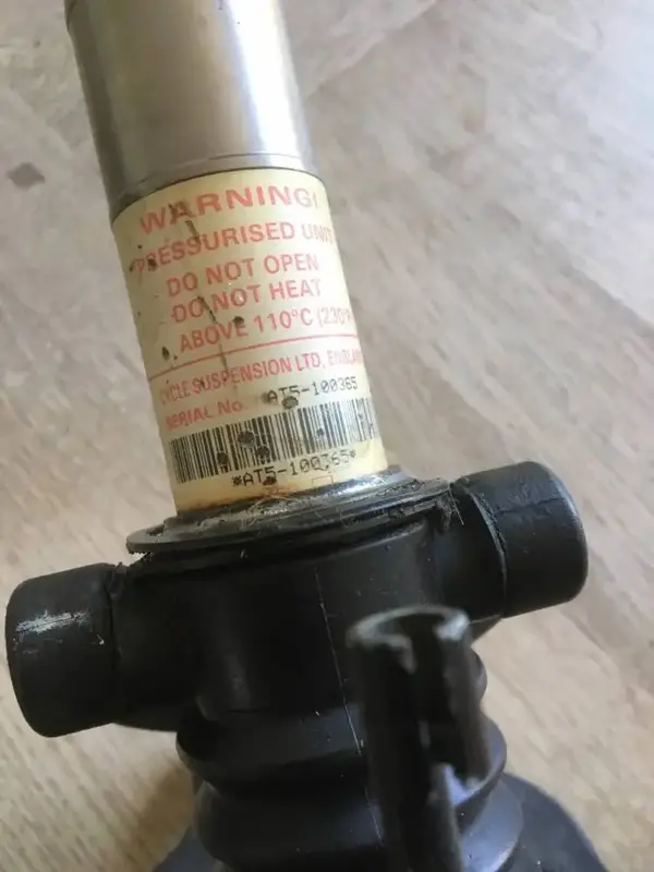

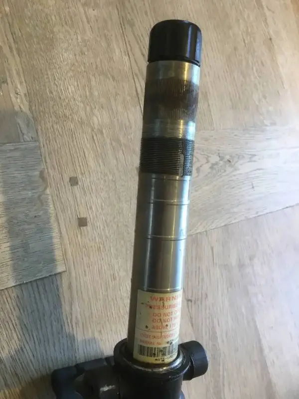

I've added some pics of the Browning shock out of the frame. Someone was asking about dis-assembly. I think reading the sticker, i'd be very hesitant to start taking the actual shock apart. The steerer is 1 1/4" threaded lower down. The top section is not threaded but grooved to grip the 1 1/4" ahead stem. 2 setting and 'lockout' adjuster remains part of the shock assembly.
I've added a pic next to a Cannondale Headshok fork as a comparison - like a evolution of the browning fork in a way (and probably a nightmare to dis-assemble too!)

Interesting these... the magazine scan close up of the headtube I could convince myself is fillet-brazed, which could be Roberts, and the write up mentions a British prototype. Also, see the cable guide position is right on the headtube on the prototype. The others in here seem TIG’ed and I’m not sure I’ve ever seen a TIG’d Roberts (someone will correct me).
So perhaps an initial one/few brazed in UK to prove the concept, perhaps as the fork was this side of the Atlantic, then a Marin ‘mass-produced’ copy for production, though in relatively small numbers for Marin.
