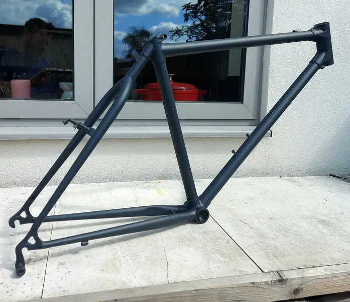

So....finally. Free time and great weather for outside painting & drying. Progress has been made!
1 + 2
The stripped frame was given the once over to check all the old paint was off. It was then etched primed using UPOL etch primer.
I protect the bottom bracket threads by inserting milk bottle caps. The rear derailleur hanger has a bolt threaded in as well as the bottle cage mounts.

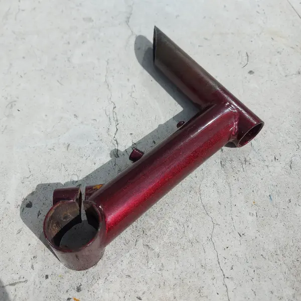

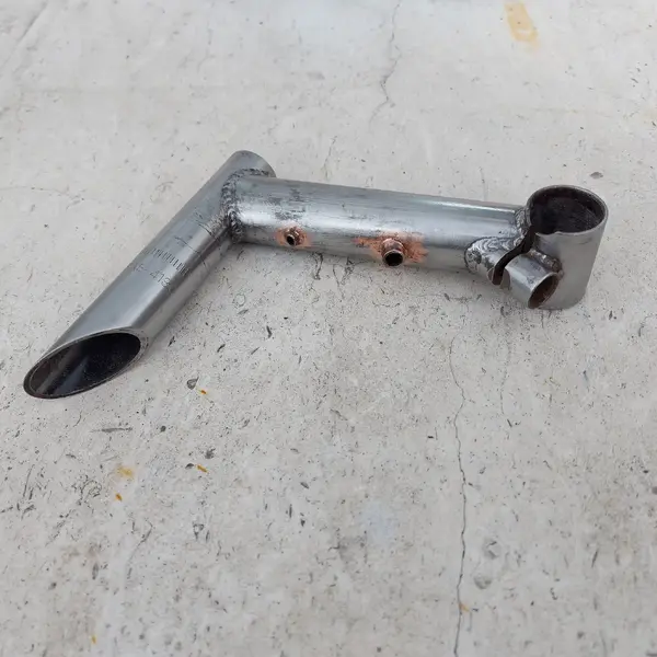

Still undecided to go with a rigid or flexstem for this build (got both in the parts collected for this)
This stem came from Nporternz off a trashed Voyager.

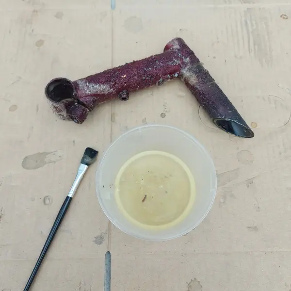

5.

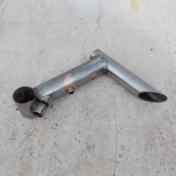

Stripped using another dose of Langlow strip away pro.
6 + 7
Cleaned back and ready for etch primer.

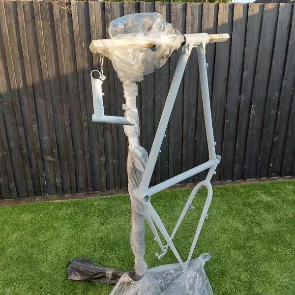

8

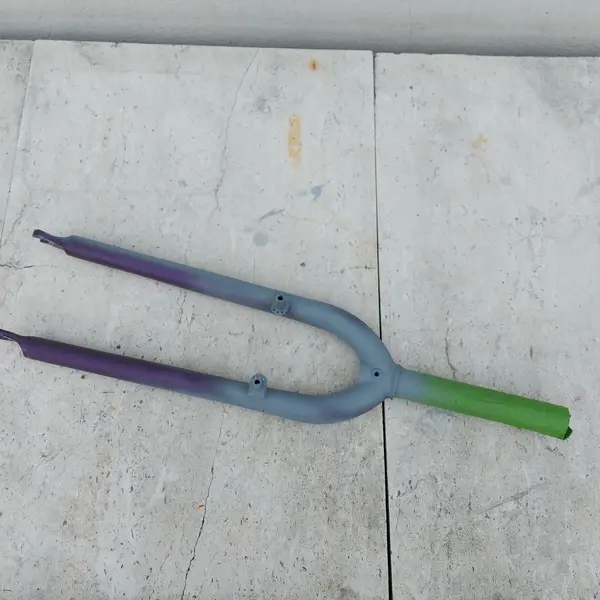

UPOL high build primer applied over etch primer.
Wet rubbed back between coats. Stem ready for colour....frame needs a bit more attention to detail before the purple goes on the main tubes.

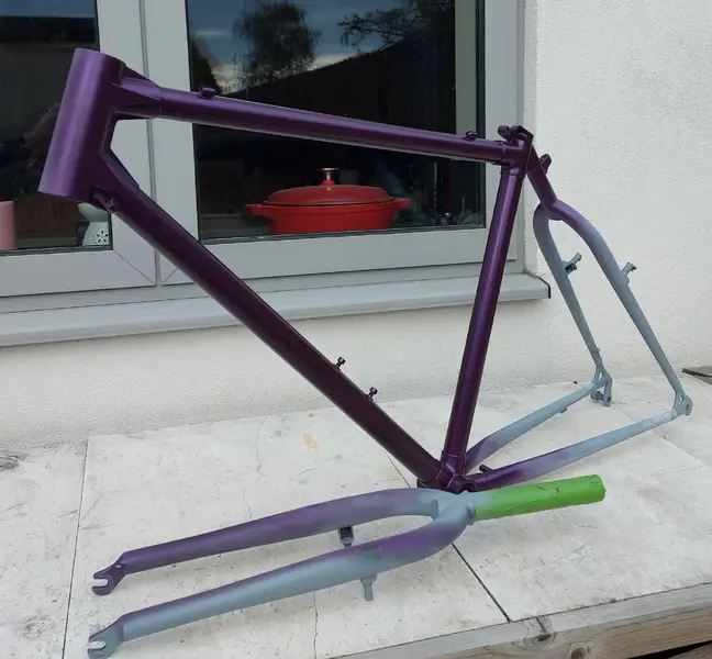

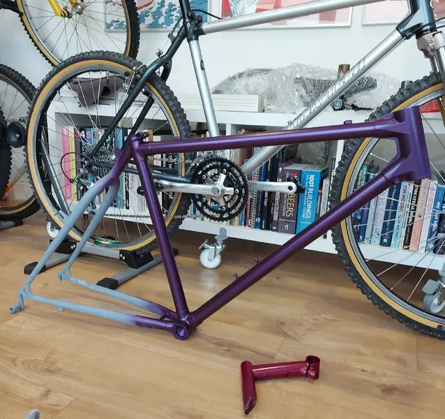

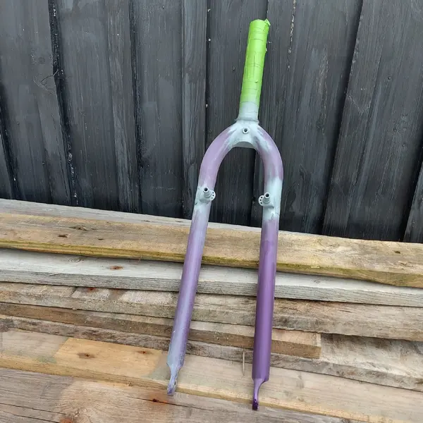

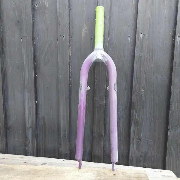

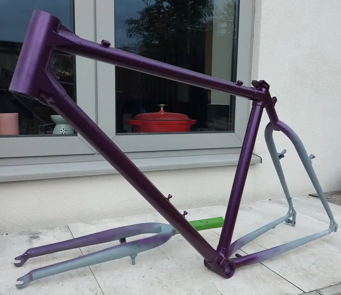

So. After a bit more prep rubbing back and recoating the primer, the first colour is ready to go on. The forks have been rubbed back and primed to but a little more work needed on these.
The purple Mica 💜 on the main tubes was colour matched by the paintstore in Leamington Spa from the frame before it was stripped.
I'd left the frame with them for a week or so and they used their colour match tech to get an exact match.
The paint looks very 'Cadbury's chocolate' at the moment but rest assured, I've done a test piece and lacquered it. It really comes alive when the clearcoat goes on and the metallic 'pops'
Back to work so this will rest for the week before masking up and going on with the pink Mica.
Here's where I'm at so far..
