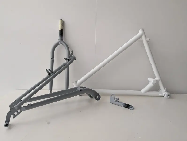

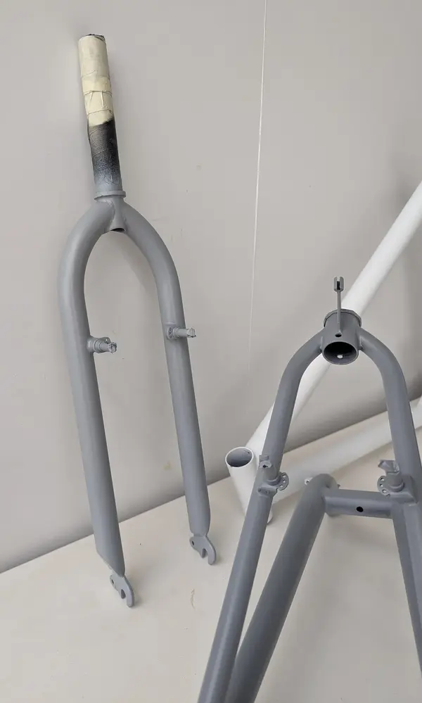

Talking of painting - a small update.
Primer coats now complete. These have been wet sanded with 600 grit, then 800 followed by 1000 in readiness for the colour coats.
The frame and flex-stem in white primer to enhance the lighter colours. The fork and swing arm is black so grey primer.
Cheers
boy"O"boy
