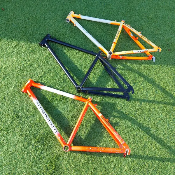

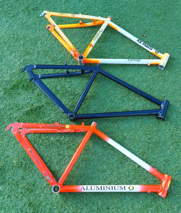

What I needed was a 2nd 17" Orange Aluminium "O" to try these ideas out on and a wanted Ad. was put out there....but I lowered my chances of scoring a 'twin' to my build by specifically asking for a Gen 1 or Gen 2 version.

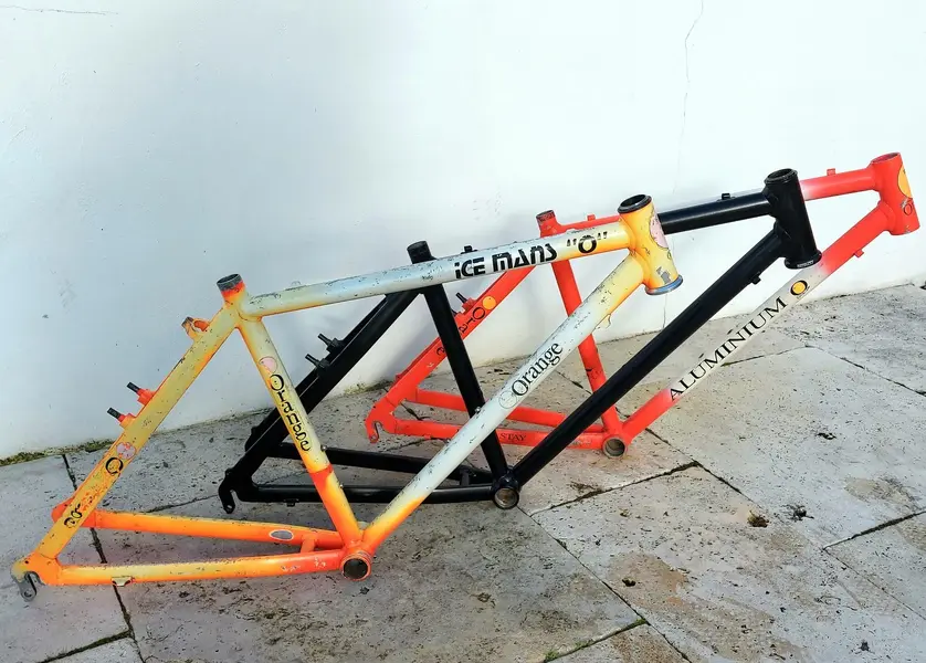

Cheshire1980 was 1st up with a 17" frame to offer. After a great transaction - I was the proud owner of the infamous Iceman "O"
On delivery though, it soon became apparent that this prototype "O" was incredibly unique and it would be sacrilege to powder coat this black.
I decided that this will get a full restoration in it's orange and white fade so put this one aside and went looking for another.

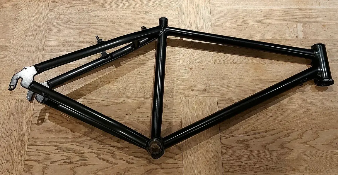

A year later....the FS ads offer up a complete Gen 2 in Orange and White fade. Taking the plunge, I purchase the bike and pick it up at a Porsche swap meet near Bicester. It seems like the ideal candidate to build the twin...

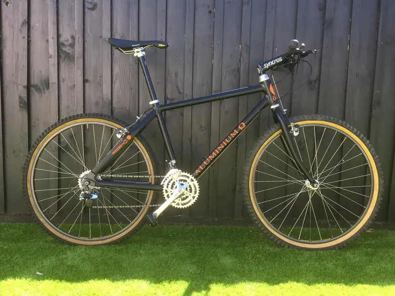

Until Stoney_god posts a FS ad for a 17" Aluminium "O" that had already been powdercoated in Satin black. As a stalled build, this was the perfect basis.
This one is a Gen 1. Originally another one of Cheshire1980's stash of "O" - looking far better in it's repaint than when it was pulled in a sorry state from a Welsh garden.

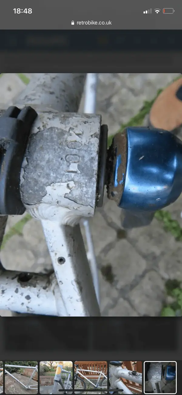

The frame number is A91020015
This makes it number 15 from the 1st batch of Aluminium "O"
I've previously owned "O" #20 but this one being #15 is probably the Earliest production one known....unless someone has a lower number than this?

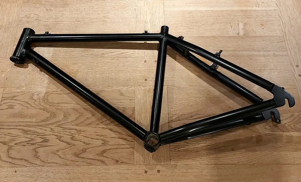

Here's the start point....

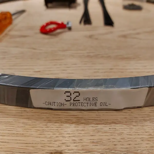

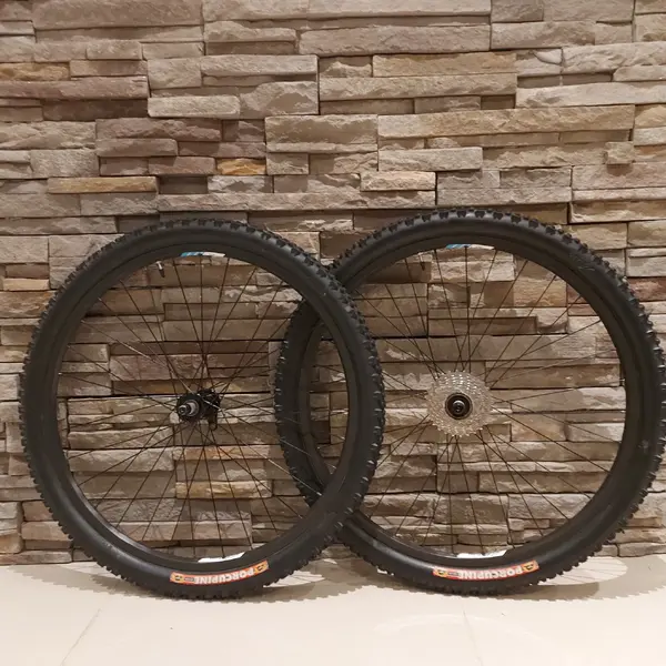

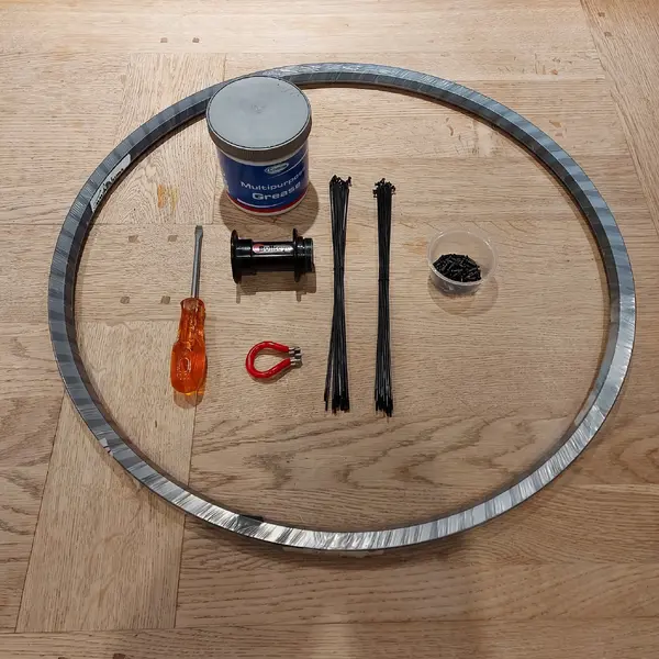

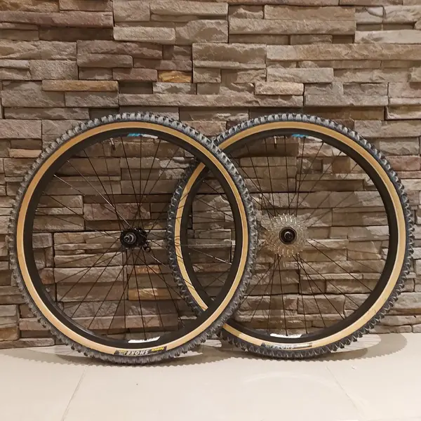

So....1st up. Wheelset.

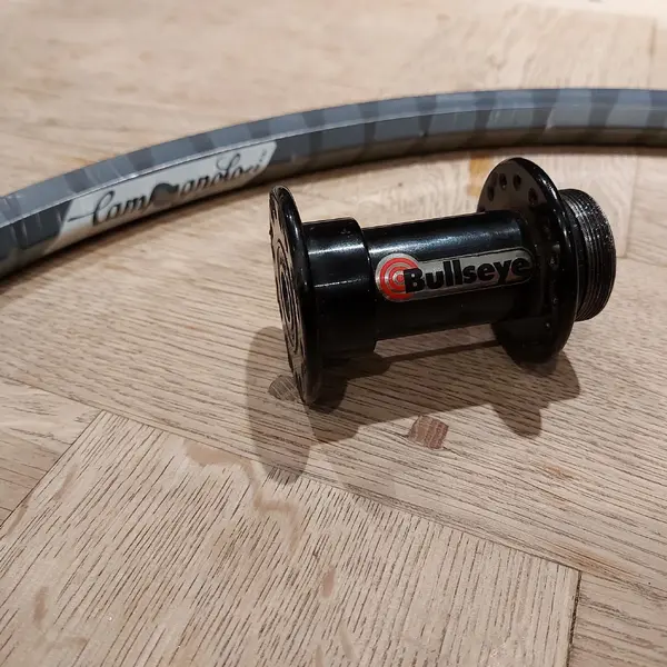

The Campagnolo Atek dark anodised on black Bullseye hubs on my Klein are one of my favourite wheelsets that I've build myself so far... so let's build another!
Maybe let's go even more 'stealth' and go black spokes and nipples too.
and a couple of tyre combinations to consider when fully built.
Black Onza Porcupines in 2.1 flavour...
Or Panaracer Smoke Lite Compes in Amberwall.
Decisions, decisions

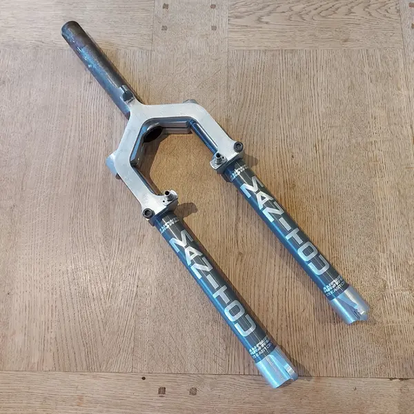

Going with Manitou 1's as the choice of fork.

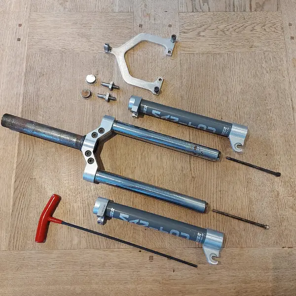

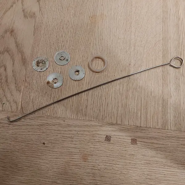

After opening up the Manitou's I had stashed for this in 1 1/4" flavour.....I promptly found they had no internals whatsoever!
So a question to the forum here -
soon got me on the right track for what I needed for a rebuild. I settled on a spring upgrade kit from @fguki

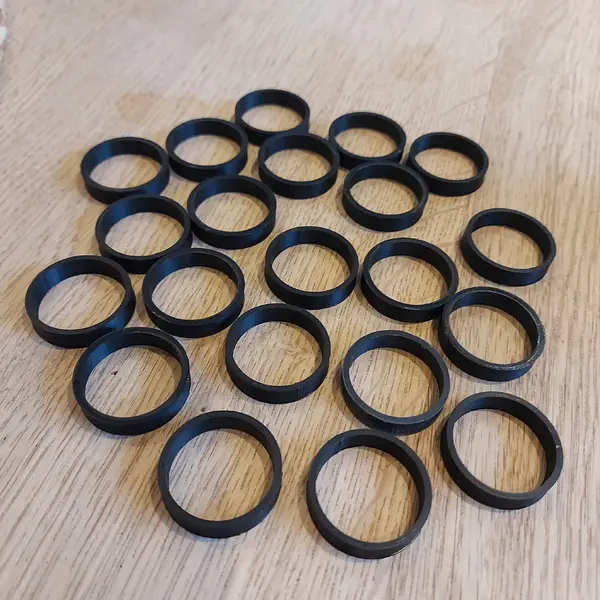

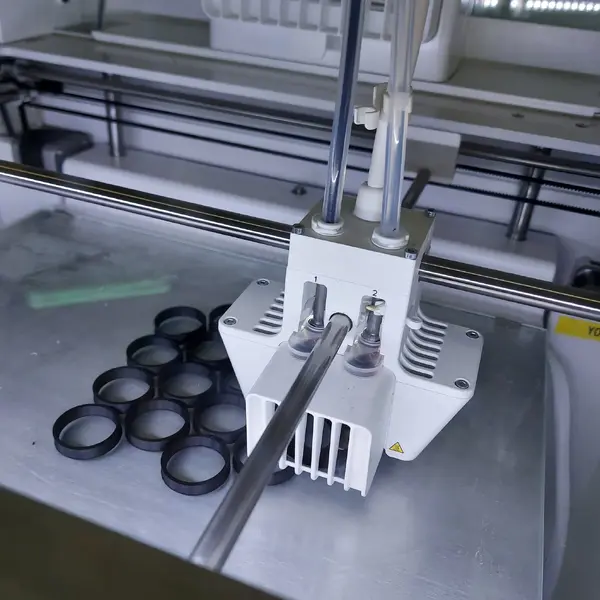

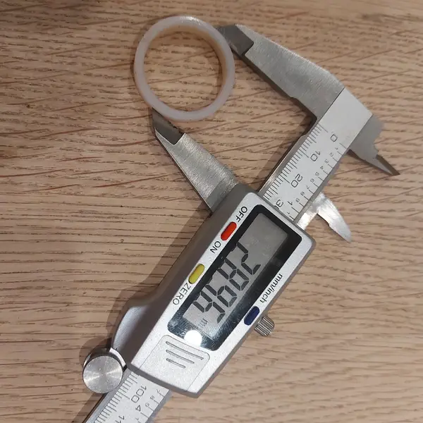

Although I thought I'd got lucky, it turned out my fork lowers were full of melted Elastomer mush. The missing bushes turned out to be hidden in the mush too....but it did send me down the path of developing 3D printed replacements, something that I'm keen to continue now I understand how they fit when you put them back together!
What you think is a snapped Bush...is vital for the reassembly!
More to follow...
Starting point.
Initial disassembly with long 5mm Allen Key
Fishing out kit to remove elastomer gunk.
3D printing new bushes
Fresh off the printer.
...but the originals were buried inside the elastomer gunk! 🀦
So measured the originals for another crack at 3D printing in the correct external size with split.

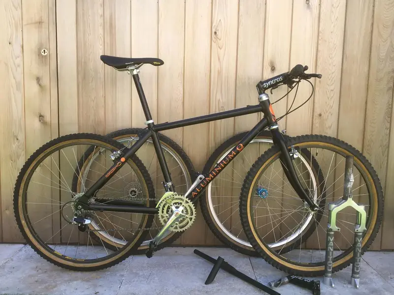

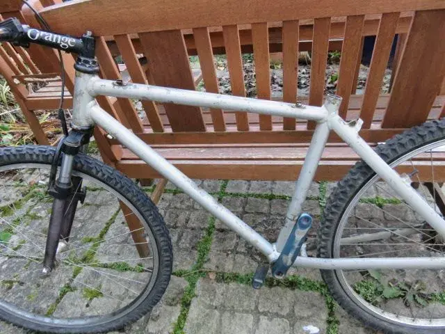

Going down memory lane, seeing the icemans and the freshly painted black O again 😎. Some pics of the O before it was painted black by the next owner πŸ‘. Looking forward to your progress, and obviously your super attention to detail. Campag Atek and bullseye will make it a more interesting build, great choice Ben🀞🏻. Anyway keep up the superb work, will be following closely πŸ˜€
Great to see those pics Calum.
From seeing those garden pics, it's already come a long way. What could be seen as fate too...it was the initial PM asking if you still had this "O" which lead to purchasing the Iceman.
Stoney_god had done a great job getting it from those pics...Ironic too that this frame #15 was originally Matt Silver, as was my frame #20.
Maybe the 1st numbers of Gen 1 were all Matt Silver?

And amberwall Compes, 100%!
Cheers ppl.
Going to feature a few combinations in this thread. It's got a set of rider wheels too....on amberwalls.
The compes on dark ano are one of my favourite combinations. Watch this space...
