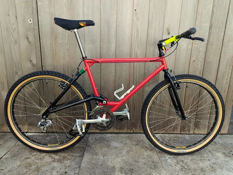

boy"O"boy's 1989 Serotta Off-road Pro-flex prototype

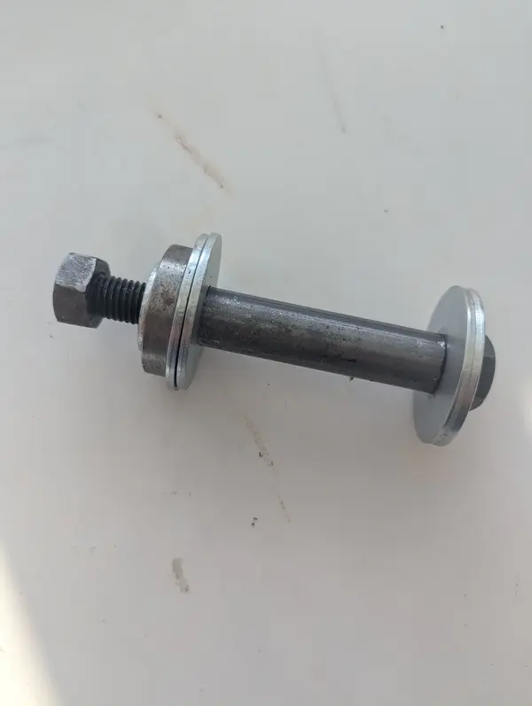

The best was to remove a fixed cup with leverage is this method below. I don't have to write anything because @rmwesley kindly created this thread! 🙏
https://www.retrobike.co.uk/threads/fixed-cup-removal-with-pics.456107/
Have used this many a time on fixed cups on old Raleigh Choppers from the 70s.
If you are having frame repaired due to corrosion then heat will certainly help remove it.
For cutting it out, carbide tipped hacksaw blade, die grinder, Dremel are all methods of attack. I suspect the stud & nut method will work if you can find a decent long leverage bar and are able to clamp the frame securely without damaging it in the process!

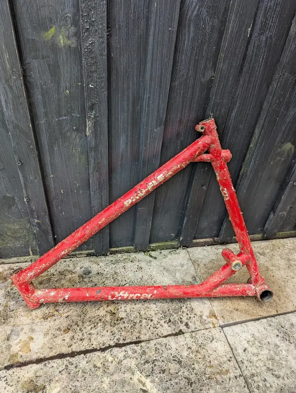

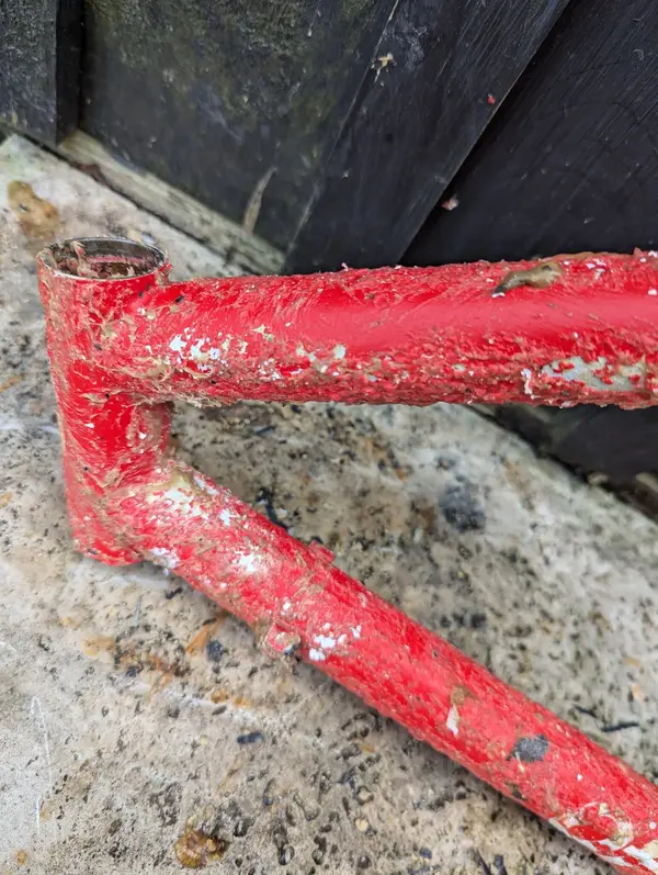

I'm not sure how many holes are still under the paint. Someone on here mentioned that steel frames that have been stored in damp conditions have a tendency to rust from the inside out.
It's looking more like the paint will have to be stripped as there's a lot of rust coming through.
The hole near the bottom bracket and the corroded cable guides will definitely need attention.

This is definitely my next step to release the troublesome cup. I've been soaking the bottom bracket shell in Diesel for the last week in the hope it will penetrate it more.
Sprayed a good slug of release fluid when trying the vice technique. When it was heated, it started bubbling from the cup side suggesting there is a gap, but the fluid not getting all the way round.
Got the parts together to try the technique above.

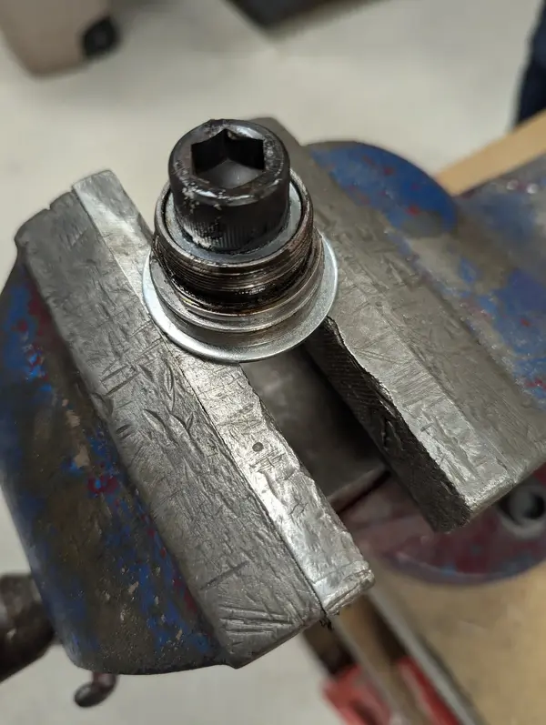

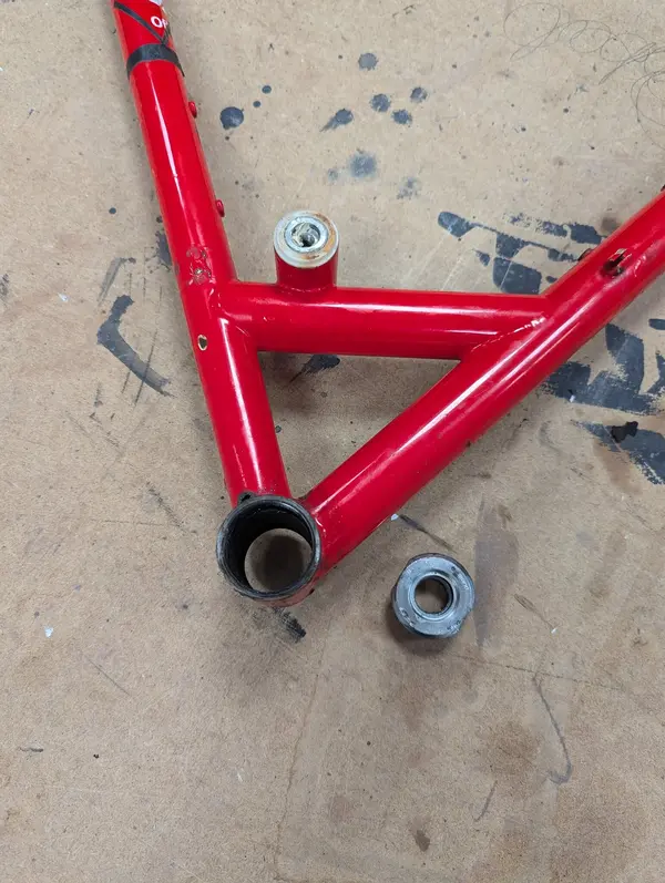

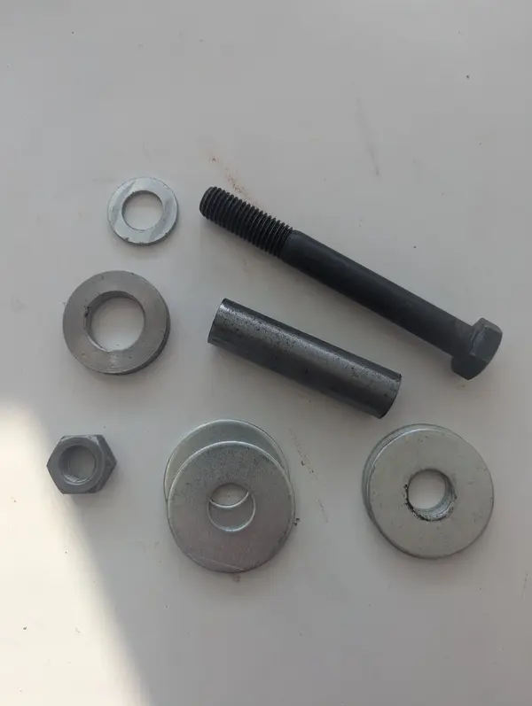

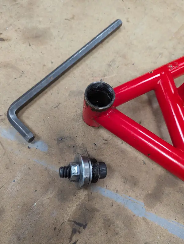

Finally..... The drive side bottom bracket cup has surrendered with some serious removal techniques! The method suggested by @27motorhead worked to a degree....but the inner tube wasn't big enough and forced itself through the hole in the stuck cup.
In the end...the technique was slightly altered with an M16 hex bolt, super glued to the inside to prevent slipping. The nut was then held in the vice and tightened with an Allen key/ leverage tube combo. The frame was then turned anti-clockwise and the cup released to a big cheer from the 2 work colleagues that had offered help.

Being honest with myself, although saving the paint would be the ideal scenario to preserve some history, the photos are far more flattering to it than it actually is. The amount of rust on this is most likely going to mean the paint will have to be stripped back to see exactly what underneath. The comment that steel frames rust from the inside outwards worries me with the severity of some of the rust.
Updates to come.....and a drop into the paint shop for colour matching before any paint is removed.

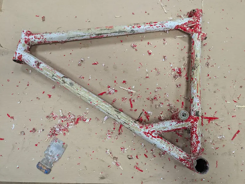

Whilst I'd have ideally liked to preserve the original paint - the surface bubbling from rust spots and damage from years of being stored somewhere damp have meant that I have chosen to strip the paint completely to inspect the condition accurately and identify any further cracks or rust holes.
I was aware that there is a crack in the seat tube just below the integral seat clamp and a rust hole above the bottom bracket shell, but was there any more hidden horrors awaiting?

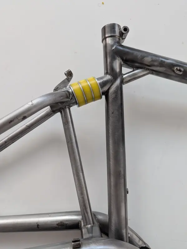

So whilst I'm slowly stripping the paint back to bare metal, I contact @fguki about the possibility of having some elastomers made that replicate the original stack on the prototype.
The 'production' Serotta Off-road Pro-flex has a single green elastomer. The catalogue and advert image has a set up more like this.
After a few PM's back and forth about requirements, sizes etc....fguki came up trumps and provided me with an excellent reproduction of the original set up.

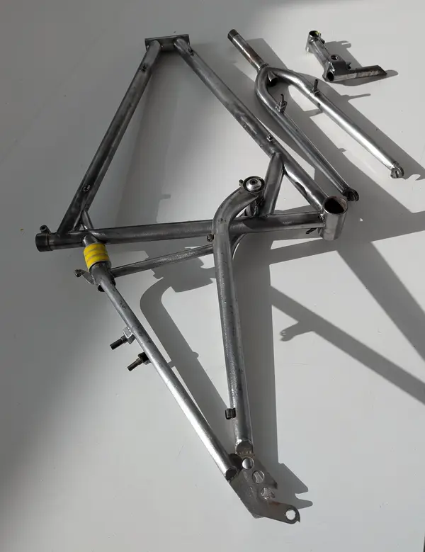

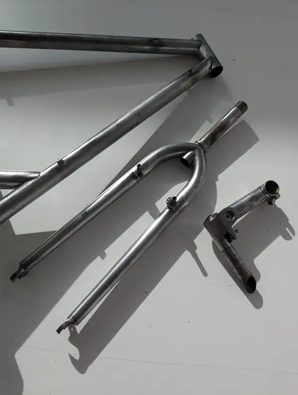

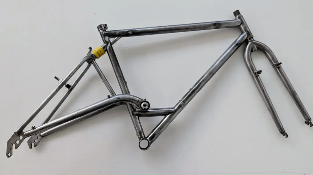

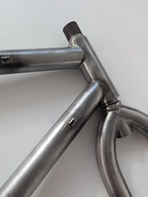

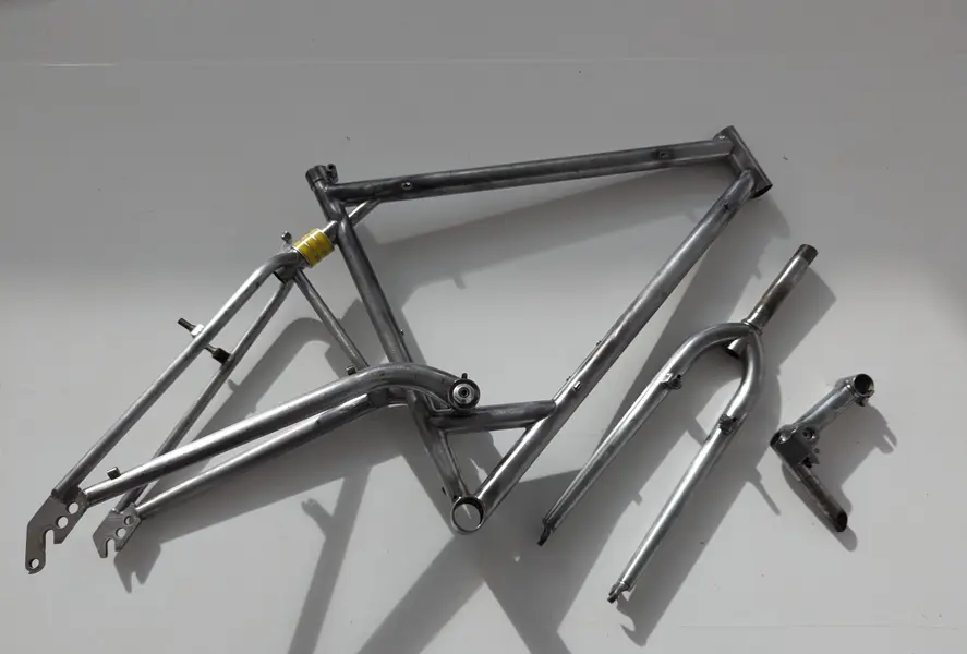

So. Here it is completely stripped back to bare metal. The swing are was reassembled to check the fit of the @fguki elastomers. Absolutely spot on!
The keen eyed will notice that I've managed to salvage the original flex-stem. There is a dent that will need filling but on the whole, it's come up far better than it's original 'as found' condition suggested.
What about the rest of the frame?

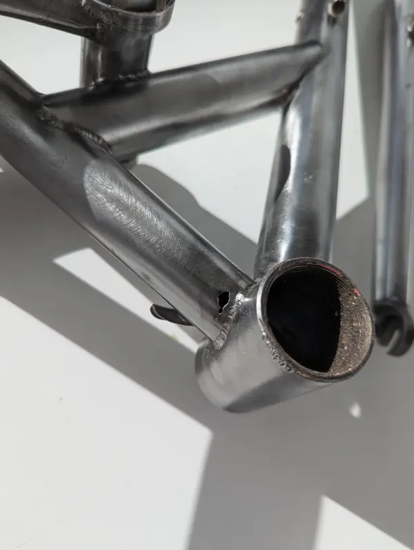

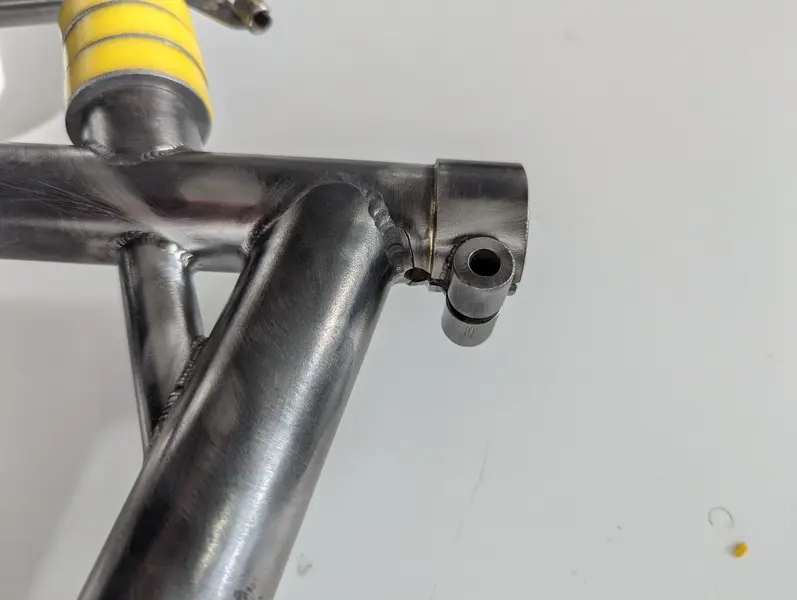

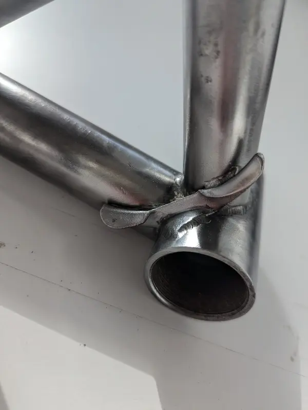

and the rust hole above the bottom bracket
Everything is remarkably sound.
The frame had been painted over what looked like a polyester primer. This had gone over and etch primer and the sheer thickness of paint had done a good job of preservation the condition of the steel underneath.
So other than the repairs needed above, it shouldn't be long before it's back in paint.

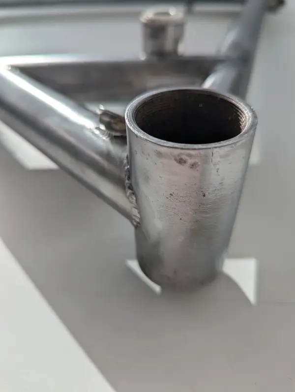

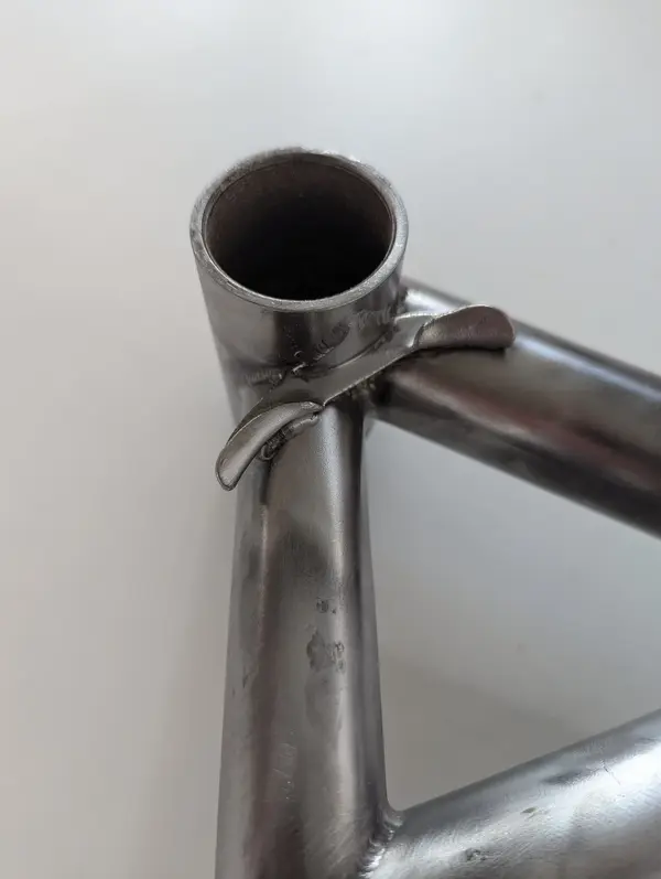

On the 'production' version, this cable guide is a cut down Campagnolo one.
On the prototype, this isn't marked with a manufacturers name. It doesn't look hand fabricated, so it's probably been modified to what was available when it was being welded up.
The shape of the weld to the bottom bracket shell is more 'triangular' too.
No frame number on the bottom bracket shell either. The 'production' has a 00xx code.
