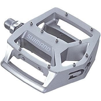

For a 90s bike i'd go for Shimano DX or Easton DH.

I just measured a few pedals I own for reference. Measurements are from crank arm to outermost edge of pedal.
Shimano DX 112mm
Crank Bros 50/50 107mm
Wellgo B37 111mm
Deore XT M730 98mm
The top three are so close as to not matter much in practice. What does matter is the shape, the DX are nice and concave and the widest, but the 50/50 are more square along the edge. So even though they are a bit narrower, their width is more constant which might make a difference to you.

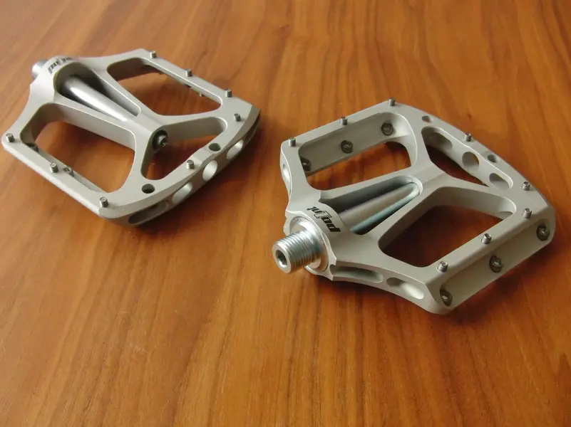

if modern, try these:
podium by point racing
i believe they r 10x10 cm and something like 11mm thin
