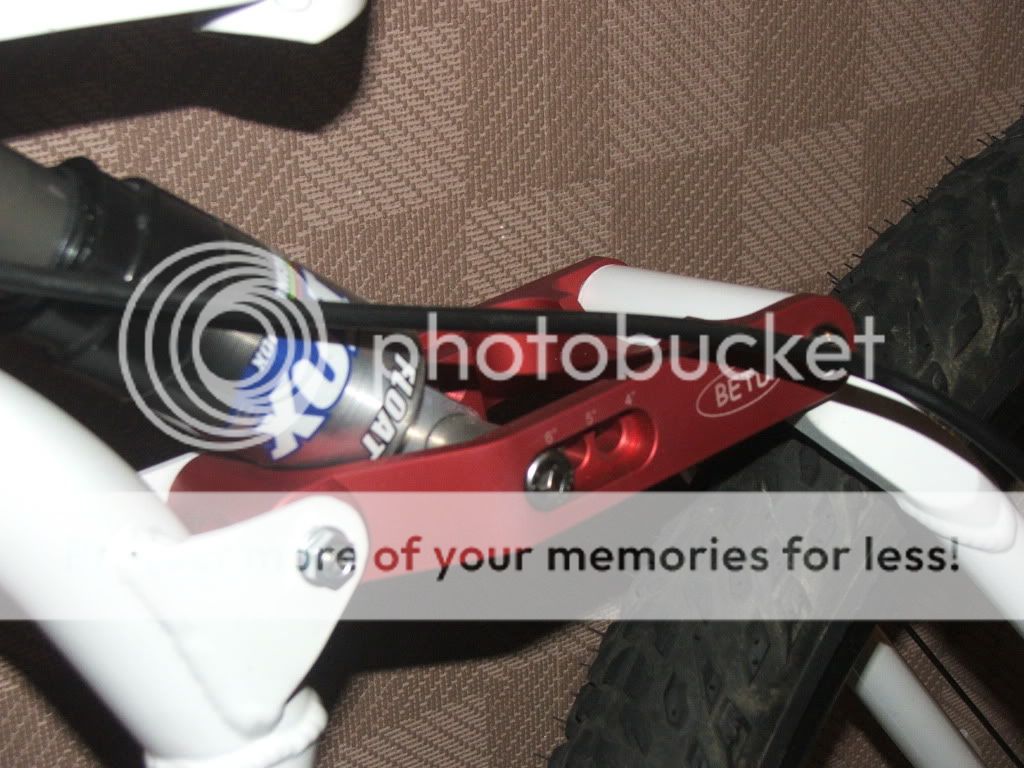

Anyway back on track, FSRs are a joy to ride in standard guise especially the older ones pre 2001 and are a beautifull bike to look at at any vintage, the BETD linkage is this......
made by BETD a company that also manufactures and sells the Goldec brand reducers so a guaranteed fit if you need them, I cant offer any help in choosing which FSR to go for as I have only ridden HT bikes before building my FSR so would keep watching for a post from someone :wink: who has ridden old and new

The BETD linkages are definitely worth it - adjustable travel (120-150mm in my case), better bushings, slightly raised BB, and a stiffer rear end.
Here's how to fit one:
http://www.singletrackworld.com/forum/topic/review-betd-linkage-on-a-stumpy
And here's mine now....
