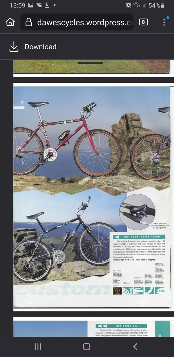

Of course when dawes still made bikes in , they might well have knocked up some pre- production models to see how the market or management took to them.
A toptube gear boss is not an original idea in 1993 -
As @Rod_Saetan pointed out earlier.

So it looks like dawes were putting a left hand shifter boss on a few 653 frames- although ican't see it in the catalogue.
Possibly allowing the option of a little weight saving as in the synthesis photo - the function of rf+ STIs yet to be realised as they were released the same year.
Some professional time triallists still used a frame mounted front lever with handlebar sti 20 years later.
By 94 the benefits and lighter weight of RF+ would be understood imo.

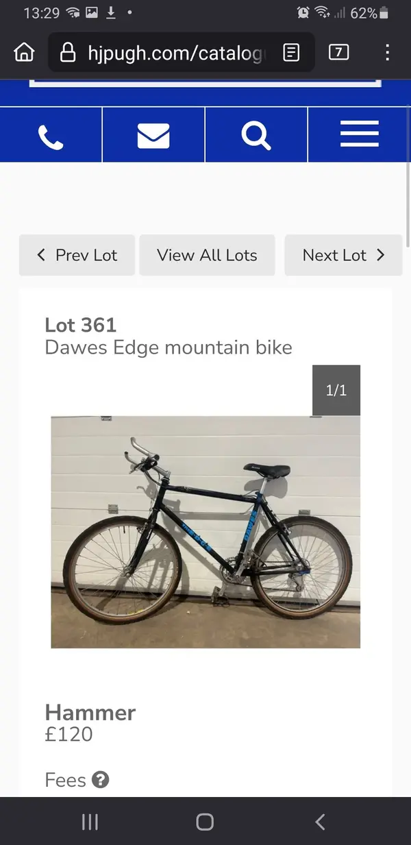

picked up from pugh Country auction in ledbury-
