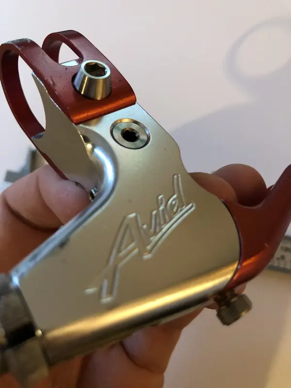

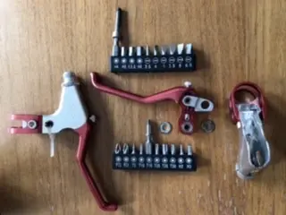

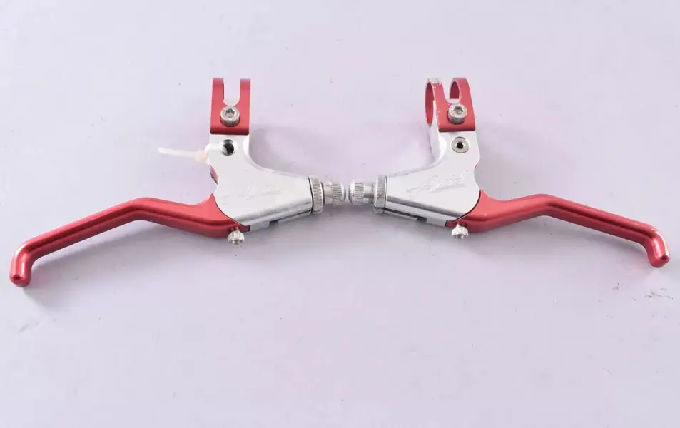

I have just today taken delivery of a much searched for (+3 years !) pair of red/silver Avid Ultimate brake levers, at less than the price of a house.
Only catch is one lever is missing it’s pivot bolt and 2x washers. Also both bar clamp bolts need changing to be the correct cone top type.

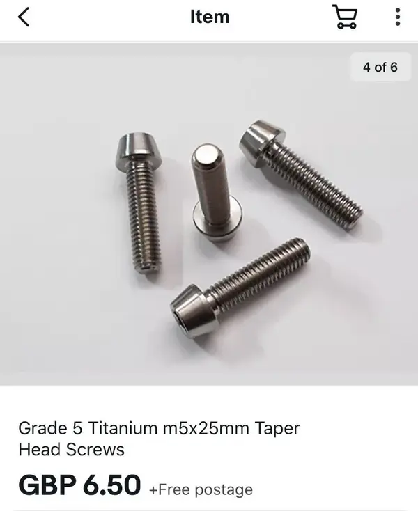

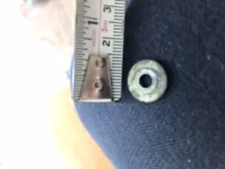

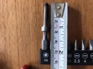

Hi, the H4 bolt is called a taper head and from the picture you need M5 x 25 or M6
The other is very rare and probably from aircraft type, you may need to talk to suppliers or have one made.
Hopefully you can find what you need by searching for 'shoulder' bolts. The shoulder is the unthreaded part, usually thicker than the threaded part. I discovered this when looking for bolts to slot through bearings.
If you need the bolt to be the same length but not fully threaded you want a partially threaded bolt.
Hope this helps.

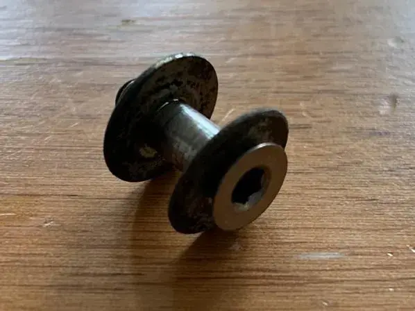

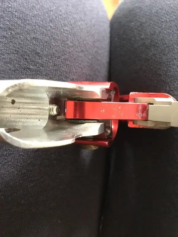

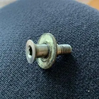

No bearing as such. Just that bolt and washer acting as the pivot/hinge going through the raw handle hole. Hence attempt to get exactly correct size or if am 0.5mm out will end up with rattley loose handle.
Agree a counter sunk Threaded with a Shim could work and be more future proof. Just the washer needs to be right at the top or won’t all squeeze back in. (See pic)
Will try get the exact shoulder bolt first, but currently looks like will be around £20 for a pair, so if not quite right and have to repeat order. Could easily get towards price of a donor set in no time !

So the cone M5 titanium’s turned up and fit the clamp perfectly for £6. Whilst half the bolts shafts middle section should ideally be smooth with just a threaded tip, but once on the bike you can’t see it internally anyway as it’s typically up against the bar grip. Could easily file it down later on if desired.
