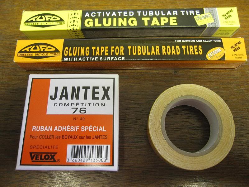

It's not properly retro, I suppose, but I always use tub tape rather than glue. I have a selection of makes:
Maybe French Jantex is the closest to original, and right for a French frame. One roll=2 wheels £3-4...Good retro packaging too :wink:
Velox and Nutrak sell a very similar product, but personally I use the Tufo extreme, which sticks like s*** to a blanket straight away, and has the plastic carrier tape, which makes it far easier to use than the paper systems...a bit more expensive though (1 pack = 1 wheel £6 ish).

mmm...I don't know any Italian tub tape...it'll have to be Vittoria glue instead :wink:
