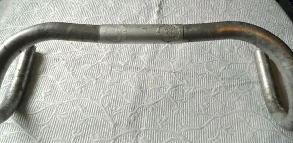

Wheels finished. Passable but might benefit from another polish later. Bought a better set of bars on here for £12.
Cables next. Seat post and bar tape to follow. Still waiting for campagnolo gran sport to arrive.
