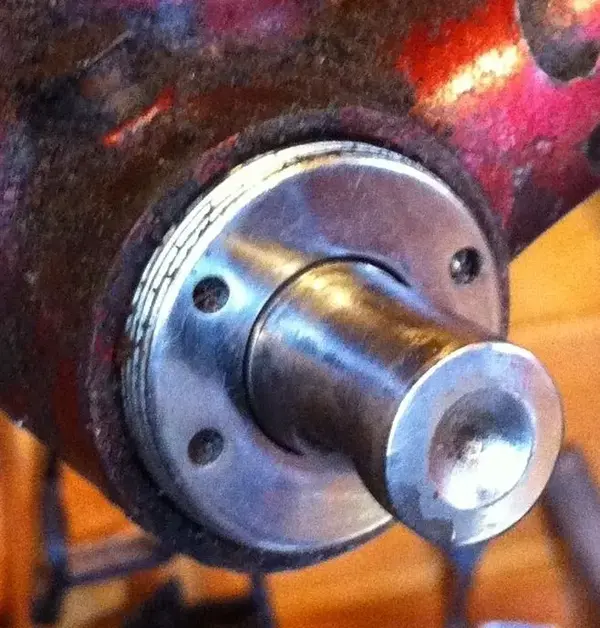

Presumably there's a tool to get this out? Standard size or do I need to measure anything?
Also presuming loose bearings so what size do I need to renew? Help!
Other than this came apart easily. F&f weigh 7lb saddle without stem weighs 1.5!
Is that a grease port top left or for oil in same way as my old lathe?

So do I use a punch or get a tool?

That is an oiler on the BB tube, not a grease nipple. If there is no play in the axle, I would start by bunging some light oil in, not sure what sort is preferred, maybe 3-in-1? You might find the bearings smooth out without disassembly.
If you must undertake the surgery, finding the correct tools would be best! You'll find the bearings have reference numbers or sizes on them and maybe a maker's name. Obtaining replacement bearings should be easy. See here for instance http://www.ransomeandmarles.co.uk/references.html

Will use the same oil as I use for coronet lathe bearings before each use. Hopefully I won't have to go further.

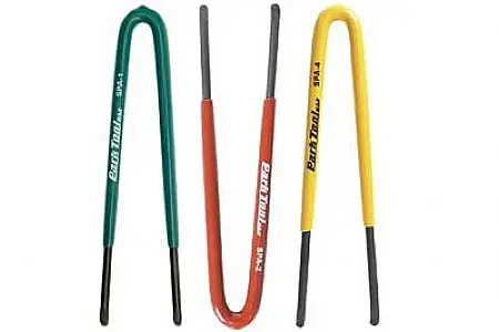

All you need to remove that cup is a bottom bracket spanner similar to the one Park makes. it is somewhat flexible so, as long as the pins fit in the holes, it will work with different models.
