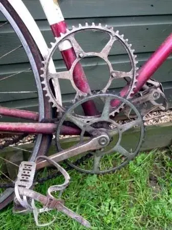

No markings on bars, Brooks saddle. What should i use to soften it up?
Was also given another chain ring with three squared bolt fixings

Re: Armstrong 1953? Help/Advice Requested Please
very cool indeed, one of the aspects of finding an old bike that has sat for a long time are the little details like the Shell Oil key chain. The rear mech could be a Cyclo Benelux, I can see a CLO but cant make out the other letters

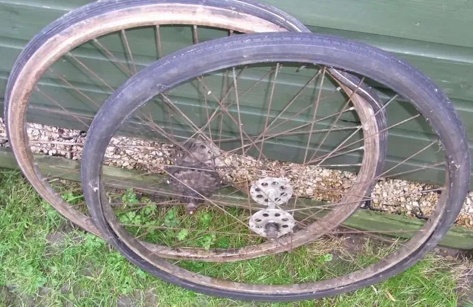

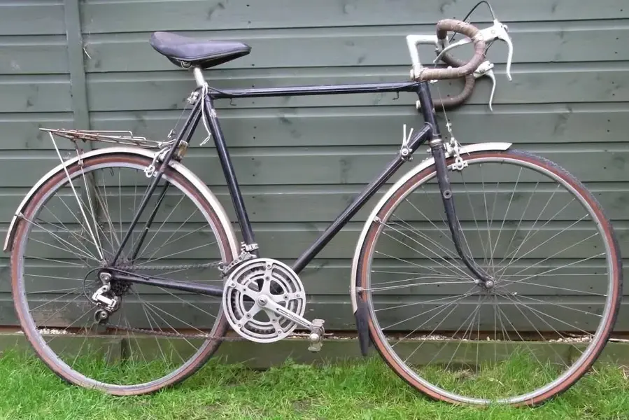

Where to start. :facepalm: Have photo documented so now I should carefully strip it? Everything soaking in WD40 at present. A bit daunting.
Was also given another complete raleigh but much later, a couple of pairs of wheels and two NOS chains still in their boxes.
The Raleigh will wait...........
i dont mean to put a dampner on things but you are never goingto fit that bike. after meeting you at the brewery ride and seeing your marin with a huge length of post sticking out you are going to struggle. and at a guess you are over 6ft tall , a 23 inch road frame would have given you a chance.you can still make it a nice bike ,but as a rider it is not going to happen
Re: Armstrong 1953? Restoration Help/Advice/Abuse Please
It is a 23 inch road bike :D So is the raleigh. forgot to put that in. Armstrong 26lb Raleigh 29lb as is
This will be a labour of love and will come out on high days and holidays for retro pootles perhaps? I think I should be able to squeeze on a 23inch/58ishcm with my short 32/33inch inside leg. (my body is disproportionately long for my 6ft3ins!)
Well that's the plan.
That's exactly the sort of thing I need to know though so thanks for your advice.
"And I mean that most sincerely folks."

The Armstrong looks pretty glorious, congratulations. A 50s machine clothed in parts it received early in it's life is a happy find.
It seems to have horizontal dropouts for derailleur gears but no cable guides or other braisings for them. The mech might be a Cyclo Benelux Mk7. I think it is.
http://www.classiclightweights.co.uk/cyclobenelux.html
http://www.disraeligears.co.uk
Getting them working is a challenge but achievable with perseverance.
The GB Coureur brakes are desirable. The steel stem is one I don't recognise, which might be a good thing. Are those handlebars original? The Maes type bend looks quite useful. The saddle looks in good nick!
I think flip-flop hubs were popular in the day. My 1951 Harden hub is the same.
