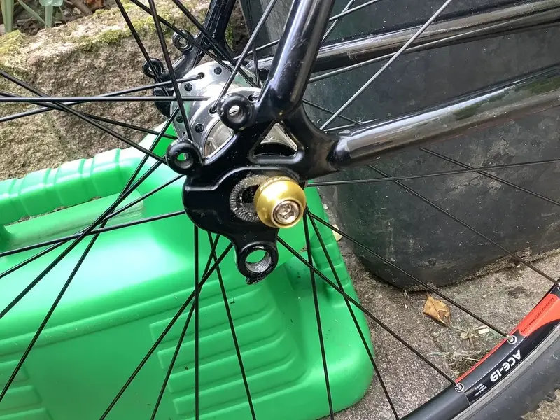

That's plenty dropout length for ss. Just fit a narrower tyre like a 1.9 - 1.75. Remember with ss you are out of the saddle so much you don't need the bounce of a fatter rear tyre. KISS - Keep It Simple Stupid

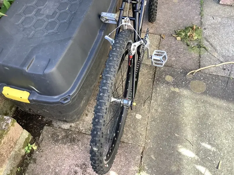

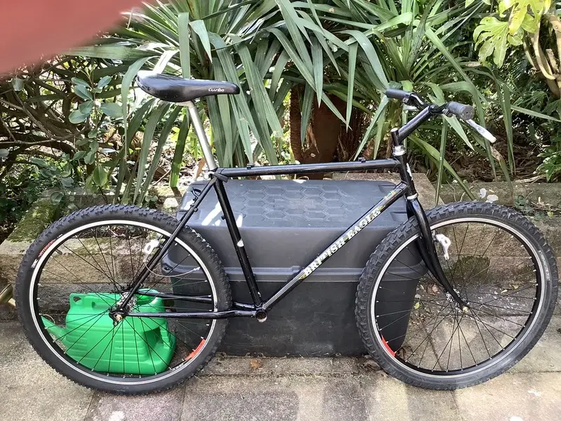

Progress made...although slow because of my tendency to want to clean/polish every component prior to fitting...
Tyres swapped, plenty of clearance now even with the wheel fully forward in the dropouts. A matching front tyre would look better I think, anyone got a front IRC Mythos XC 1.95?
Polished the seatpost up. Was a “post modern” but the logo was sacrificed to the god of shiny. It’s a 26.4 and pretty much falls straight in. A 26.6 I have is very tight... will do some measuring at some point. Not sure where the clamp came from, it’s a Miche.
Saddle (got it karma on here) boot polished and fitted.

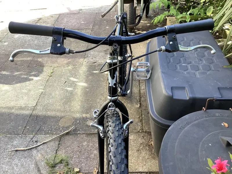

New cheap (£8.99) eBay bars. Look good in the flesh but in the pic the rise looks a bit wrong. Better than the rusty heavy ones that came off, but we’ll see.

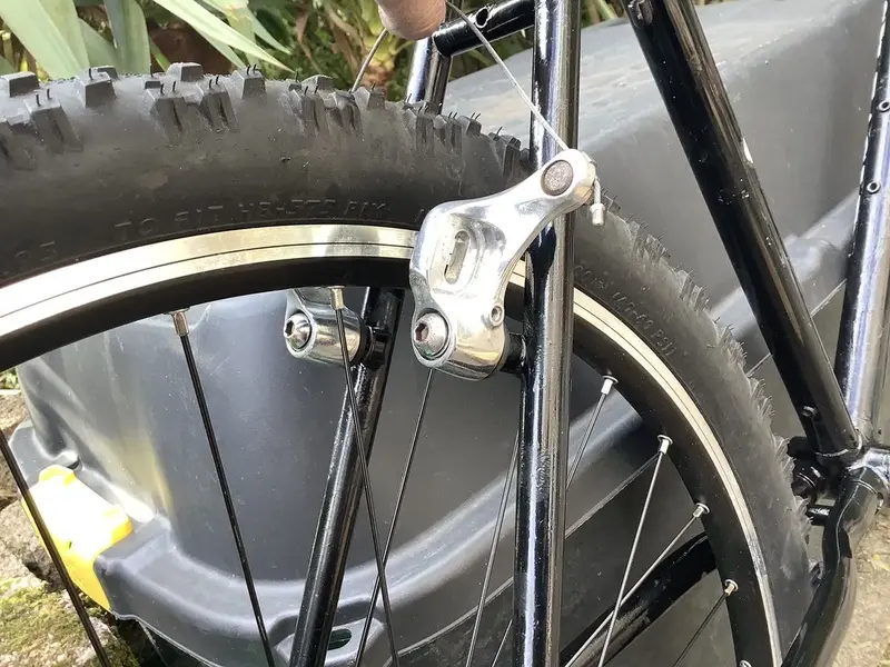

Loving the brake set up - polished up a set of lx550 I’ve had for years and fitted some nice chunky Lee Chi levers. I might use some new v brake blocks on the cantis - looks like they should work. Not sure I have any hangers, will have a dig...
Grips and stem are original...resisted the temptation to fit a tioga t bone prestige... maybe if I get the frame painted.

I like the way this is turning out! looks like it's going to be a whole lot of fun ones it's done! and the tyres don't look like they don't match - I woudn't worry about it
As previous poster said, tyre difference only noticeable to super critical bike snob. Anyway BITD fatter front tyres were common for a wee bit more cushioning and better grip when steering. Plus Single Speed is anti-establishment so why conform to the norm ?
Looking good by the way ;-)

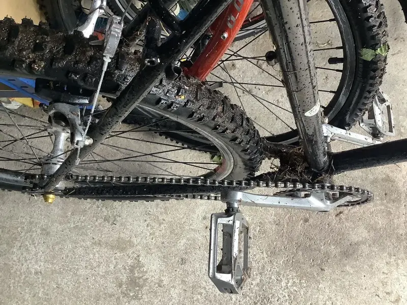

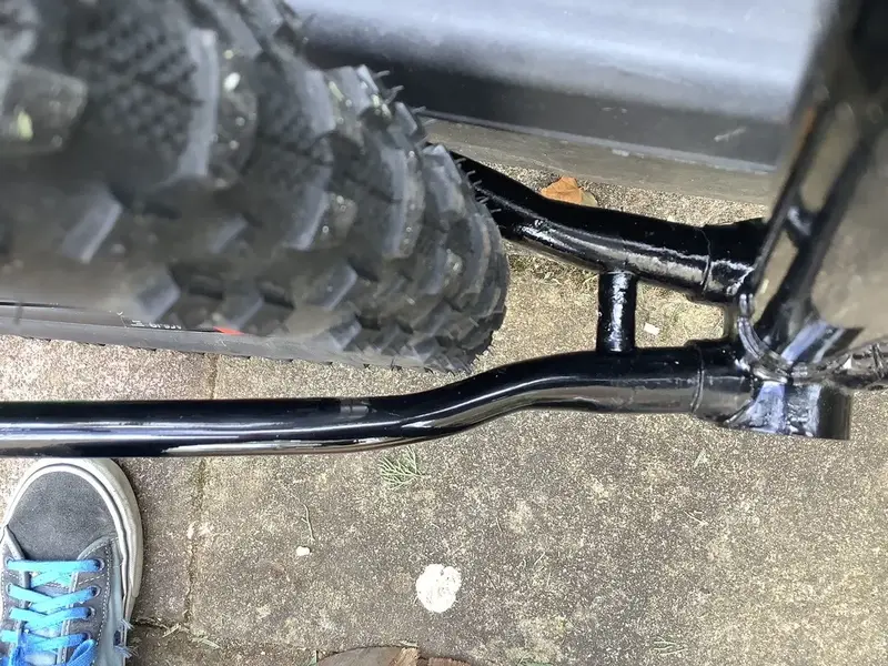

Hmmm... pretty tight for clearance, wondering whether to try a smaller tyre, another link in the chain, or just cross my fingers... still, getting there! Could try a half link chain I suppose.

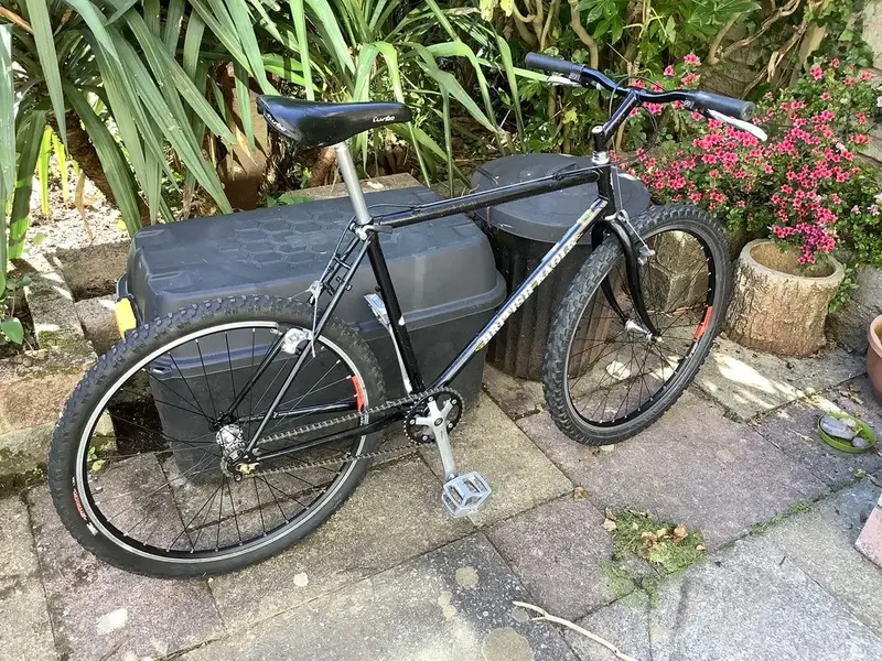

Pretty much done! Cabled up, ridden it round the garden. Feels good, like an overgrown BMX 8)
A few jobs to do:
Adjust/tighten headset.
Tweak brake setup. Why do old cantis never centre properly? Maybe I’ll try a brand new set of springs this time...
Fuss about rear tyre clearance. Maybe buy/fit narrower tyres.
But it’s all together and looks great I think.

Have taken this out a couple of times now and I’m well pleased with it. It’s become my go-to ride for larking about with my kids in the local park! Definitely wouldn’t be without a single speed mtb now, it’s light, drivetrain is silent, and there’s very little to go wrong. Looking forward to trying it on some more challenging trails although there is a limit to what I can climb on it! Gearing seems about right though, it goes up most hills ok and I don’t mind the lack of top speed.
The 531 frame feels nimble and comfy. Definitely a quality item IMO despite the lack of cred. Would buy another at the right price.
I’m still in two minds about the tyres, would like a smaller one on the back as I’m nervous about the tight clearance, especially in combination with a QR axle and skewer holding the back wheel in the dropouts. Will see how I go once the drivetrain beds in - if I could slide the wheel back a bit I’d be happier!
As someone else suggested, the large front tyre works well to soak up bumps, although i’m not entirely convinced by the tread pattern.
I did try new springs in the brakes but still couldn’t get them perfectly centred. Still, they stop it nicely and don’t rub. I should know better really, in my experience you have to be able to accept some compromise with cantis. Which is why I like V-brakes! :oops:
Glad I built it!
