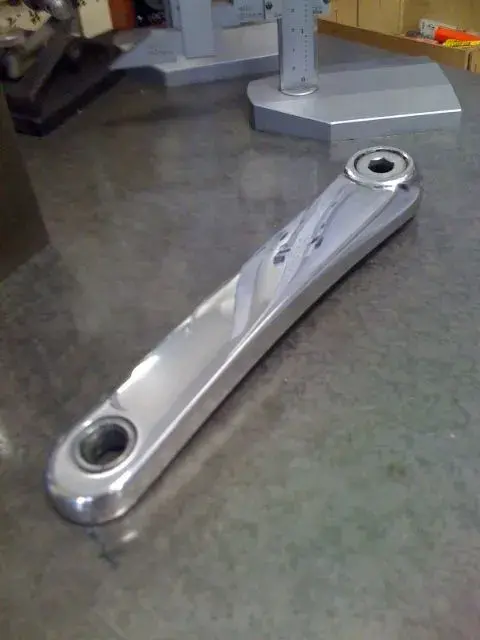

On an unrelated note, I just made a start on cleaning up and polishing a set of Bontrager GXP Track cranks.
Here's what they look like stock, black, laser etched logos and a ridge round the edge:
The plan is to make them look like SRAM Omniums:
Heres the LH arm so far:
Mmmmmm shiny cranks. 8)
