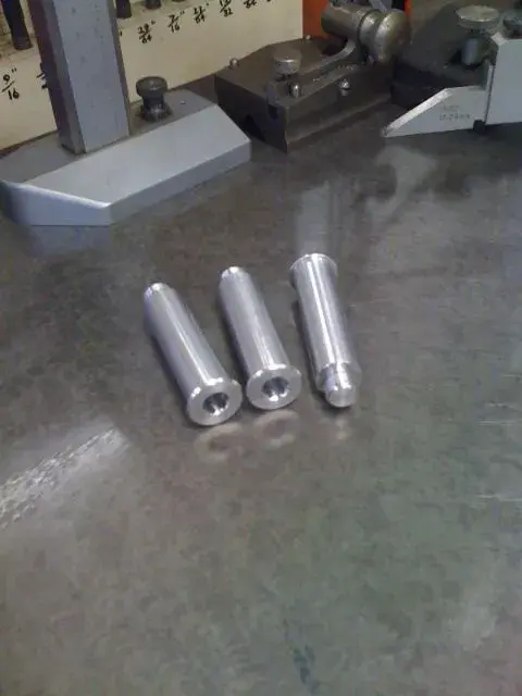

Just finished a couple of replacement pivot bolts for a Psycle Werks Wild Hare:
