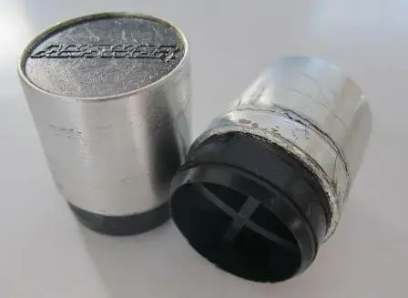

It's a guess but the bars could have been fitted with Answer Hyperends of some sort. I'm sure you're familiar with them but if not....... they're held in place by an expanding wedge that fits inside the bar; that might explain why the plug has been pushed in.
I think you'll need a cork screw to pull yours out but I have a spare set you can have. I bought a bar that had been fitted with a clamping type of bar-end and as you can see the ends were crushed/split so I cut them down and as I'm using Hyperends I didn't see the need to push them back in.
