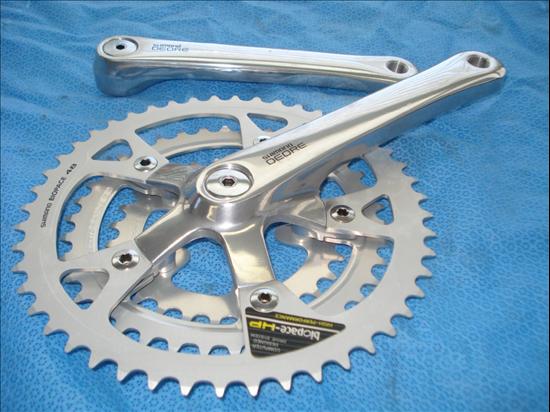

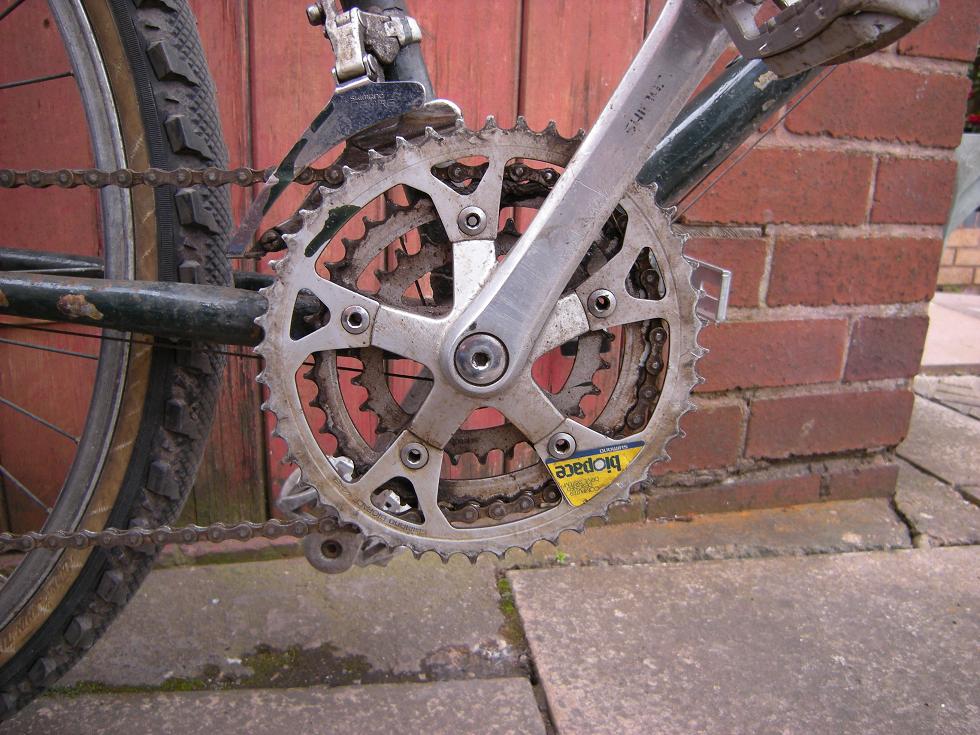

The chainset is clearly not the MT-60 as this remained the same throughout until the demise of the DX groupset. It resembles the FC-6206 used for the MTB and the Deore Touring groupset but finding out anymore than just nice pics is proving difficult. It dates the bike to around 1986.
The bike is very nice and I want it but there is a queue forming...
Weeman:
FC-MT60:
FC-6206:
That was a bit lazy of me to make the MT60 chainset gaffe
I have a mint one in the retro-stash!

@LGF, the cranks are the one thing that I didn't find the stamping on, the other parts I did. I'm going outside with a torch in my mouth now to probably prove you right.
The left hand crank has some nice hammer marks on it from some tw@t without an extractor, I hate to see this sort of vandalism :evil: .
