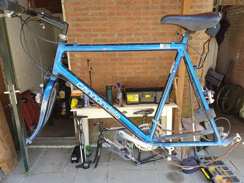

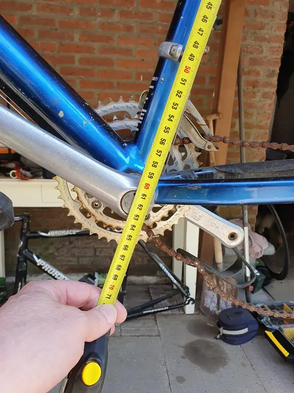

I do own this MONSTER of a bike. It's a whopping 24,5 inch from center top. (62cm)
It does measure 56 - 22" C-C , was this normal for the 92 line-up?
The paint is shot, but that's fine.
I assume that's a 1 1/4" pepperoni? Looks fat.
(can't find my calipers)

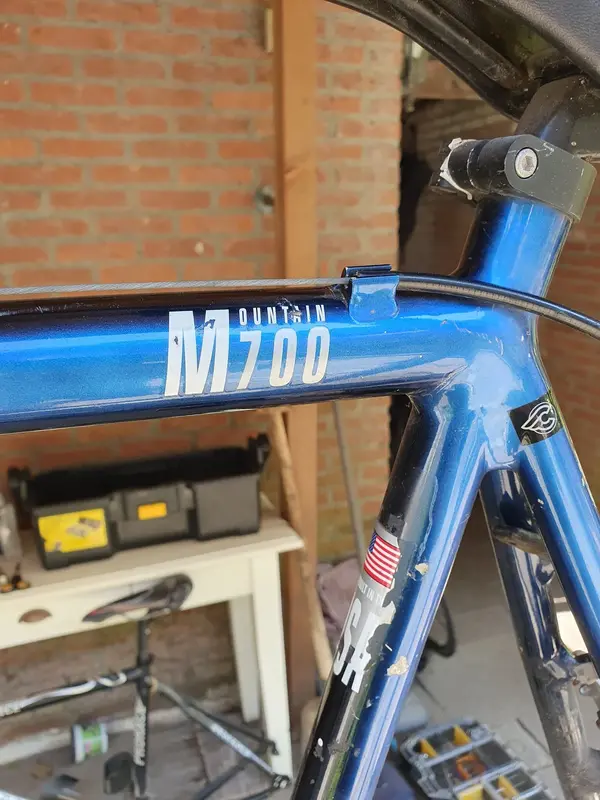

So if I wanted to use this frame, which I very well might.
Is the Nitto MTC-023 really the only option and not available in the EU?
Surely not.
Needs a new headset, I loved to see that the 1 1/4" headsets are twice the price from the 1 1/8" which already are 80+ euro's 🤪
Also worth noting that cannondale often updated the frame fork combos mid year. So between 95-96 you will see frames with pepperoni forks and cantelever chainstays rear stays/drop outs in the catalogues. The reality is that those bikes came with p-bones and normal rear dropouts as pictured above.
