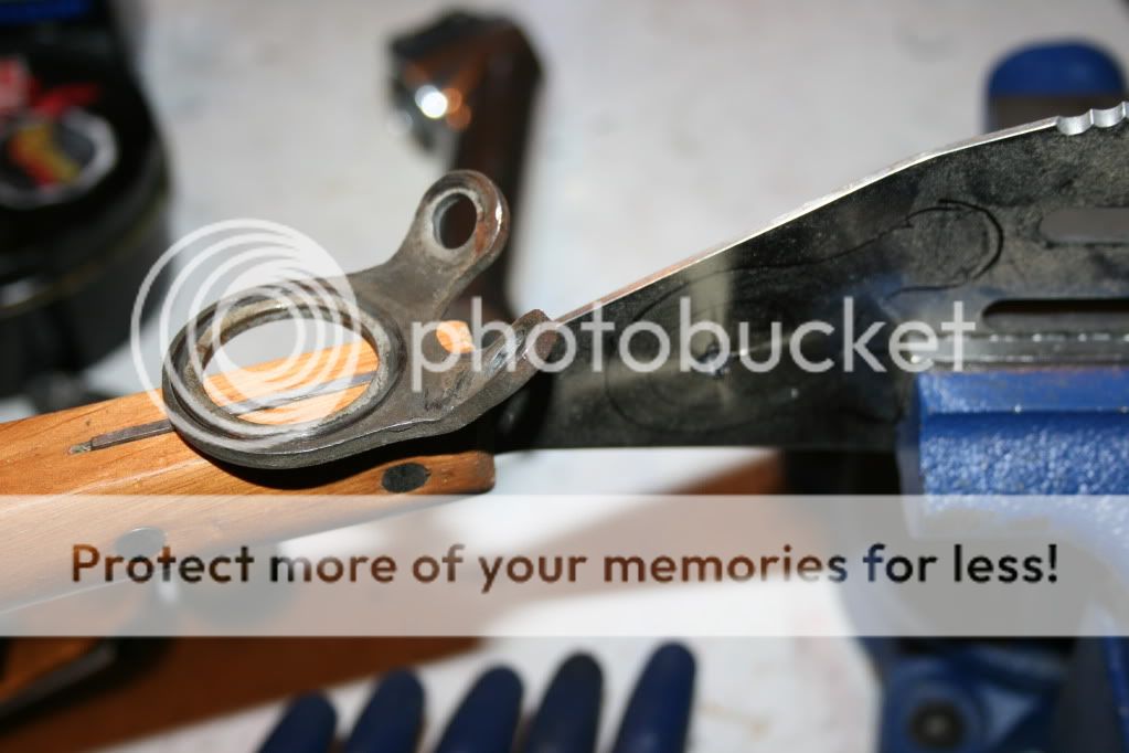

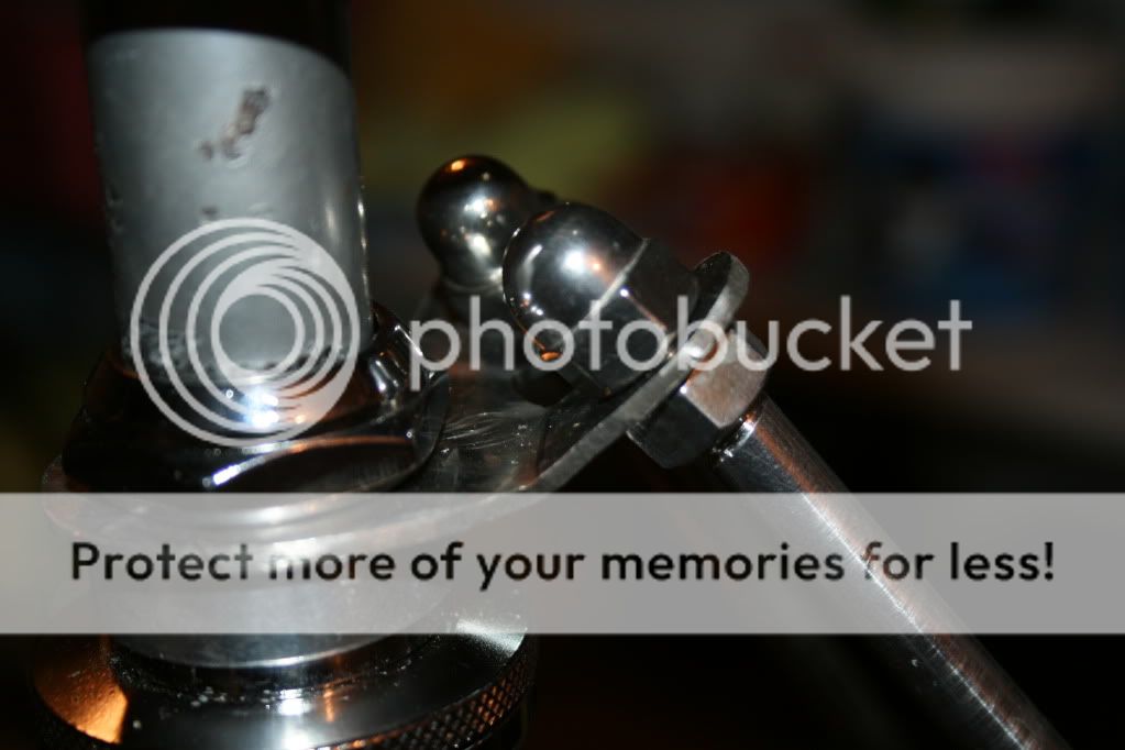

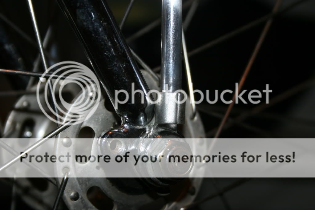

I am a systems engineer (Computers) For the truss rods I did not feel like paying a stupid amount of money for a clamp so I just made a copy out of a huge stainless steel spatula that I never used. I bought some electric grounding harnesses and some cap bolts from home depot. Total cost about 8 dollars.

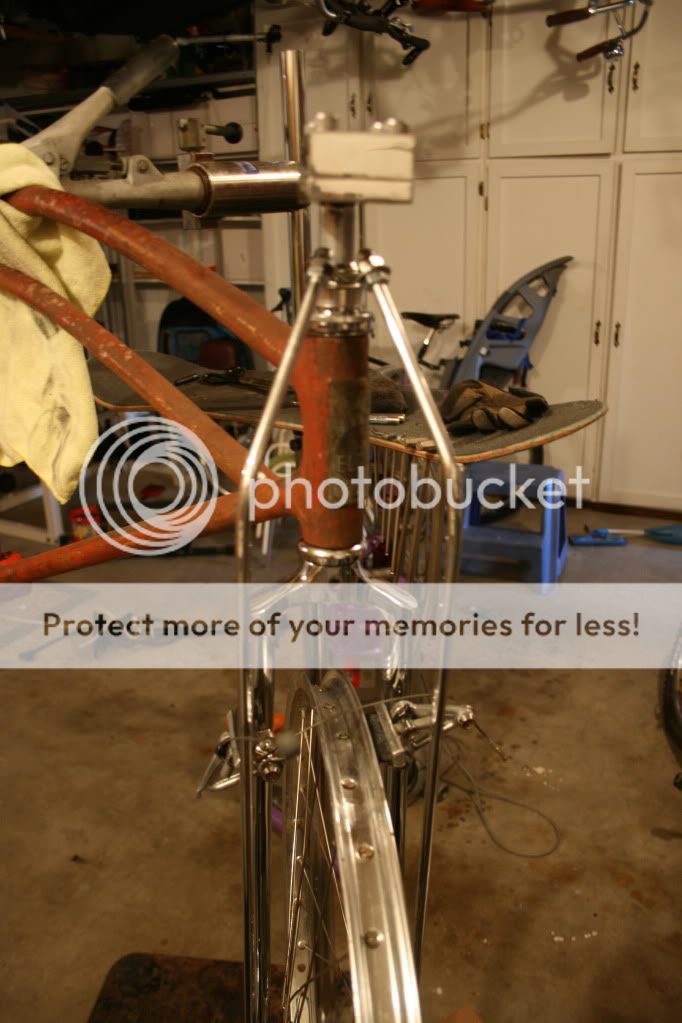

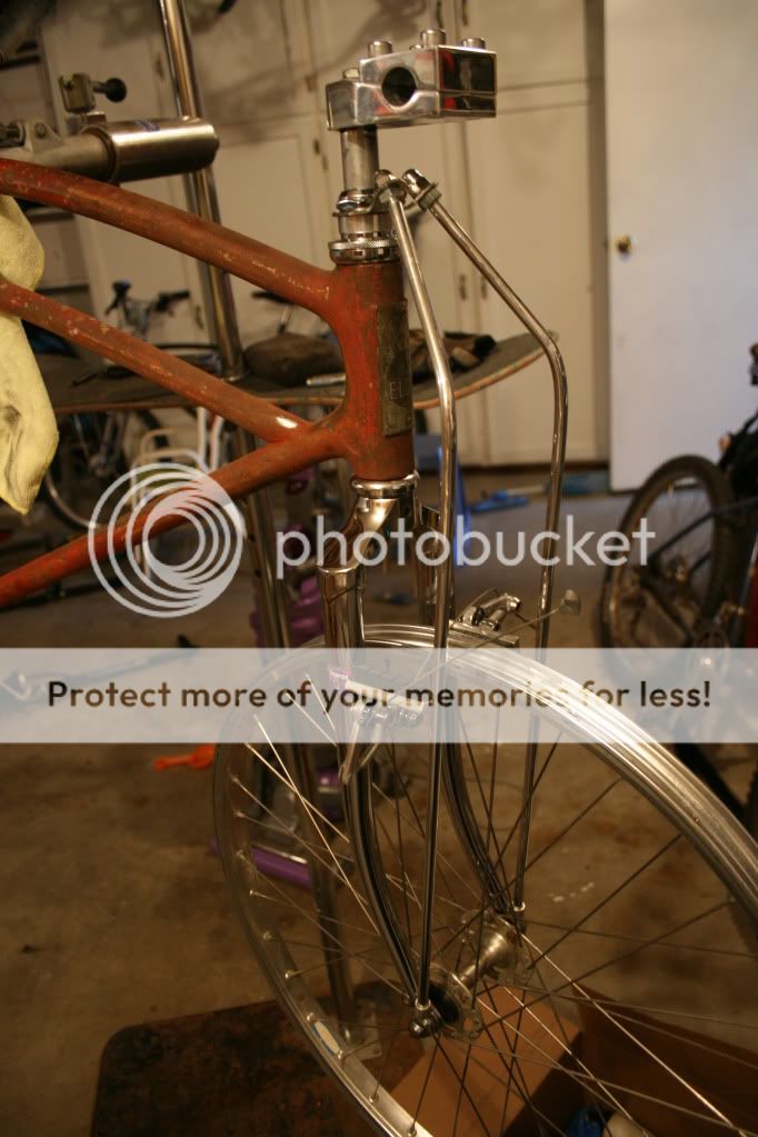

Following with great interest. I'm curious what the trusses are for? Suspension? Extra rigidity?
On the original bikes with bladed forks they offered additional stiffness. On this bike they are nothing more than a style element. The Tange Champion fork I am using is one of the strongest forks you can get. I made the truss rods so they can be easily removed if needed. I do plan to get the frame painted because the steel is showing through and it would rust away if left unprotected. Maybe I will get you guys to do some photoshop paint schemes for me.
