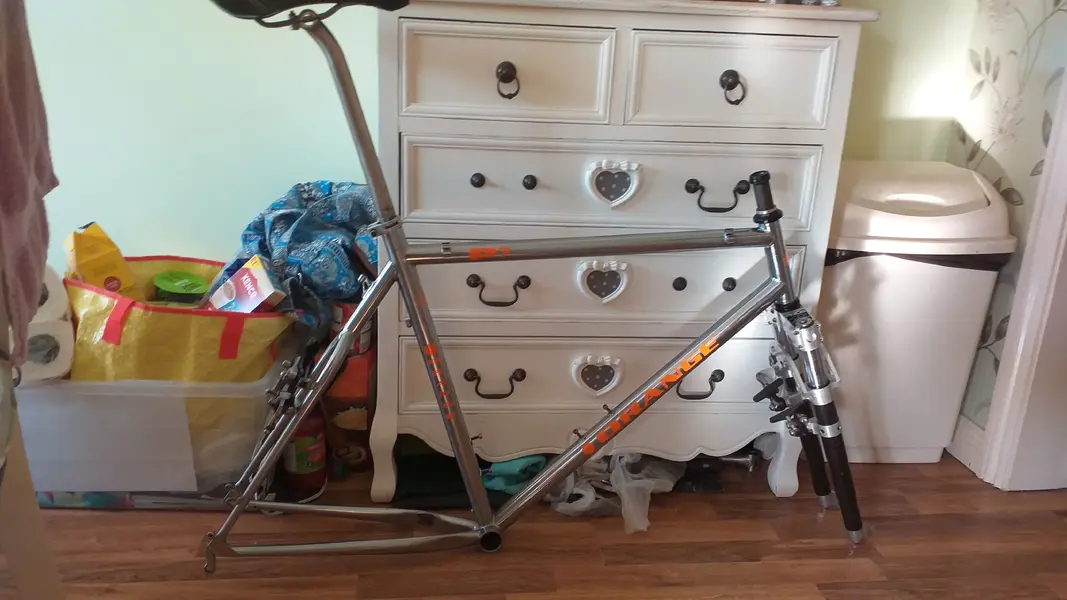

I brought this 19" c 2c or 21" c2t 95 p7 frame several months ago now .
My aim was to restore/ build it to good standard .
I wasn't aiming for a mint bike with exceptional components.
Just mainly using the doner bike for most of what I needed .
My only indulgence was an xt 737 crank set .

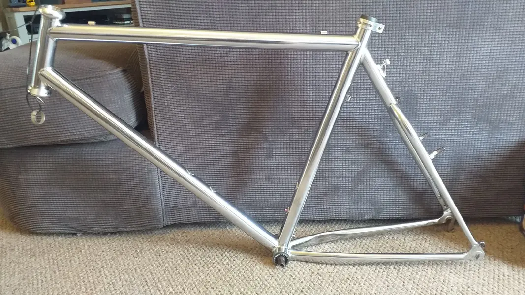

1st I stripped the old flaky lacquer off and the relacquered the frame with 2k etch laquer

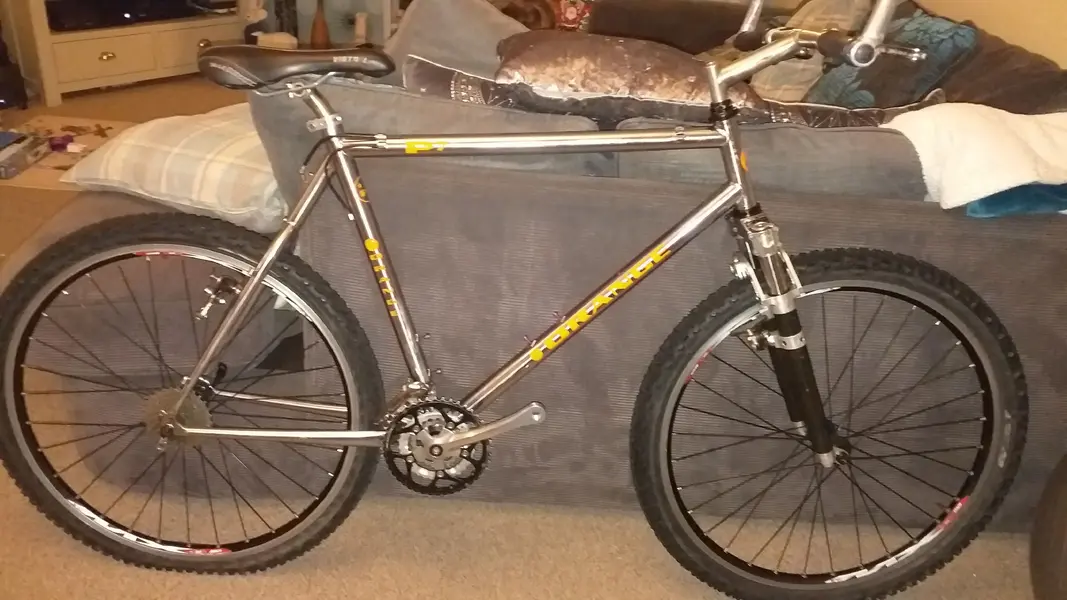

We're getting there

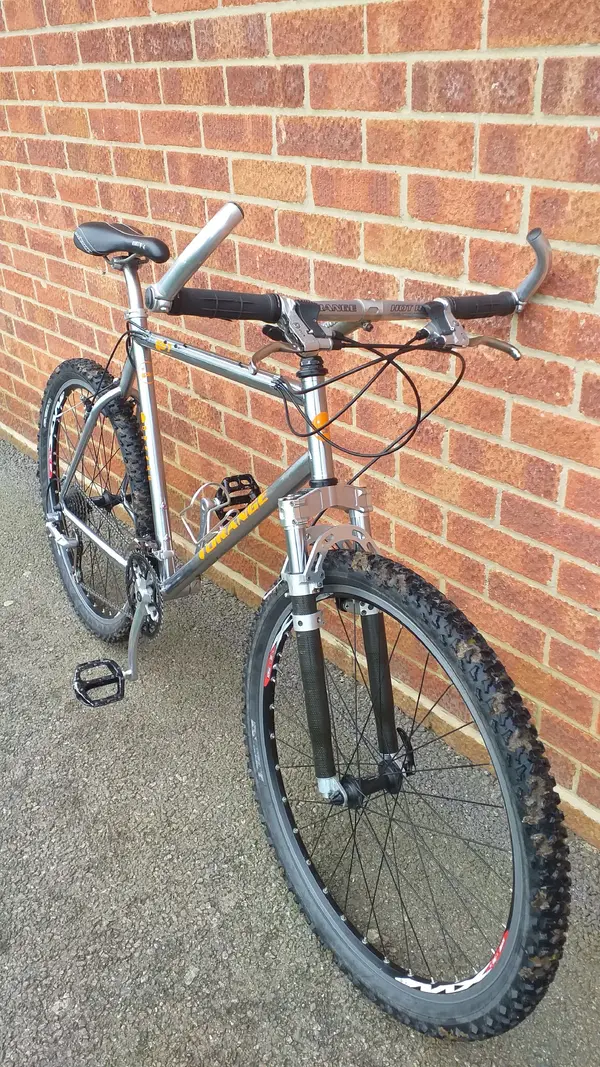

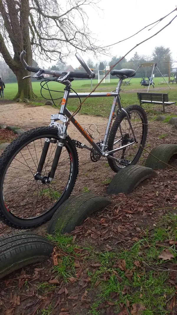

Finally finished it today and had a great test ride

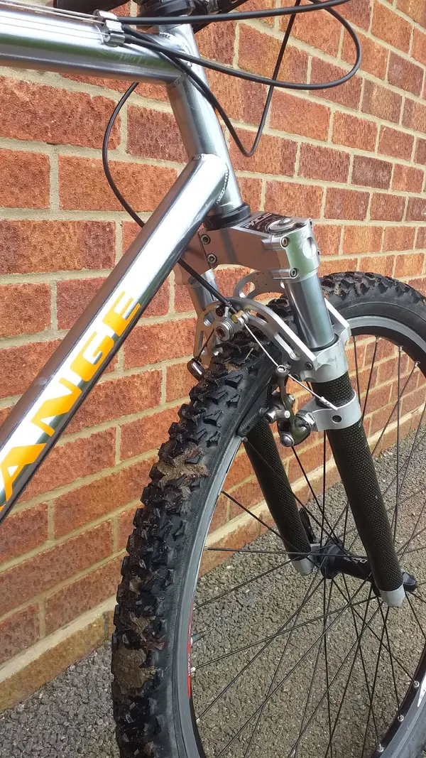

Re: Another 95 p7 build ........ no chair required

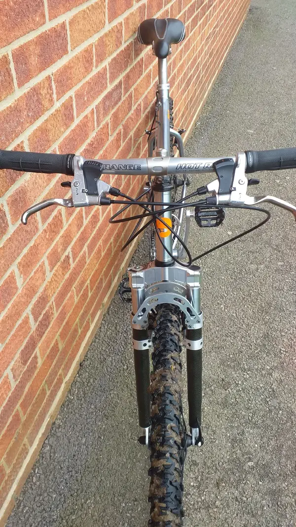

Nearly done

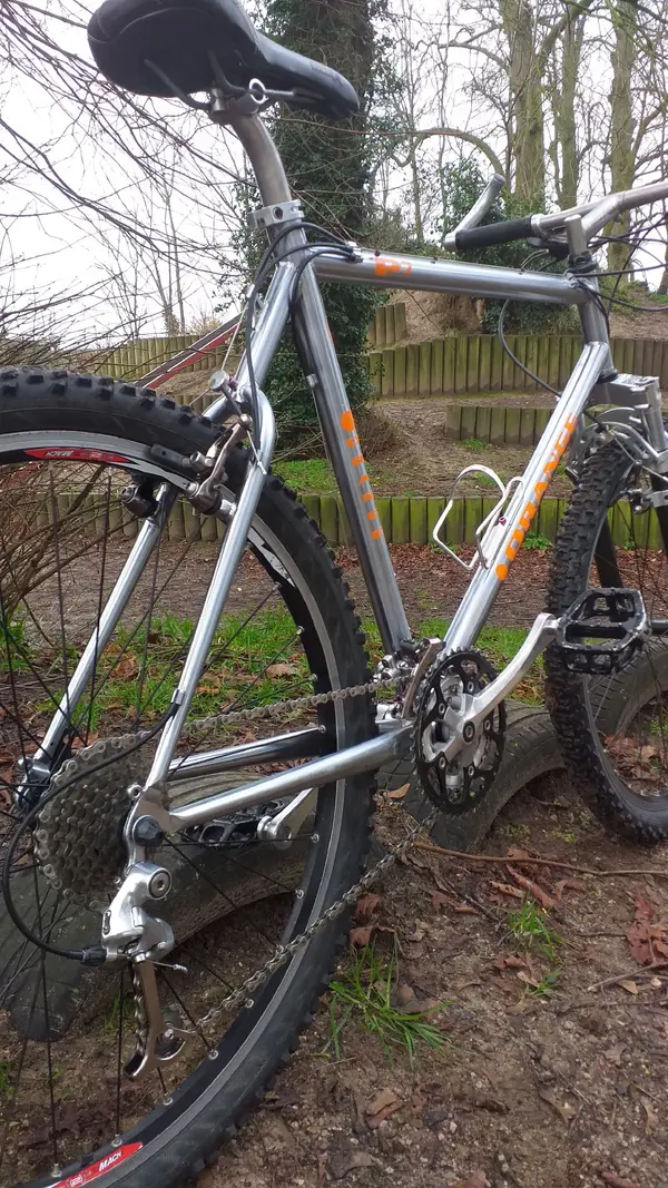

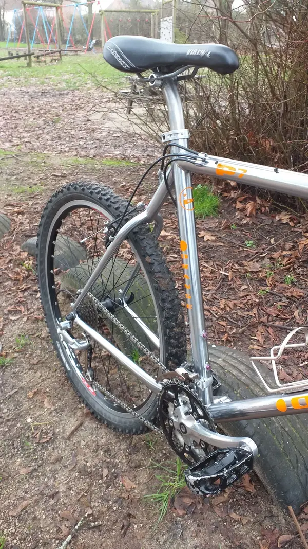

Thanks guys ,
Sorry It was so long winded .
I'll try harder next time :xmas-wink:
