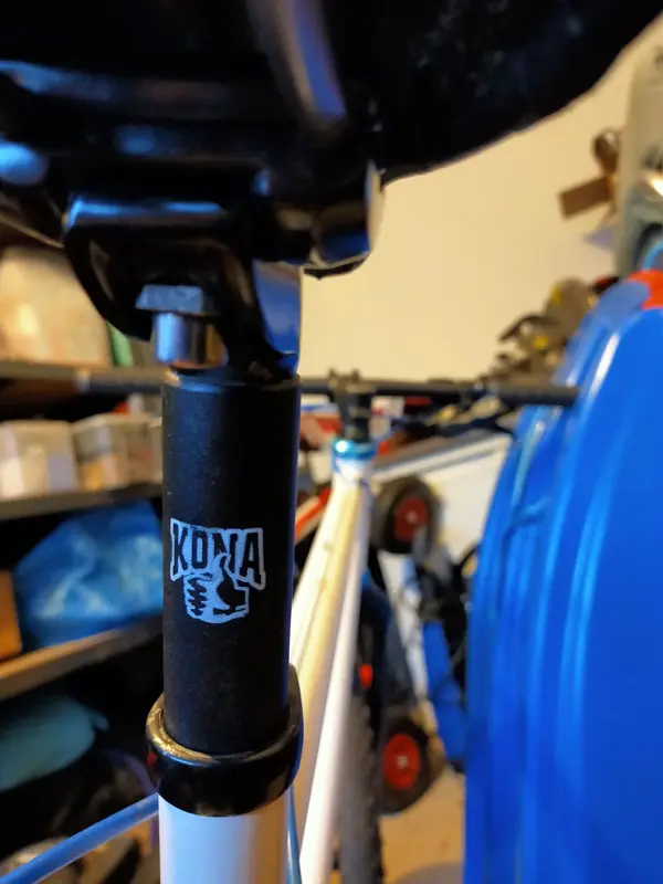

Kona branded black seat post, I don't car that it's heavier than the kalloy, some things have to be done:

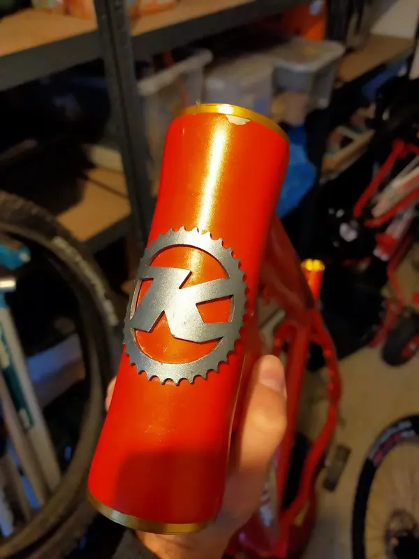

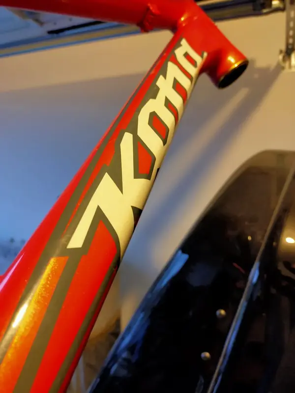

And the Kula Gold 18" frame really is a beautiful colour:

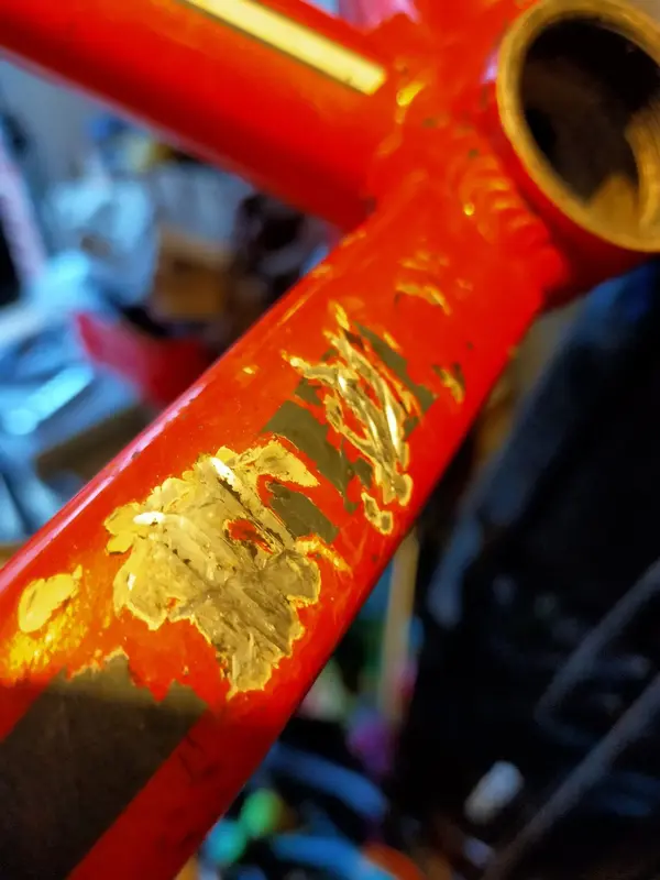

Bit of chain suck damage to the stay but generally pretty good. I believe it's a 2011 and it looked pretty well specd up
2011 Kula Spec
