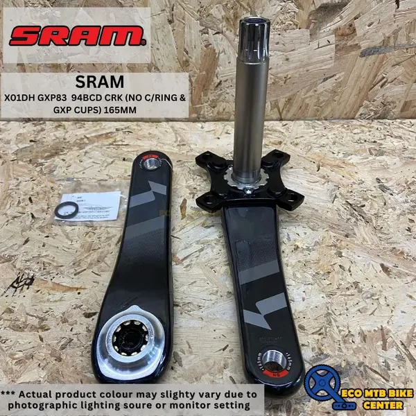

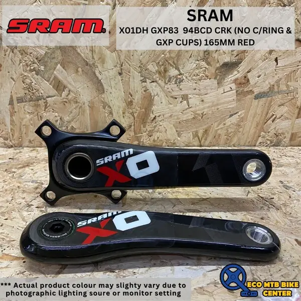

Picked up these new old stock crank arms for a reasonable price online from... Malaysia of all places.
The only problem now is, all my 2 or 3 existing chainrings are all 104mm and these have a 94mm spider.😕

Well it is lighter and cheaper, yes.
The thing is though, I don't really like the look of it.
I miss the spider that wraps around the crank arms.

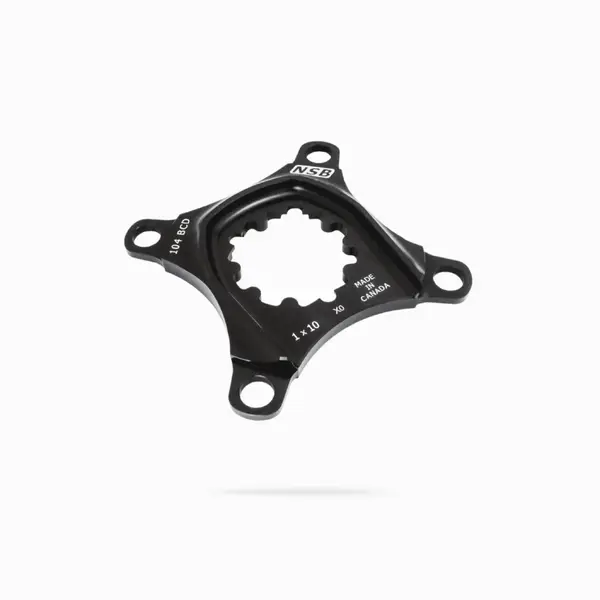

I might get a new 104mm spider from North Shore Billet. Expensive though.
Either than or 94mm chainring.

This has been ordered.
Reasonably expensive for what it is, but such is life.
I might just hang on to the 94mm spider in case I want to downsize the front chainring one day.

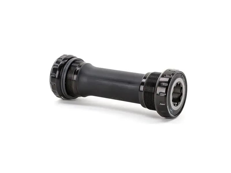

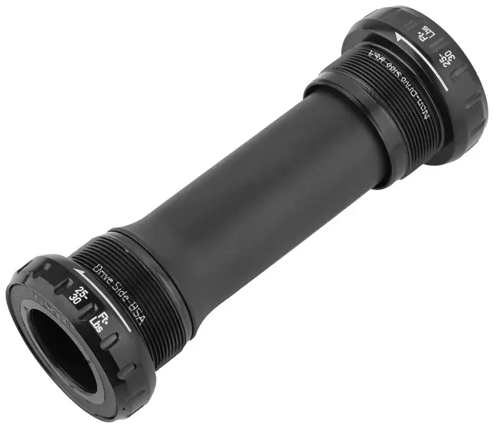

Just some cheapy SRAM/truvativ GXP cups (only £25).
Was not able to find a black version in 83mm width, only silver.
So went with a black 100mm fat version instead.
Seeing as the BB shell does not seem to have any open entry points, I will forgo the centre sleeve, bugger it.🤪
Well it won't fit anyway. Of course, that was the plan.

Well, it appears I ballsed up.😳
I took off the existing crankset + BB. Nothing untoward.
Then as I was inspecting/cleaning the old BB in order to photograph and sell,
I noticed that it looked shorter than I expected. Or rather, normal size.🤔
Then reading "73mm" on the shell (centre sleeve) I was like "funny, shouldn't that read 83mm?"
Dashed over to measure the shell width and it is indeed 73mm not 83mm.
I could have sworn it was 83mm.😟
Lesson learned kids, don't trust your memory to these things.
I thought I could remember all the sizes of all the bits on all my bikes. Apparently not.
Oh well.
I might be able to put some spacers on either side (or something).😐
