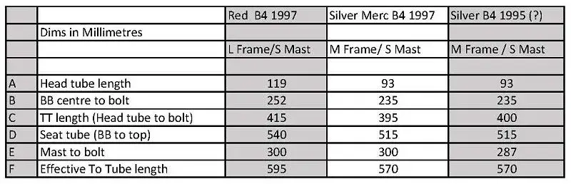

Here is how I have measured my 3 B4s ( :facepalm: ):
Here are the dimensions (millimetres):

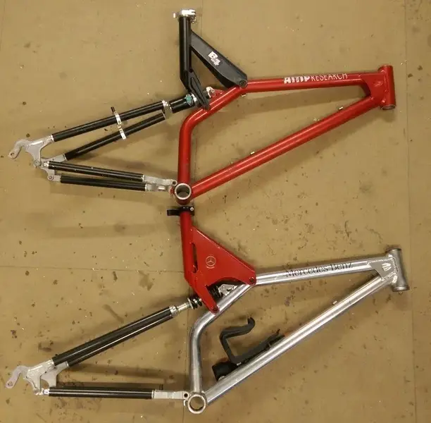

You can see that the head tube length is quite different between the 2 front end sizes which I have:

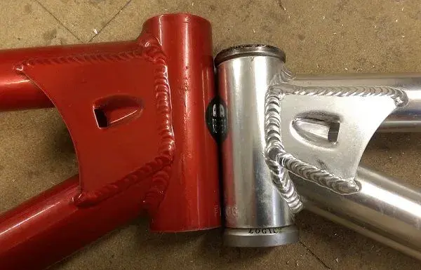

The Small front end seems to have the same 93mm head tube as the Medium, but has a shorter B measurement, the McPherson strut and the top tine are almost in line (not mine):

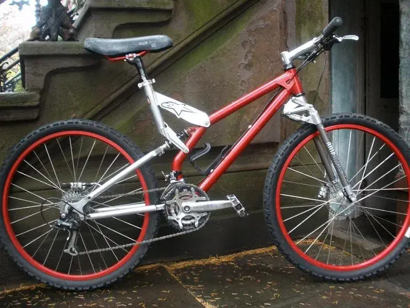

There are a few B4s around with distinctly longer seat masts...presumably the large option:

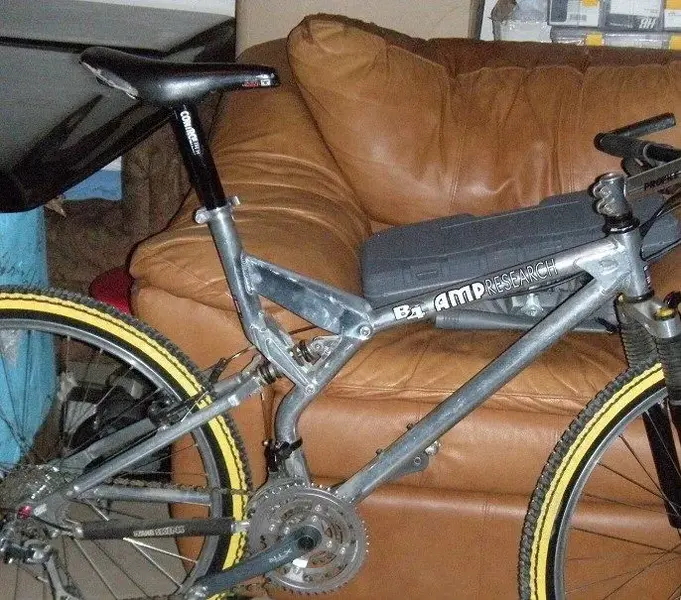

My two later ones

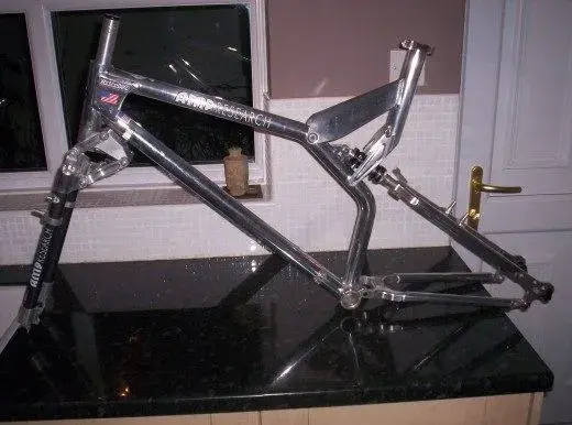

And my earlier B4:
