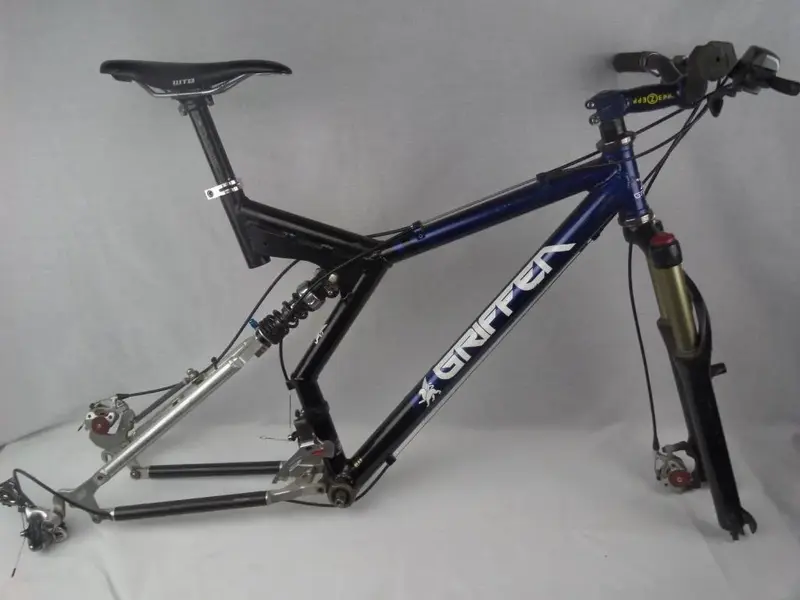

What do we know about Griffen? Came across this on eBay today but I haven't been able to find much about them.
