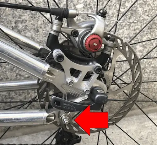

Ok! The price for full kit is $42 for front and rear brackets, spacers, bolts/hardware and rear swing arm bolt kit (everything in previously posted pics). This is for 30 full sets. I’m ordering more so everyone gets a better price (and to have some around for late comers) :)
*** Shipping to wherever you are is extra. ***
PM me to arrange and indicate WHICH BELOW OPTION YOU WANT AND HOW MANY.
OPTIONS:
1. Full kit described above = $42
2. Front + rear kits without the swing arm kit = $37...that tiny bushing is hard for the machinist to make.
3. Front kit only = $25
4. Rear kit only (with swing arm kit) = $30
5. Rear kit only (without swing arm kit) = $25
Turn around time is ~1 week from my order + transit time. I can’t place the order until I have at least 15 units covered.
Email with questions and PM me with your orders. I’ll maintain general co tact and updates on this thread. Thanks all!

PandaCLUB":2ggkgwjs said:
great. PM coming your way for payment details. Can you clarify what the swing arm kit is?
Swing arm kit is a special bushing +panhead bolt + lock nut + washers.
This replaces the non-drive side seatstay-to-chainstay frame pivot bolt. The original bolt sits recessed into frame and the nut is on the inside of the stay. The nut (at least on my frame) contacted the 160mm brake rotor. To make it work, I removed the bolt and installed a pan head allen bolt in the opposite orientation (insert from inner stay). The bushing fits into the recessed part of the frame where the original bolt head was (to fill the space). Washers and lock nut go on outside of frame. This gave me clearance to run rotors.
You may not need it if A. your frame is different or B. you plan to run rear rotor smaller than 160mm.
Thanks!
