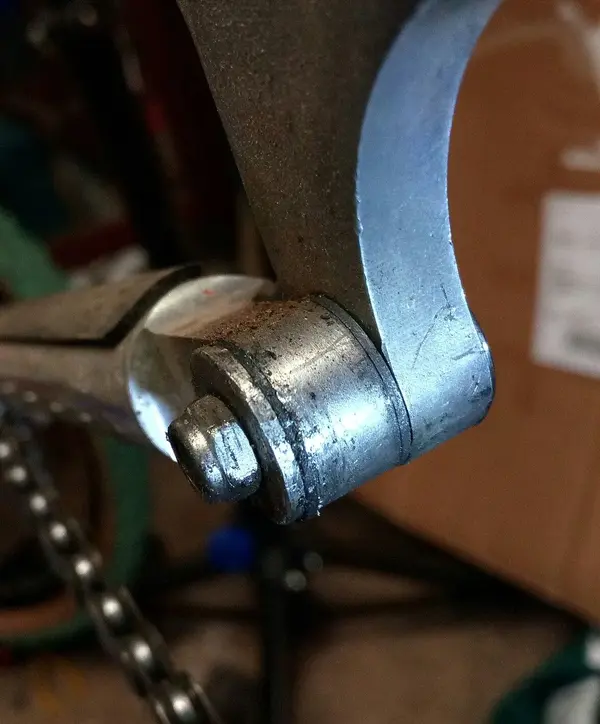

Pictures of what I was trying to describe above.
First is the nut and bolt arrangement as is from the factory.
Second the way I re-jigged it to allow for clearance. 4mm thick washer with counter sunk SS allen head bolt.

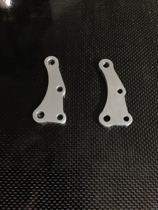

Here is a pic of the prototype brackets. Don't have them in hand yet, but hope to test fit early next week. I'm planning to swap calipers and 160mm front and rear rotors on. Still need to figure out what length M5 bolts needed to mount to frame.

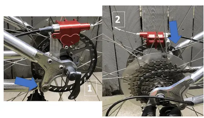

I had not thought of rotor clearance issues...argh. Here is what my bike is (pressed rear triangle). Pic #1 shows pivot bolt...not sure what inner nut looks like yet. Pic #2 shows the notched frame where the rotor may have clearance issues. 160mm may be tight, hope it works or this will only be a solution for the fork.
I'll post if it works with pics.

Look good. I fear 160mm might catch in two places.
1. the nut on the rear of the frame though this is workable as per my solution.
2. The rotor on mine with a 160 caught/rubbed against the frame where the round part of the drop out presses into the chain stay. This, without grinding part of the chain stay which would weaken the joint/frame, I couldn't see a work around other than 140mm.
Fingers crossed yours is diFferent.
Where you might succeed if the 160mm catches is to use a Hope Mini #5 which is for 140mm rear rotor on IS mount. This might be a work around without a complete redesign.
