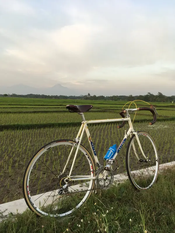

Nicely finished and that is a great photo!
I think that you are the first Alimo (current) owner that has posted since I started this thread, it looks like yours is in good condition.
It's nice to see Alimos outside Europe, I wonder how many were sold in Asia.
thank you for that, as far as I know there is only one in Indonesia..don't know on the continent of Asia

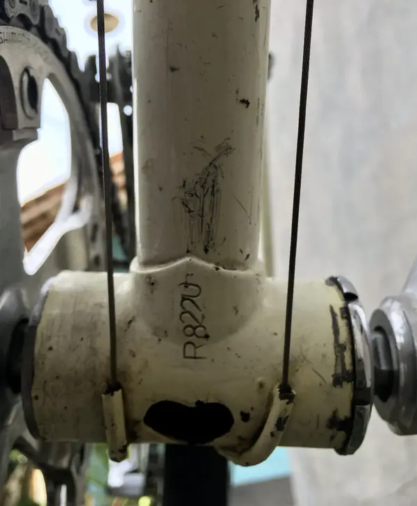

I'm collecting parts to do a renovation and just had a look at what is on the bike already:
The only Shimano 600 part fitted is the crankset. I'm not sure what was fitted originally but there is a Suntour VX rear derailleur fitted now.
The Gear levers are original and are Shimano Altus LT, so is the front derailleur which is mostly constructed in pressed steel.
The brakes are Shimano Tourney with the clamping parts on the right side.
The headset is Tange Seiki and looks like chromed steel.
The original pedals were swapped recently for some Wellgo SPD clipless pedals but will replace the originals which I hope are SR.
